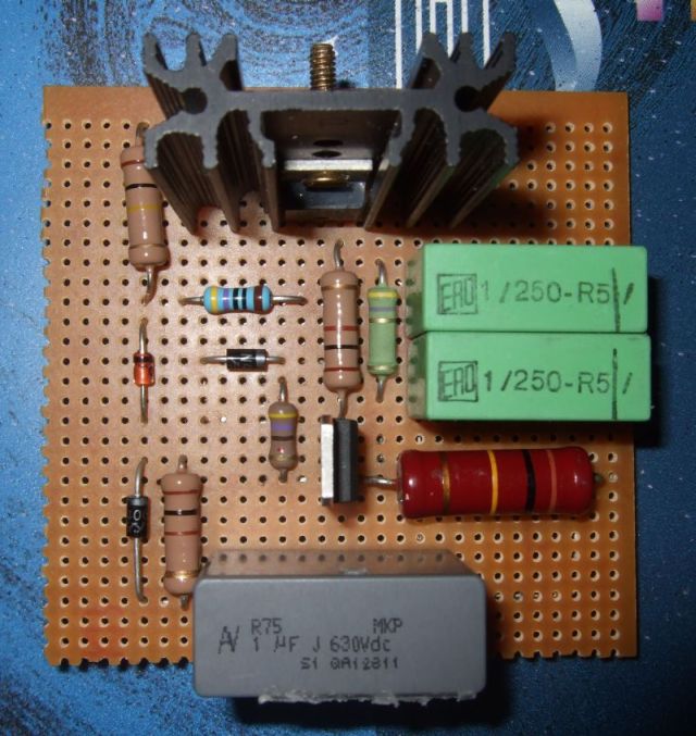

I've noticed that my Maida regulators drift with temperature -- LB47 has a compensated circuit using the LM329 -- here's how to implement -- first the schematic:
Here's a single layer version free for the pickin'

PM me your email address. I changed the voltage setting resistor to consist of 2 units -- it's less expensive to use a pair of 3W devices and spread the heat.

The Value of C1 should be 1uF, not 100F -- this is a recurrent problem with Multisim -- but when I translated Multisim to Ultiboard I changed the value to 100nF -- should be 1uF -- thank for pointing out the error. A 1uF pp also has a bigger footprint.
The pass transistors which Maida used are now unobtanium. The TIP50's are rated 500V and are more than sufficient for the task.

Jack, have you run these boards yet?
I cannot seem to find any 1uF PP that will fit. For example, Wima MKP4 has a 1uF/630V that has a LS of 27.5mm. Even if you switch to polyester, MKS 4 in the same voltage rating, 27.5mm is the best you can do.
Also, on the 5W R6, can you slightly enlarge that footprint, to either fit a 24mm body resistor (for example, Kiwame 5W) or preferably the 12W Mills MRA12 non-inductive, which body measures 1.188" +/- 0.062" in length by 0.312" +/- 0.031" in diameter. The leads measure 1.500" in length minimum by 0.040" in diameter.
I think you'll have to make the board a bit larger to accommodate these larger devices.
luvdunhill said:Also, on the 5W R6
oops, I see you've changed this to be two resistors. 🙂
very creative! Can you accommodate a tiny bit more width for the two caps, perhaps 13mm? You could move up R1, D2, etc. and I think you will have enough room. Other than me being a symmetry freak, I think this one's ready to try out 🙂
The Panasonic 1uF/630VDC caps are 10.5mm wide, the Wima's from the data sheet appear to be 13.0
excellent! Also, you may want to change the silk to say LM317HVT, as I think LM117HVH is an obsoleted part number.

Just burn the top-side and hard-wire the bottom.
I purposefully put the radial component connections on the bottom copper so that they could be hard-wired. With the new CNC PCB Mill I will have to figure out how to plate through-holes, but in the absence of such knowledge radial components will be connected this way.

The one issue to be aware of is that the WIMA's will effectively block (or make tricky) access to the screw holes which attach the pass transistors and LM137 to a heat sink. The pass transistors are going to dissipate 3 watts or so -- thus they need to be heat sinked.
