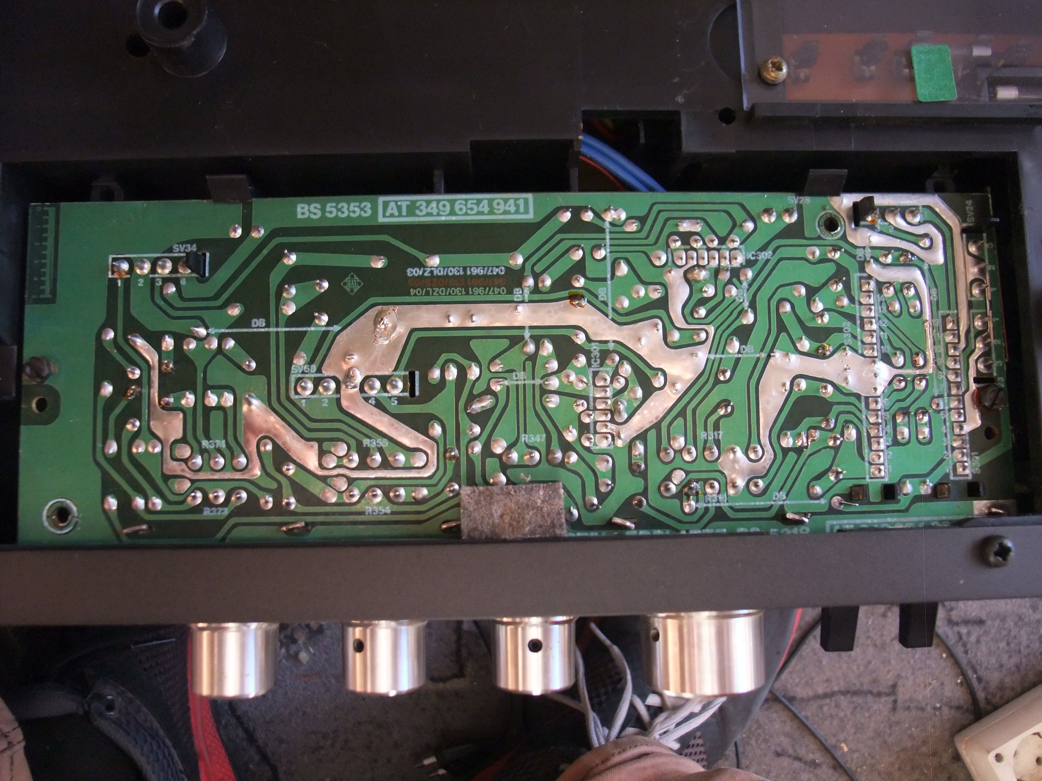

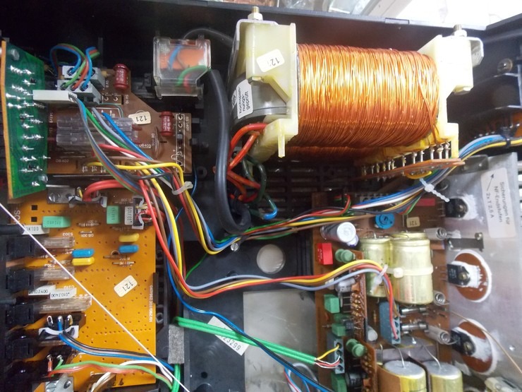

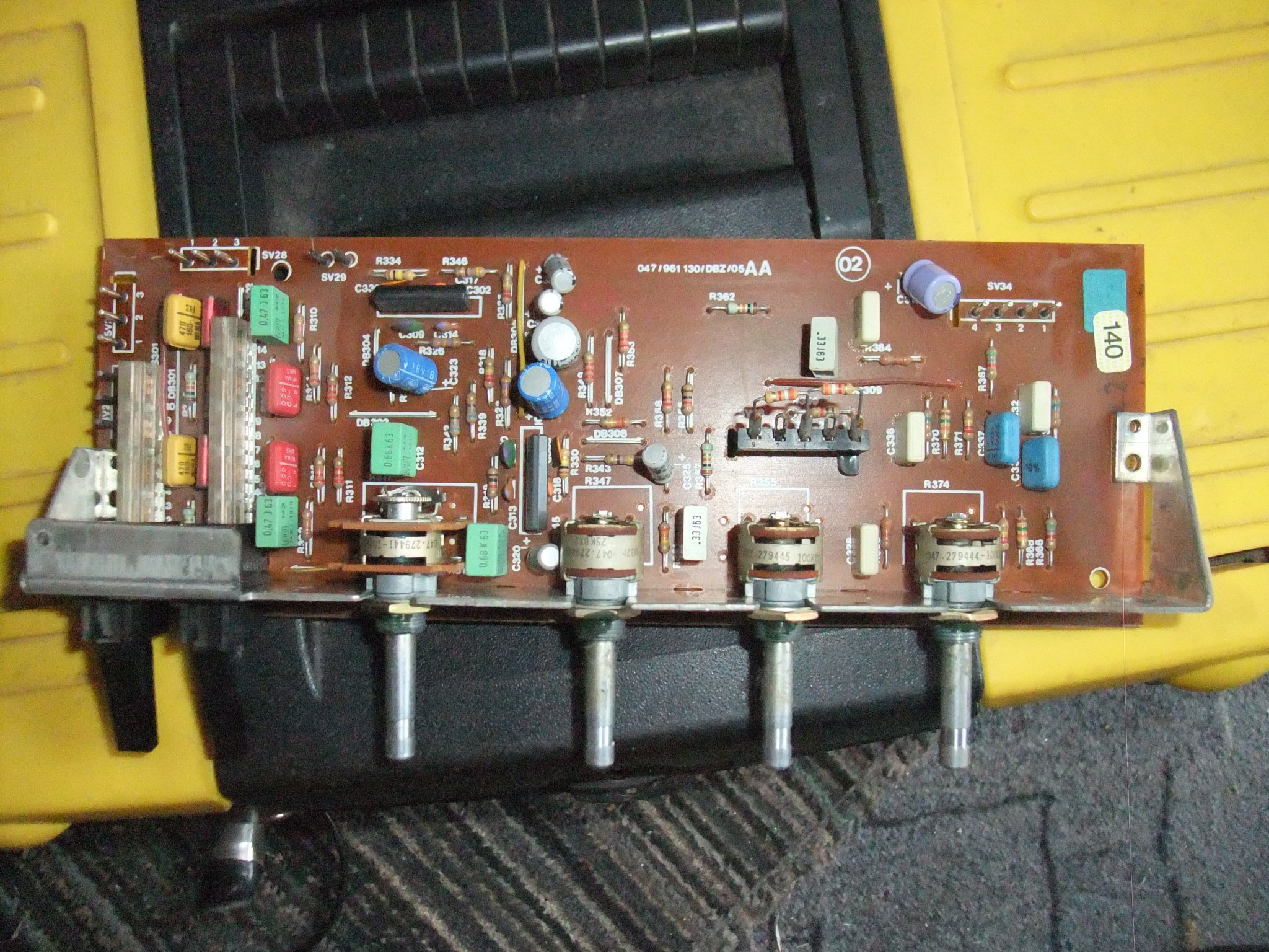

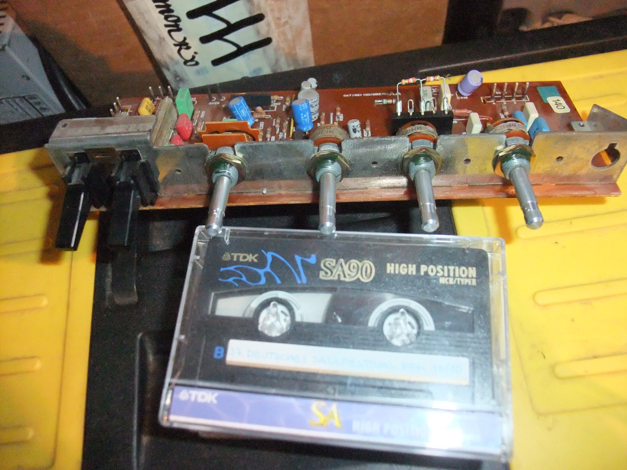

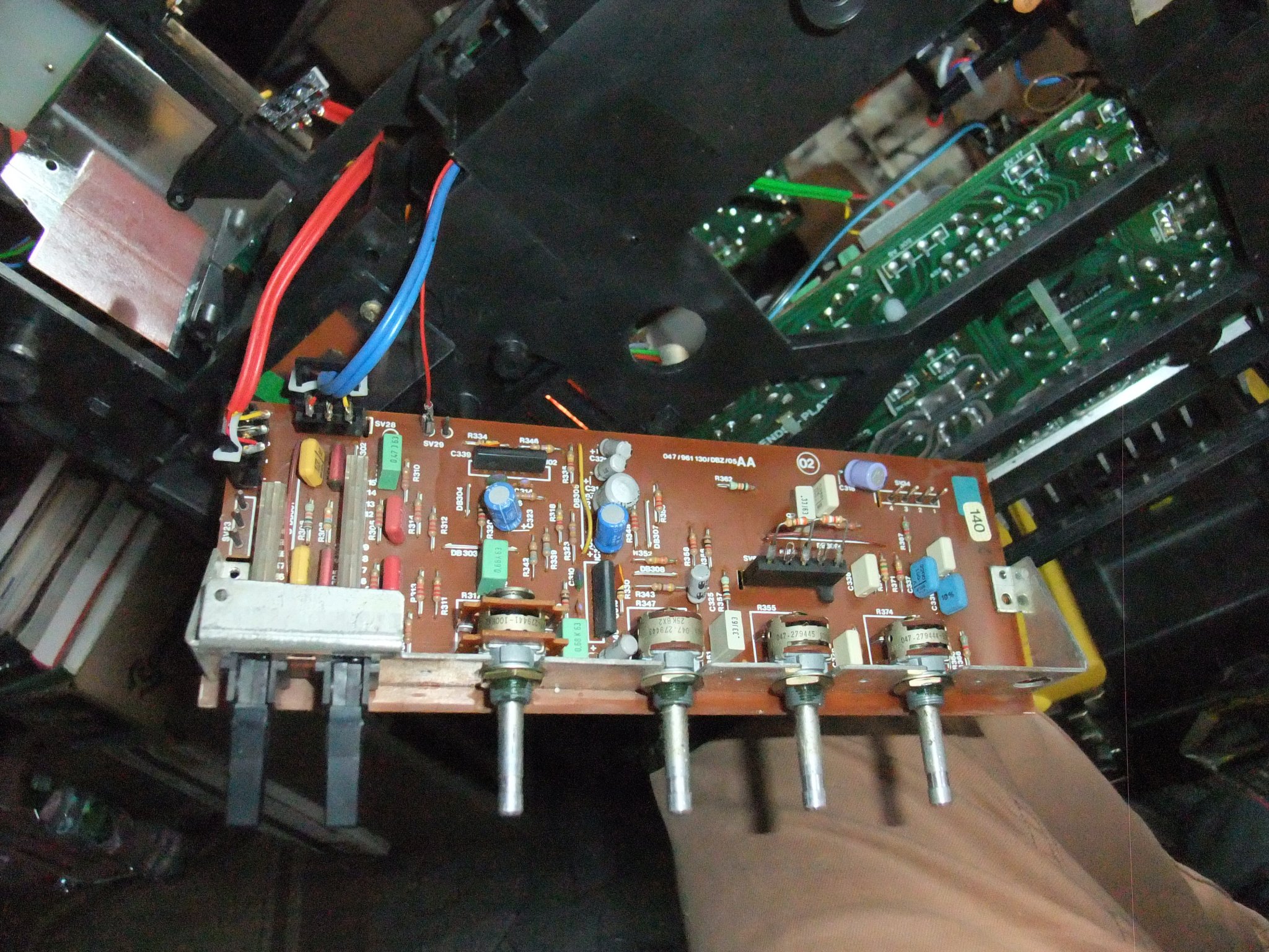

Telefunken TR350 TR-350 FM Stereo Tuner + Integrated Amplifier Strip down + Repair
Outside image of this device are here:
https://www.audiovintage.fr/leforum/viewtopic.php?t=59293

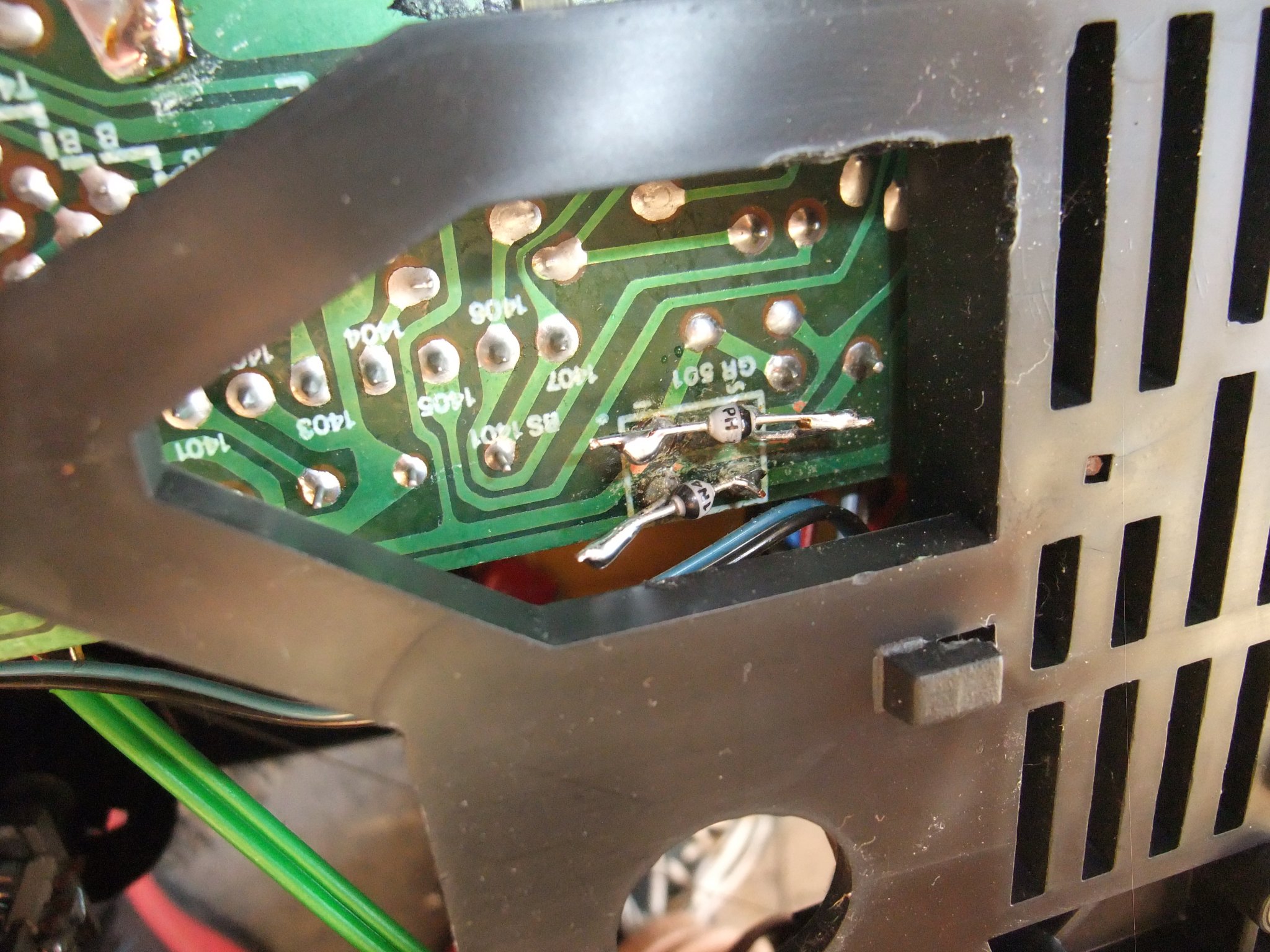

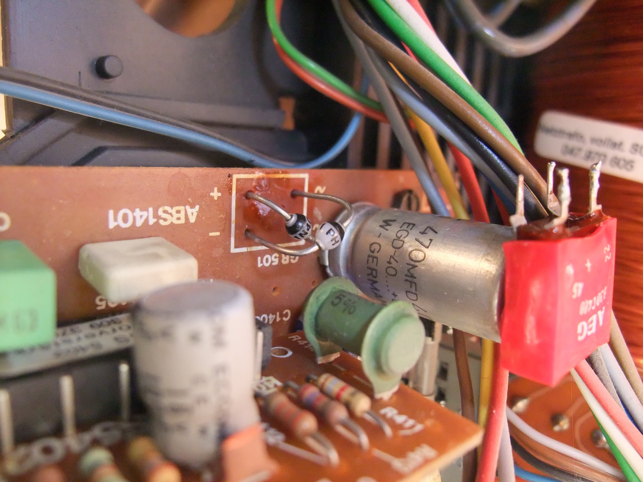

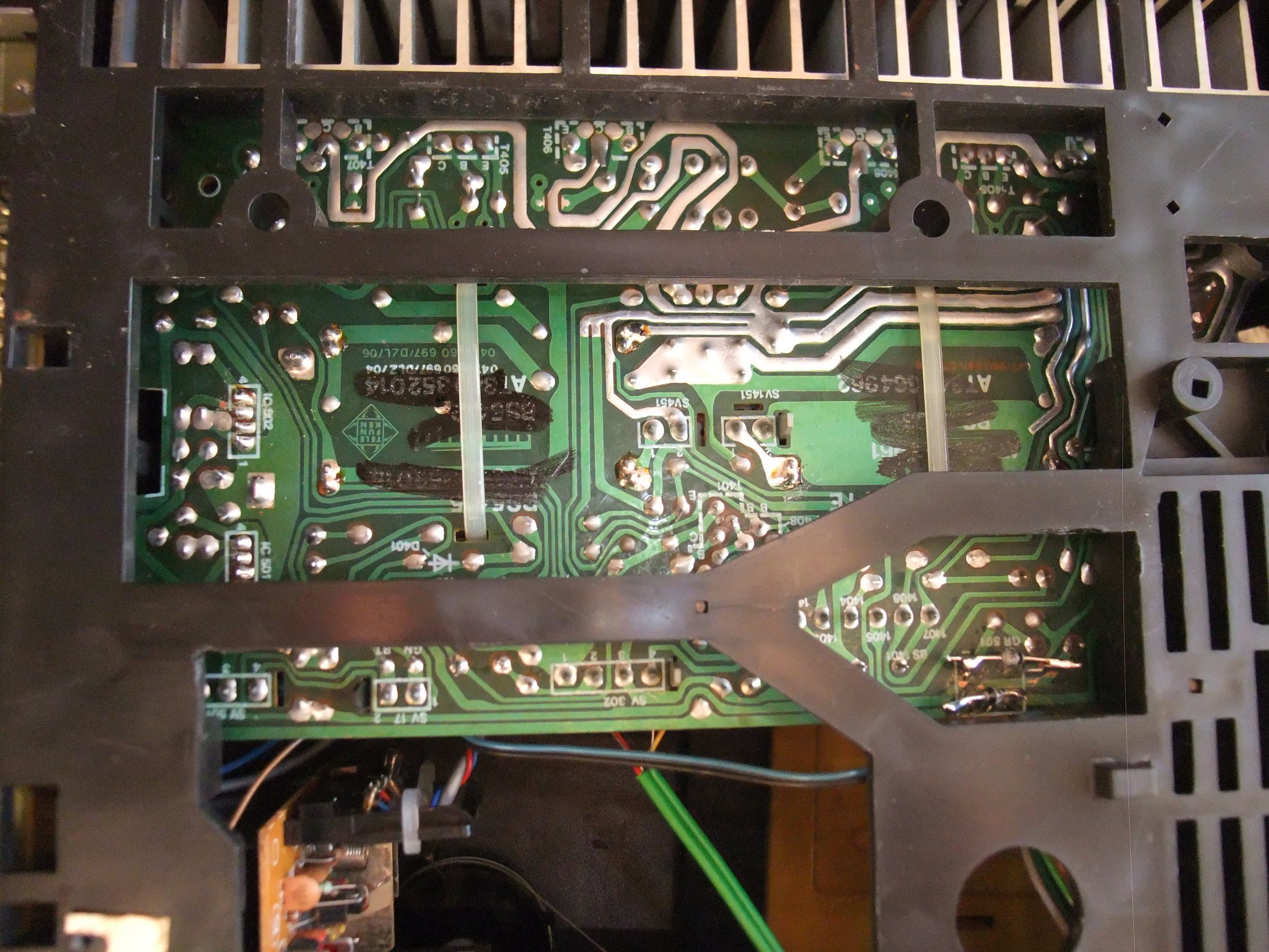

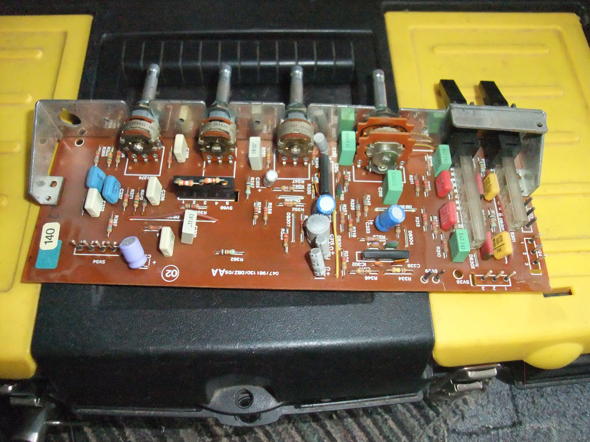

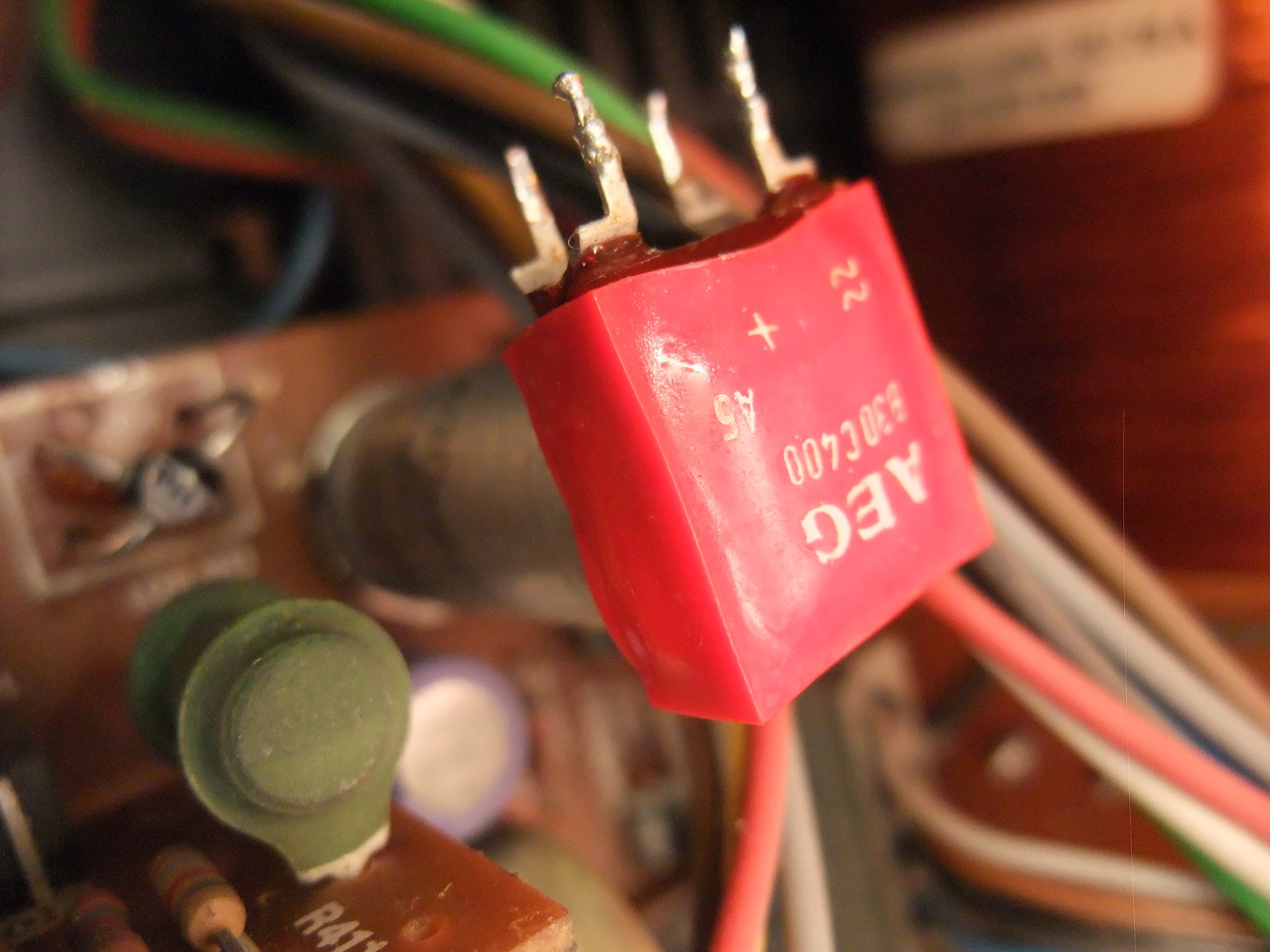

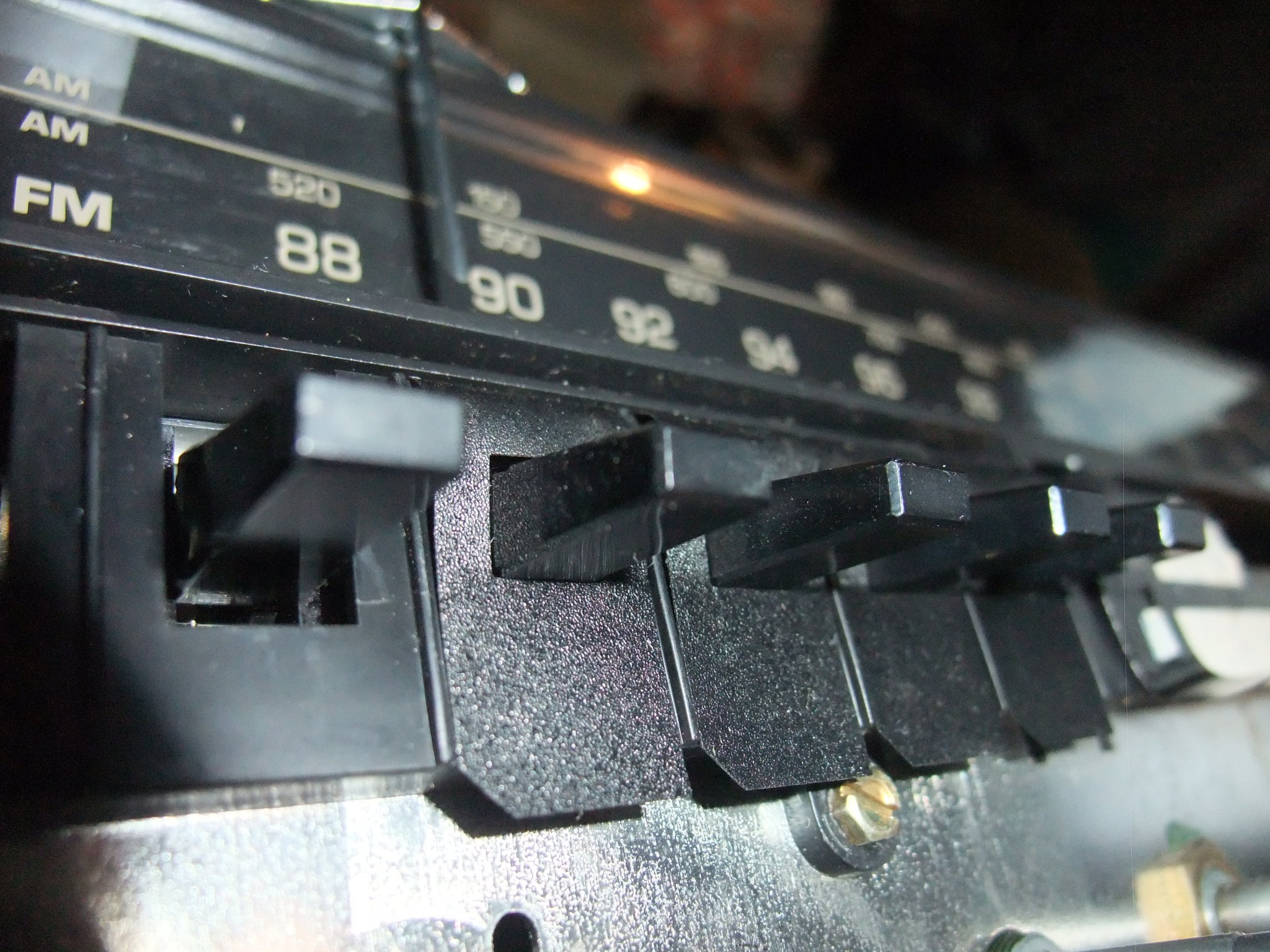

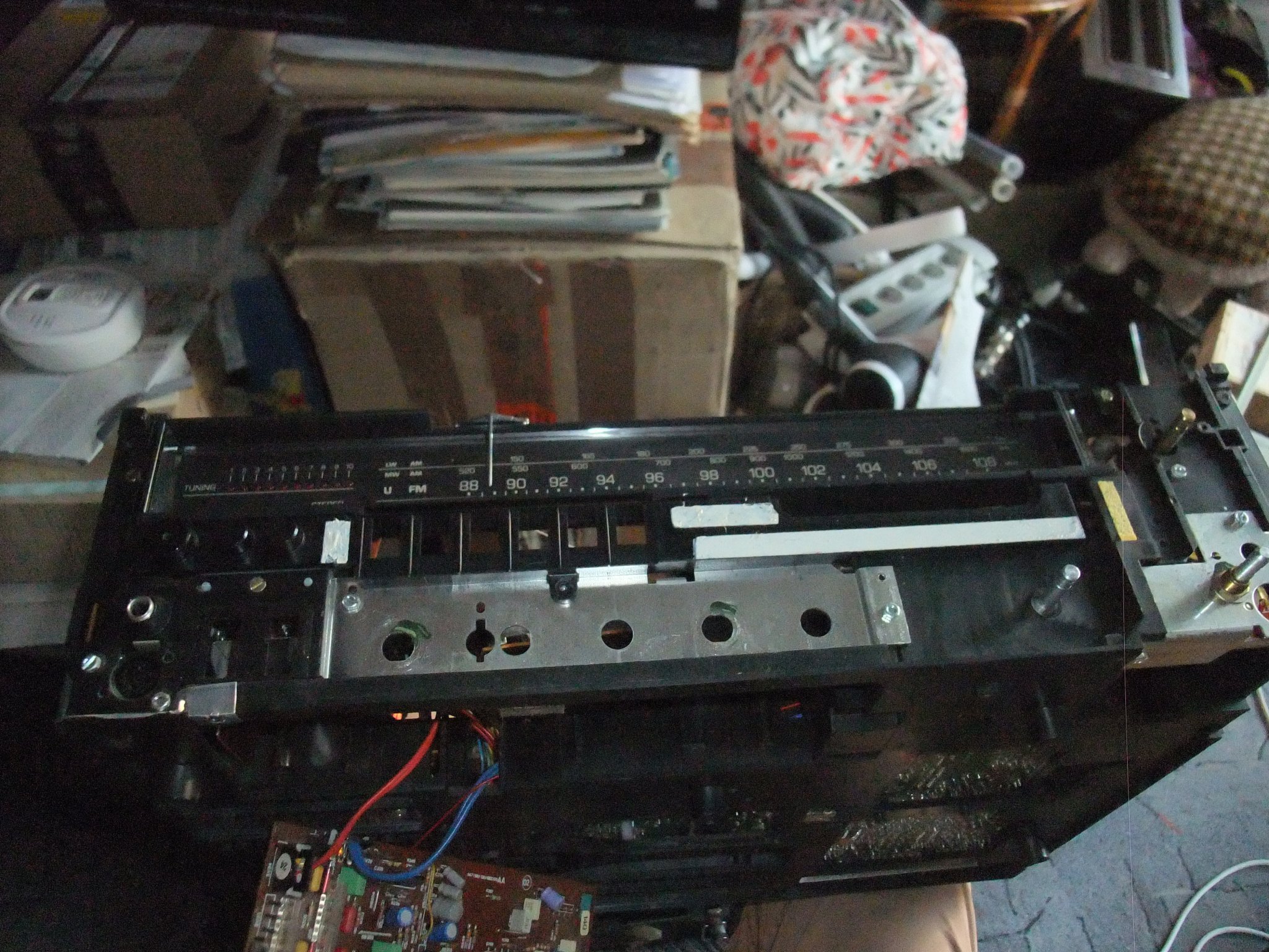

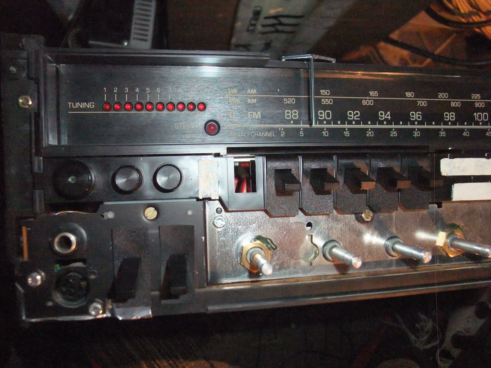

Replacing of the red AEG rectifier by single diodes is an easy task - most effort is the elimination of all contact resistances on the pots and switches so as the melting of numerous solder joints.
I am surprised by the good sound character and the reliability despite the age (no hot spots on PCB like to observe on various very expensive Mark Levinson amplifier devices) - thus highly recommended for used purchases.

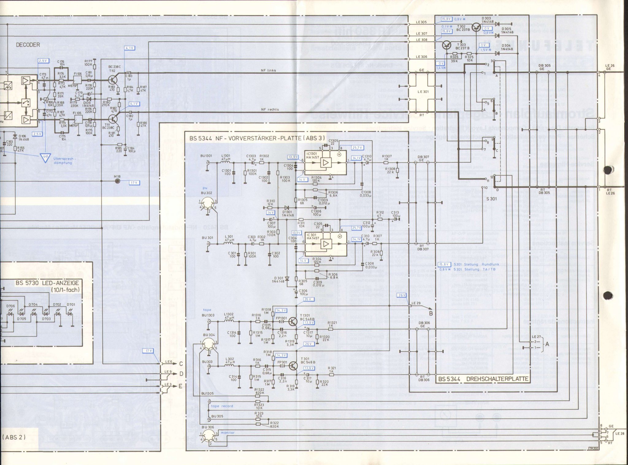

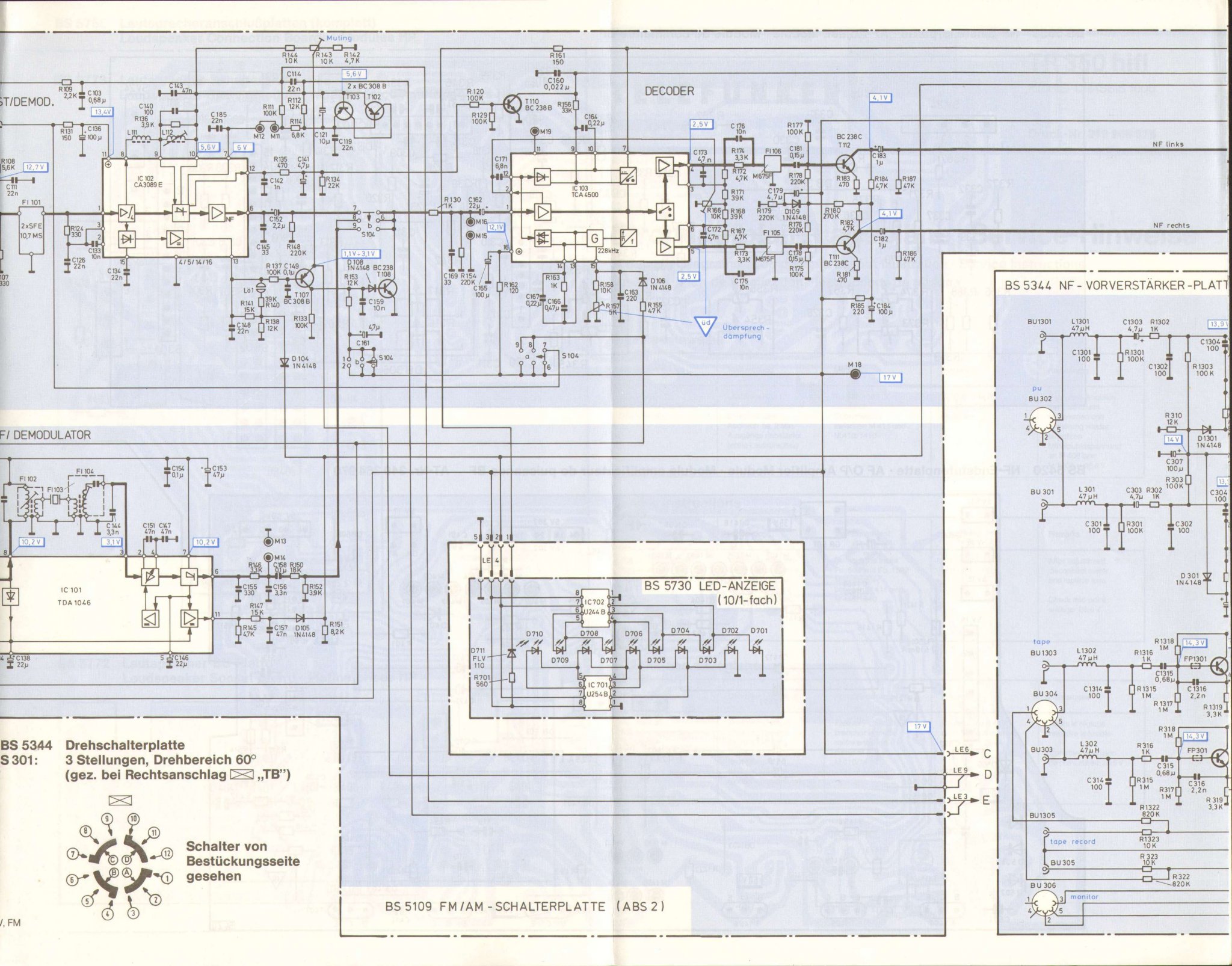

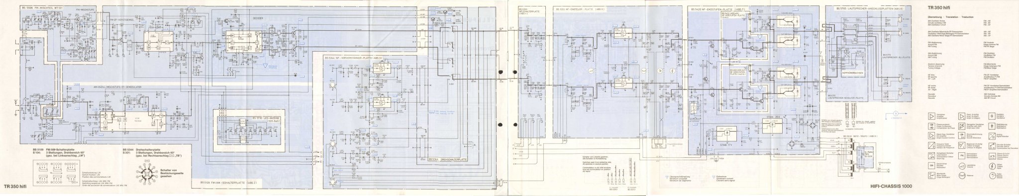

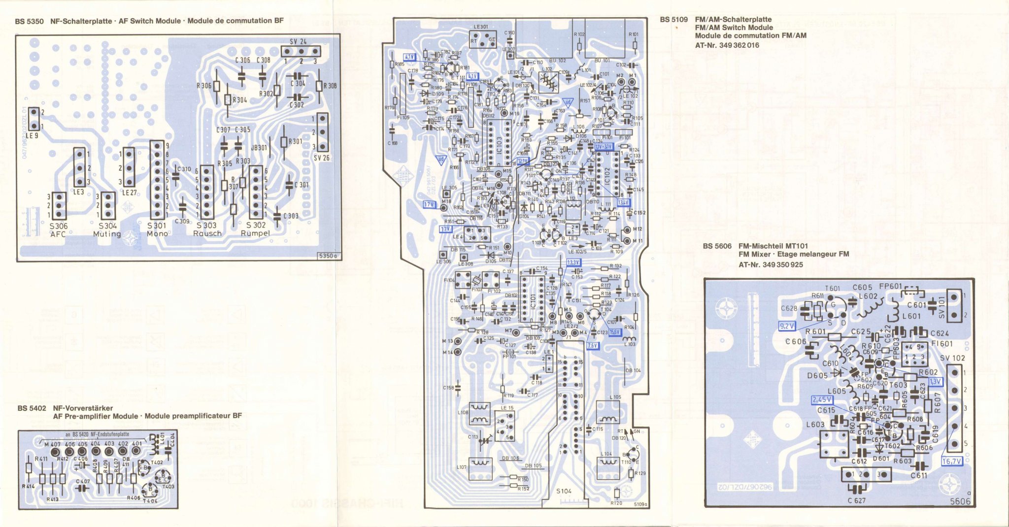

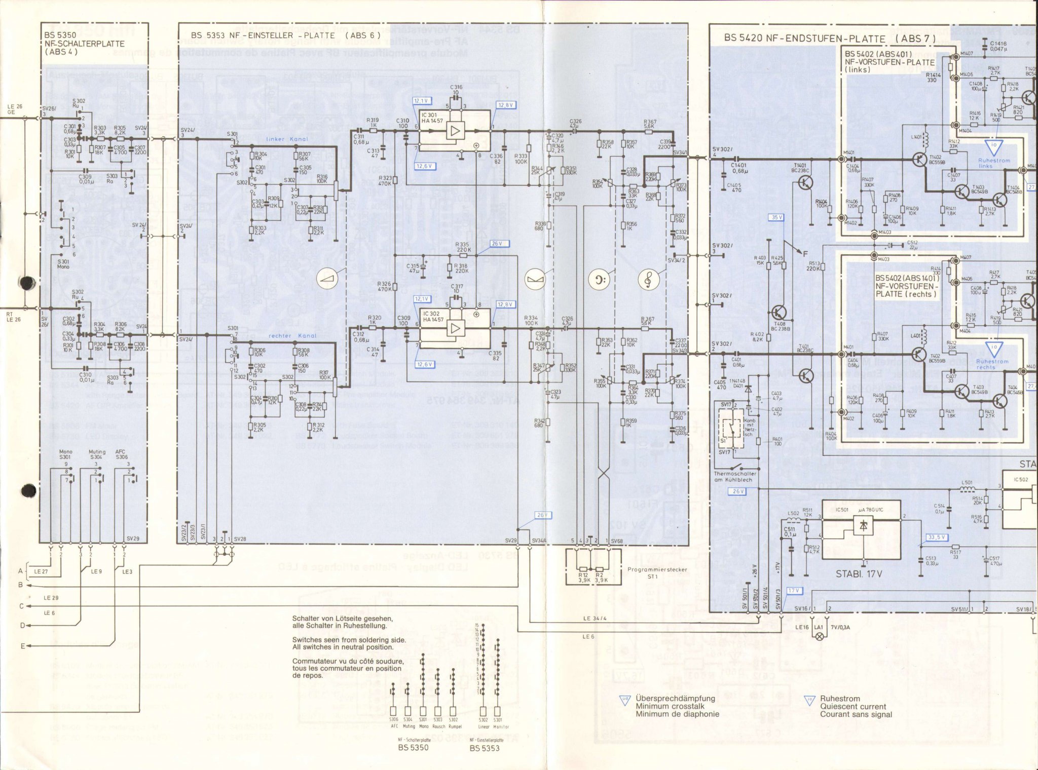

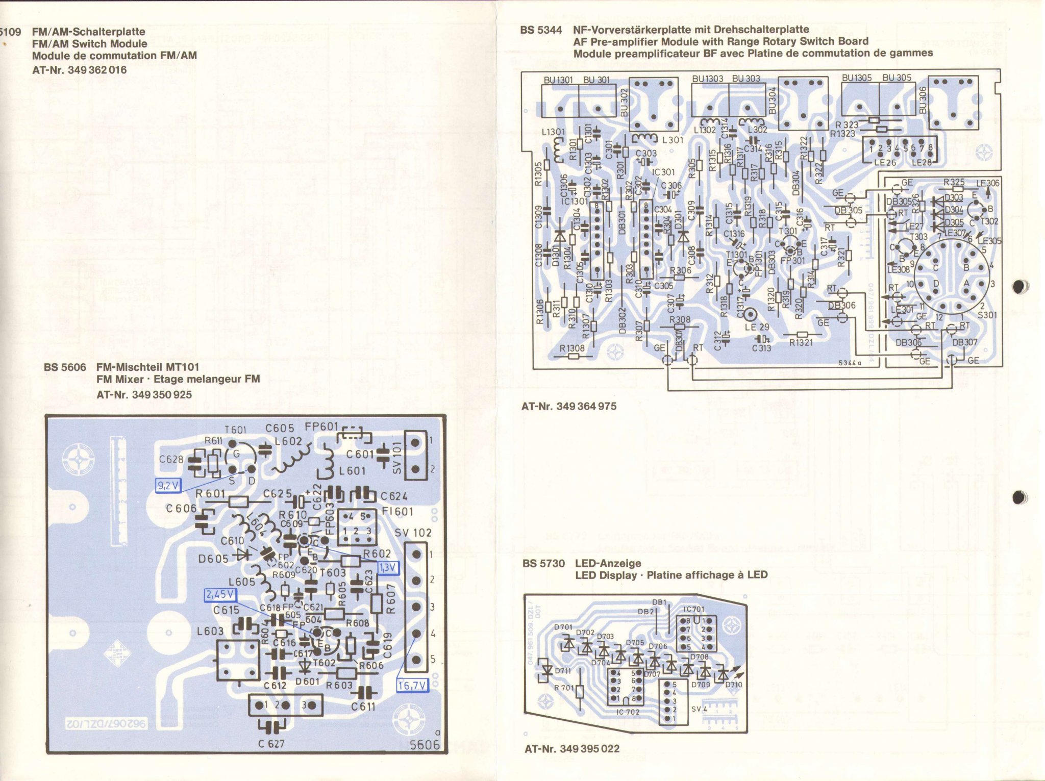

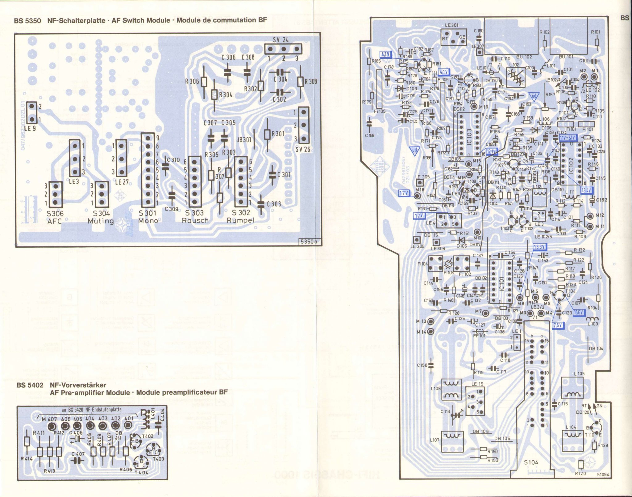

schematics - unfortunately only as jpg file
