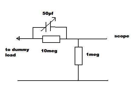

I need to make some BNC test cables for this scope. The question I have is this.........
Do all of the connections and cables need to be 50 ohm impedence or will the canare 75 ohm stuff I already have work?
Cheers
Cheers
obviously they need to be BNC, but the input impedance of the scope is 1 MEG. so it doesn't really matter what you use for cables, etc.... one thing i learned is that if you connect to a dummy load and attempt to make your own 10:1 attenuator, it sould be a 1 meg resistor across the scope input, and a 10 meg resistor between the input hot and the dummy load hot. you should also have a 50pf trimmer cap across the 10 meg so you can adjust the frequency compensation. otherwise when an amp clips you will not see flat-topped waves, but the tops will be at an angle.
thought of this a bit later...
you can use just about anything for cables, but to keep proper compensation, they should be low capacitance cables.
