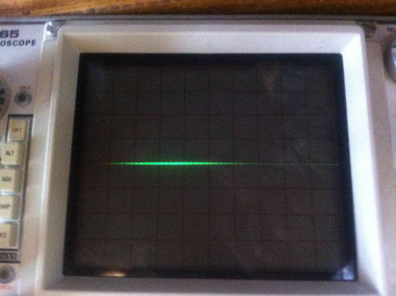

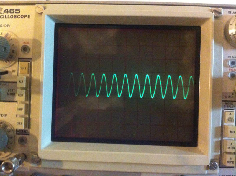

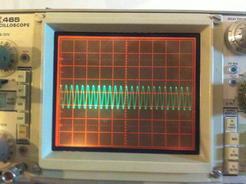

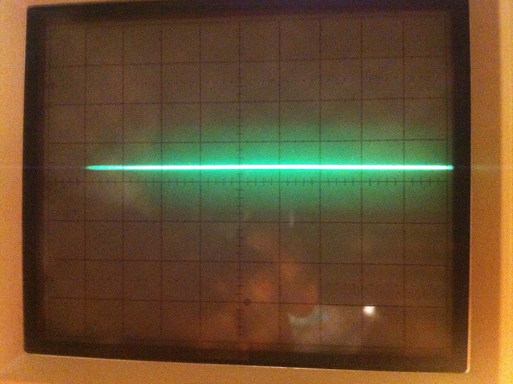

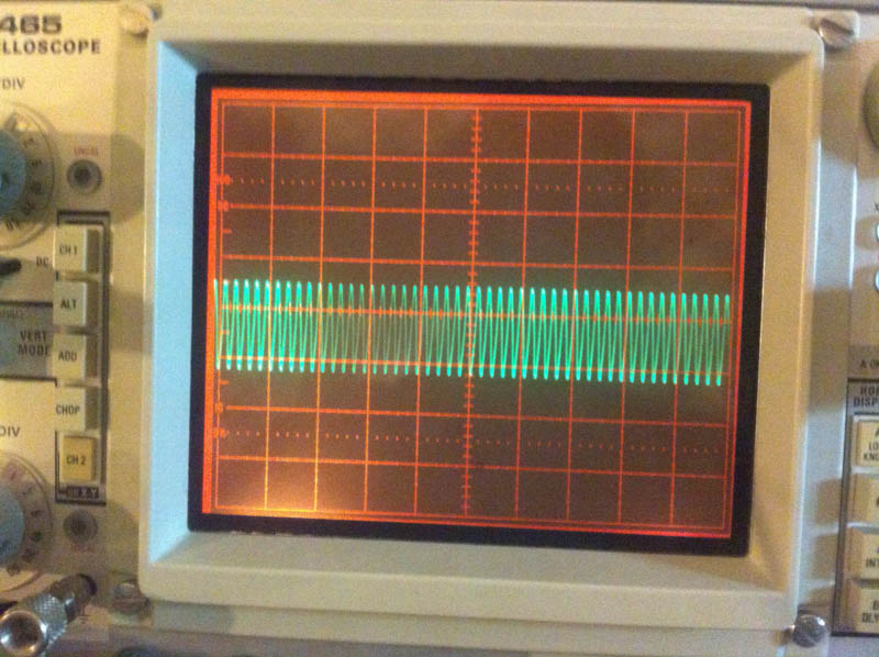

After everything was done I still noticed that I haven't fixed two annoying issues. One is that the horizontal line (while GND coupled) extends to the right outside the area of display and there's nothing that can be done to adjust that (besides messing with X1 gain 😀) That's kind of bad as I like my signal to end at the last vertical line on the display. Anyway, I could live with that but the next problem I faced is even worse:

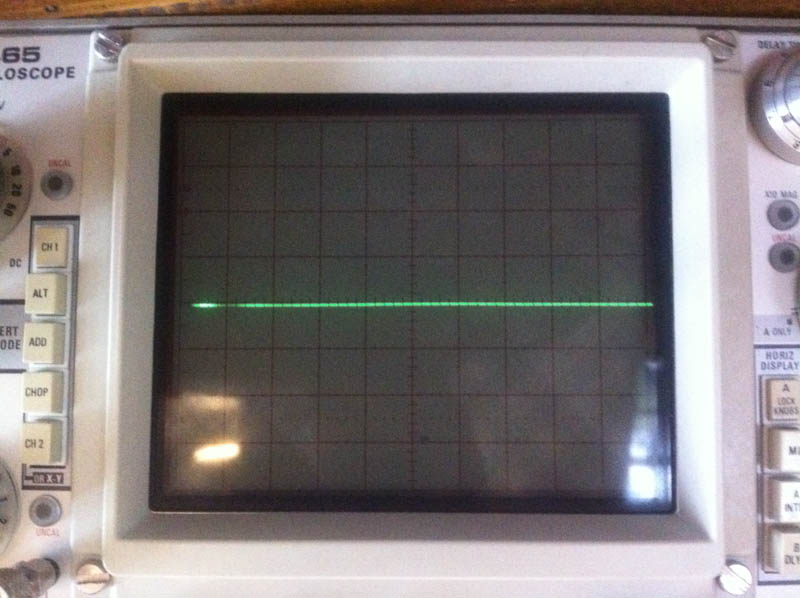

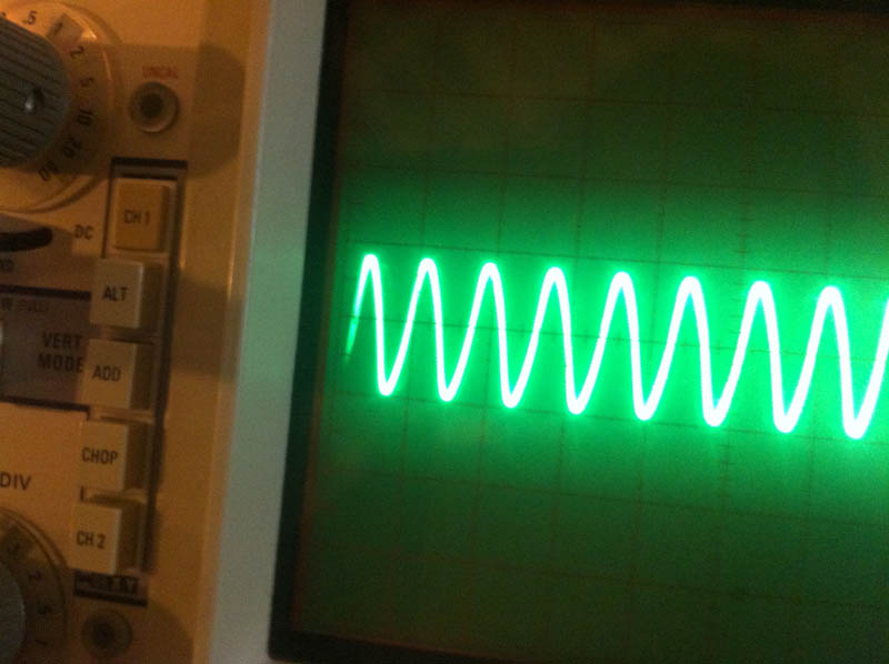

Starting from about 5uS to 0.005uS sweep speeds the horizontal line starts to shrink from both sides, and on the left side I get a kind of faded out signal/line (depending on the coupling state). It doesn't end sharply as it does on slower sweeps. The problem is that I don't know where the trace starts. If I crank the CRT I get more dim signal on the left side but the rest of the signal is so bright that it annoys me.
Now I have checked the manual and in the calibration procedure there's this variable capacitor that is meant exactly for this kind of adjustment but the trouble is that the result is minimal, about one microdivision extension. I started checking all of the transistors in the Z-axis amplifier area and they were all good, as in not shorted at least. I replaced Q1466 with a BC549 and Q1472 with a BC556 that I had and that improved the trace by about one division to the left but It's still more bright in the middle and still fades out. Also I cut some resistor's leads so I can test them and most of them do check out. The variable capacitor I could not test as it's 1.5pF but it seems to be doing something in the extremes, and while I touch it with my finger (I guess there's enough capacitance there to make a change).

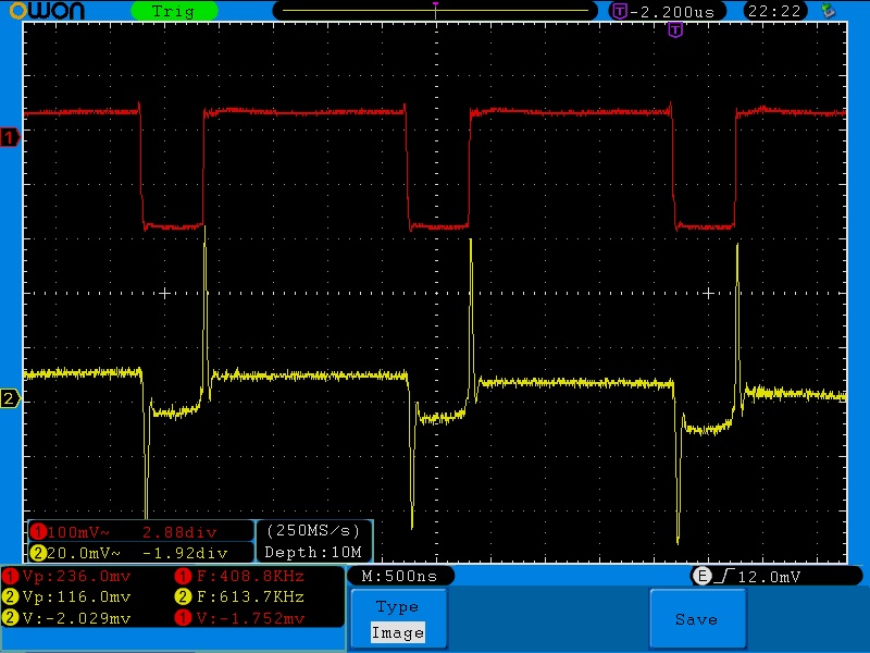

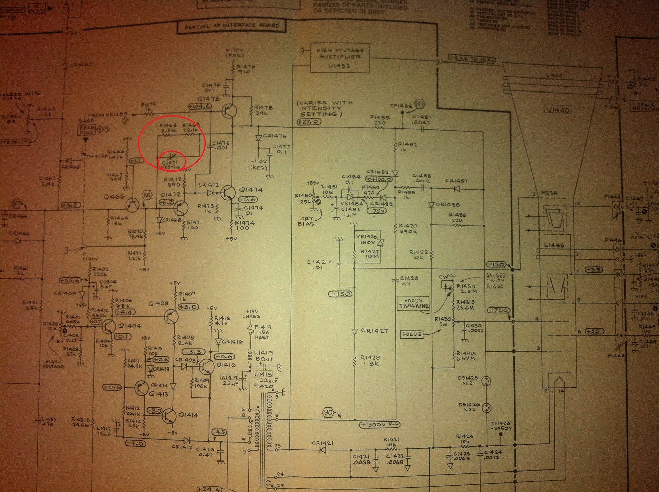

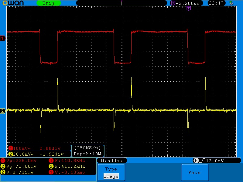

The unblanking signal comes on the emitter of Q1466. That's the red signal in some photos. Refer to the file name for more info on picture.

I played around with 3 higher signal sources that I had around and I used for calibration. A tcxo 4mhz square wave, 16mhz sine from Arduino crystal and 24mhz sine from a junk board crystal. The amplitude and frequency are consistent with the digital scope after calibration, so the problem is somewhere in the unblanking circuit I presume. The problem is that mhz signals look bad on display, I can only use the center part from CRT. The freq/amplitude are ok and the trace is sharp and in focus but it's brightness varies across the display and may cause some issues with modulated signals and such.
In the audio range everything seems fine, but still have the extension out on the right side of the display. Maybe I get lucky and both these issues are related somehow.

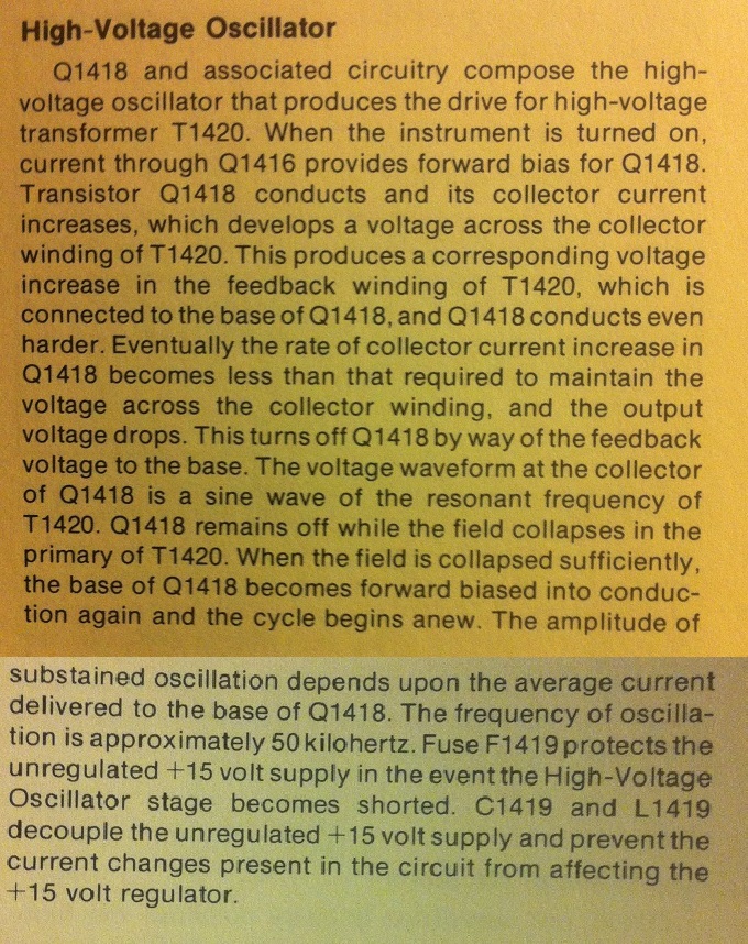

I was looking at signals with digital oscilloscope set on Averaging so I missed the important stuff. On Sample I can see at TP1486 and at Q1466 collector another signal that's piggy-backing on the main unblanking pulse. It's 50khz and it screwing up the signal on faster pulses. Didn't see that on averaging 😱 Live and learn right?
Now I've seen the HV oscillator description and indeed it oscillates at 50khz :mischiev:
Now we're getting somewhere, no more shooting in the dark.

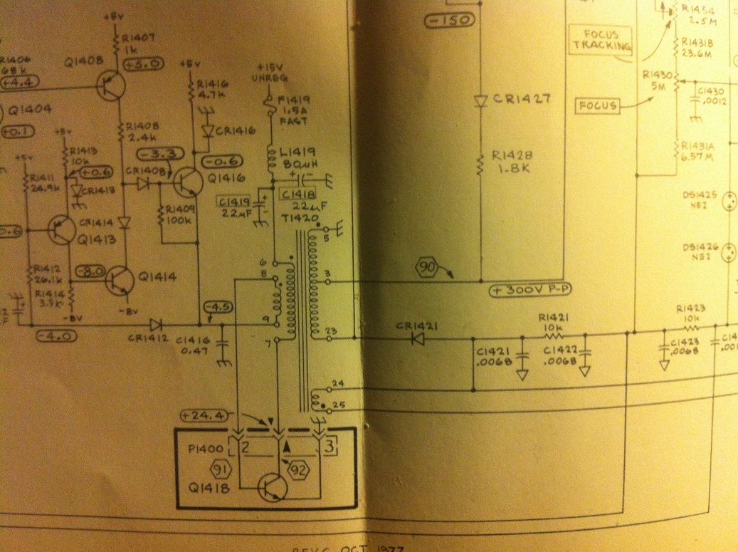

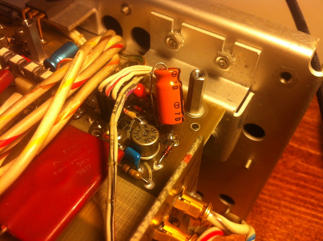

Test point 90 on the schematic shows 316Vpp and I've also measured the + of the C1418/C1419 and it seems that I get about 23V unregulated AND the 50khz signal. On the F1419 fuse I only get the 22V unregulated without the 50khz signal which is kind of ok considering that the schematic shows +15V unregulated.
I also tested C1488 and C1487 and C1420 and they seem ok (tested with LC meter, capacitance in pF range are out of ESR meter possibility and DMM on capacitance can do only out of circuit testing).
Seems like previous owner replaced C1418/C1419 with one 47uF capacitor. I don't know if there were two of them or only a double one or two separate ones.
I added oscillator circuit, it's description and some screenshots on the cap's + lead. One with unregulated ripple and another with the 50khz signal.
Now I know what area to scout for the issue. Do share your opinions 😀

Reminds me of Z-axis modulation (intensity modulation).... look at waveform fidelity on z-axis path and ripple on cathode.
-RNM
-RNM
Are you referring to this picture? The unblanking pulse comes in Z amplifier area first in Q1466 on it's emitter then on the collector I get the same distorted waveform. And that's because on that side I have the 50khz signal that's leaking from the HV oscillator. The problem is I don't know where exactly is leaking. HV oscillator is at 50khz exactly like the small signal contaminating the unblanking pulse on the collector side of Q1466.

Yes, it's done!
It was Q358 transistor on the vertical preamp board.
The voltage on it's base was about +1.31V instead of +0.8V.
I have replaced that and now everything is fine. I'm still missing about a division at 0.05us sweep speed but I can live with that. Down at 0.5us I have the full trace. And the trace is evenly illuminated at all sweep speeds.
