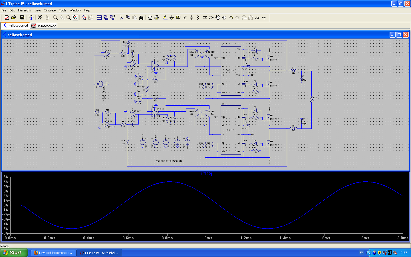

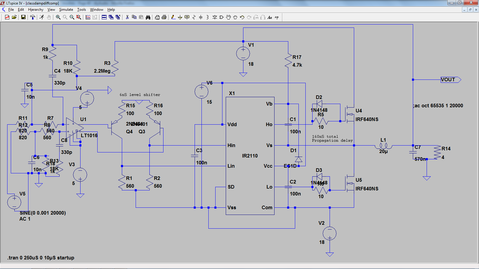

The monster has awoken yet again: http://i.imgur.com/heCHd.jpg

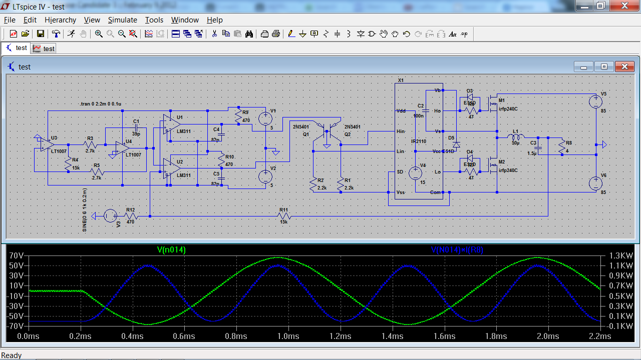

I neatened it up alittle to, its now a inverting setup with feedback from the output.
And now its happened, the amp was powered up with 2x85VDC from a 1.5kVA transformer, the load was two 4ohm speakers in series for 8 ohms.

I also did a quick power test, into a 2 ohm load, the amp peaked 1800 watts (60V peak into 2 ohms) with the 30 ohm softstart resistor still in series with the transformer primary, it was nice and hot after a few minutes while the amp heatsink was stone cold.

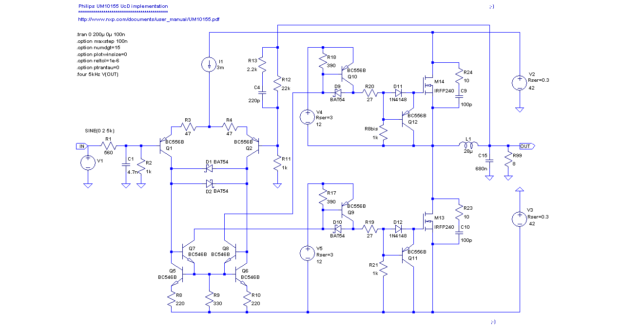

Hello, I am new in Class D, just finishing reading docs from Sony TA-N88, Tripath, Bang & Olufsen IcePower, Philips UcD, Hypex nCore, along with more stuff on www.diyaudio.com and Foros de Electrónica.The circuit is that of my thread "simple class d amplifier". This was never intended as fullrange use, but it still does a fair job.

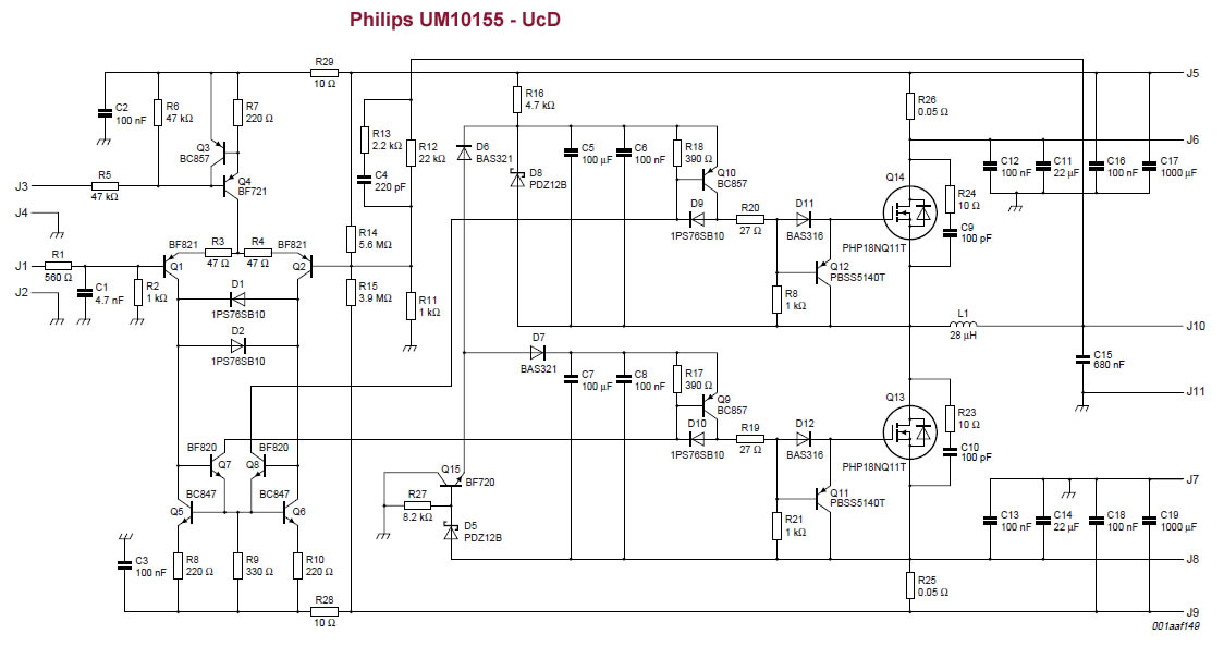

The Philips UM10155 UcD implementation is fascinating me. See attached picture. Clearly they wanted to market the baby basing on discrete components sold by Philips instead of relying on ICs possibly sold by competitors. What helped Philips, is the popular misconception that discrete components will better treat the audio signal, compared to ICs.

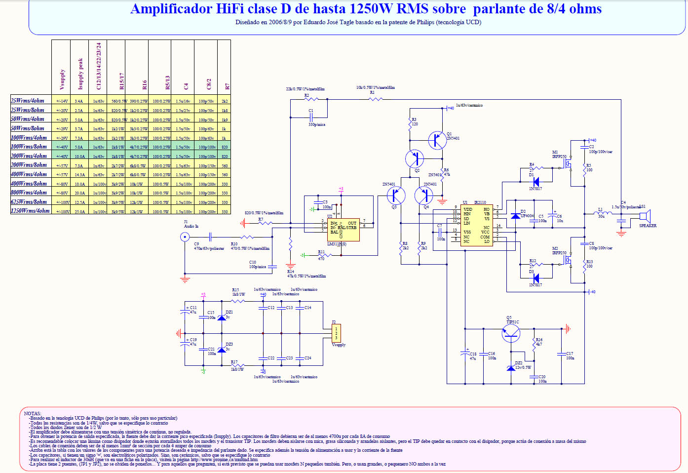

As consequence, smart people like Eduardo Tagle (ejtagle) pioneered the IC-way UcD, using a LM311 comparator and a IR2010 MOS gate driver. The resulting PCB is very compact. Are there reliable THD and IMD figures, concerning such implementation ?
Most troubles are coming from the output coil. The recommended choice is the T106-2 from micrometals.

I'm curious about the circuit that got presented here.
- Who is the author?
- The frequency gets imposed by the oscillator formed by U3 and U4. What's happening when varying R11 sitting between the filtered output and the audio input?
- What's happening when combining the fixed frequency orientation with some more elaborate feedback?
Do you consider sharing the LTspice simulation file in a .zip, along with the IC and MOS models and subcircuits? In the meantime, I have attached some bits and pieces grabbed on diyAudio, as a starting point. See the attached .zip.
Is it worth opting for a LT1016 replacing the LM311, just like you did in your improved Eduardo Tagle (ejtagle) UcD implementation? Are there reliable THD and IMD figures, concerning such implementation ?
What MOS gate driver IC are you using : IR2010 or IR2110?
I like the fixed frequency arrangement, and I am ready to pay for the added complexity of the fixed frequency implementation if synchronization can be guaranteed, say 8x Fs = 352.8 kHz. How to implement a TTL-level sync input?
Speaking about EMI and RFI, I guess that the most reliable solution is to design a single, compact PCB hosting everything, just like you did for the improved Eduardo Tagle (ejtagle) IC-way UcD implementation. See attached picture.

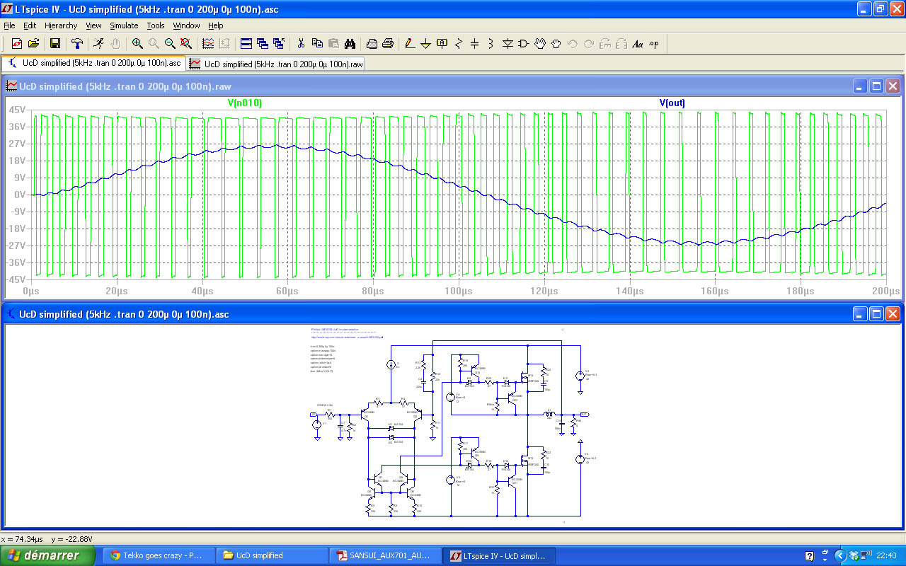

- the IC-way UCD improvements suggested by Tekko (and corresponding LTspice simulation, and corresponding PCB), making it very appealing

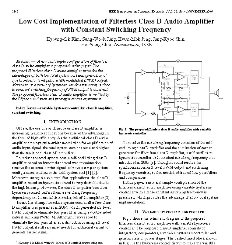

Quite recently Tekko advised a IEEE publication from 2006, showing a IC-way Class D bridge implementation that could be tweaked in one or another direction like UcD vs. fixed frequency vs. synchronization. See attached pictures. I'm especially interested in building a matchbox-sized compact Class D bridge powered by +19V (unipolar) coming from a 90 Watt laptop power supply, featuring a) the UcD audio quality and b) a TTL sync input for receiving a 8 x Fs clock.

Wow thats alot of questions which most i simply don't have the equeipment nor knowlege to answer.
My most recently tried circuit is this: http://i.imgur.com/8xVTPVF.png
Basically an IC version of the Philips circuit, the MAX913 does so far seem to perform better than the LM311.
The clocked class d depicted in this thread was never really intended to be put into actual use, but rather a test to see what i could do with my most powerful power transformer and a set of STE47N50 ISOTOP mosfets, but ended up turning into "lets see how much power i can get outta this thing"
But all work in that project pretty much stopped shortly after my last post in this thread.
As for what gate driver is use, i use mainly IR2010, but have also used IR2110, though the 600V halfbridge voltage capability is overkill for a class d amp.

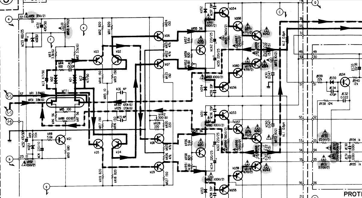

I guess that you are willing to explore Class D, in more aspects. In June 1984 (JAES Volume 32 Issue 6 pp. 415-421; June 1984), Tanaka (and a few other people) from Sansui presented a Fully Balanced Bridge Amplifier. Of course this was an analog design. See attached picture. KVR1 is the usual offset compensation (preventing DC voltage on the load). KVR2 is there for setting the DC operating point (ensuring that both halves operate at half the total power supply voltage).
This weekend, I realized that the differential JFET input stage followed by the Sansui-Tanaka "diamond" stage could be used for implementing a full complementary native Class D bridge, generating the four required gate drive signals.
The two halves of the bridge would inherently oscillate at the same frequency.
The two "diamond" collectors connecting to the negative supply would be loaded by the Philips UcD pseudo-mirror arrangement (Q5,Q6,Q7,Q8 on Philips schematic), sinking current from two NMOS gate drivers (made using Q9,Q11,Q10,Q12 on Philips schematic) connecting to two power NMOS.
Symmetrically, the two "diamond" collectors connecting to the positive supply would be loaded by the same Philips UcD pseudo-mirror arrangement, now using PNP transistors, sourcing current to two PMOS gate drivers connecting to two power PMOS.
I know most people will be repelled by PMOS power devices. There is a price to be paid for full complementary symmetry.
Such design is thus constrained to medium power amplifiers, say +42V and -42V supply rails. Possibly using a single (unipolar) +19V supply coming from a laptop power supply.
I would like to simulate such design. It would help a lot, if you post one or another Class D LTspice .asc (plus .sub and .asy if needed), that is working on simulation.
Any reply welcome.

Have you compared the IR2010 propagation delay, with the discrete approach taken by Philips UcD?As for what gate driver is use, i use mainly IR2010, but have also used IR2110, though the 600V halfbridge voltage capability is overkill for a class d amp.

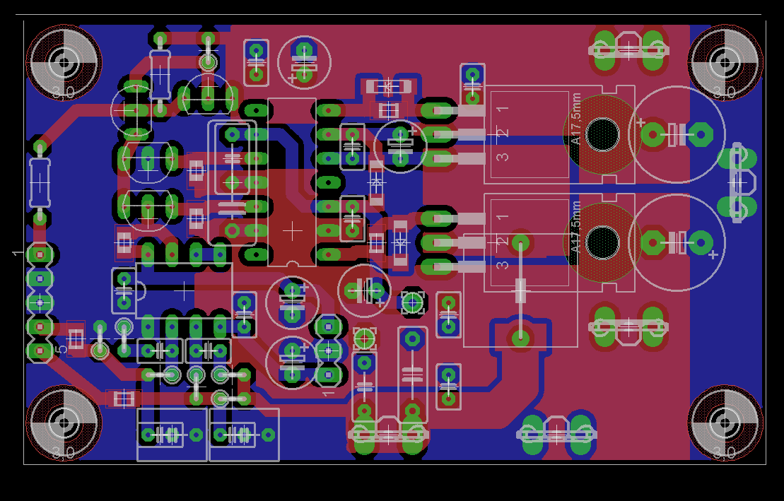

A preliminary board layout for this most recent circuit does exist and is still a work in progress: http://i.imgur.com/0njS4EZ.png
