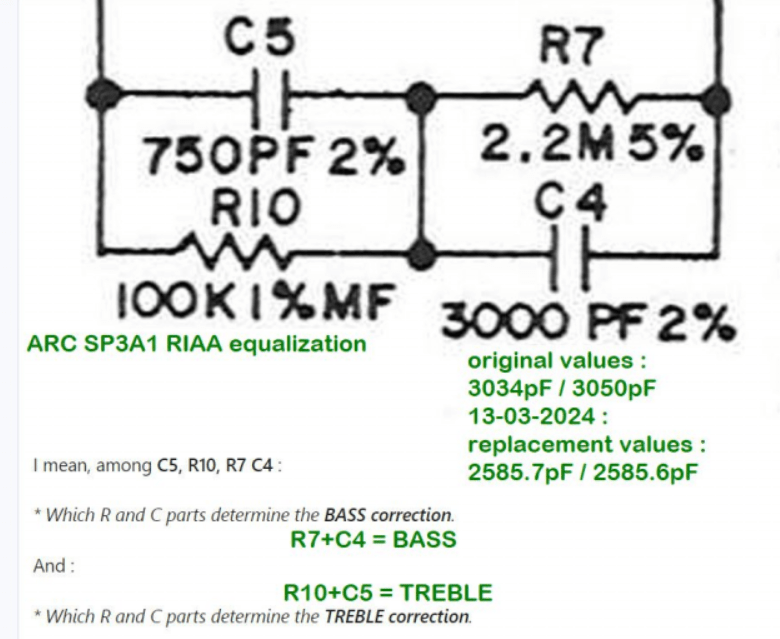

As we are dealing with RIAA capacitors, I think that rather than the technology of the cap by itself, the perfect adjustment of the value is more important...

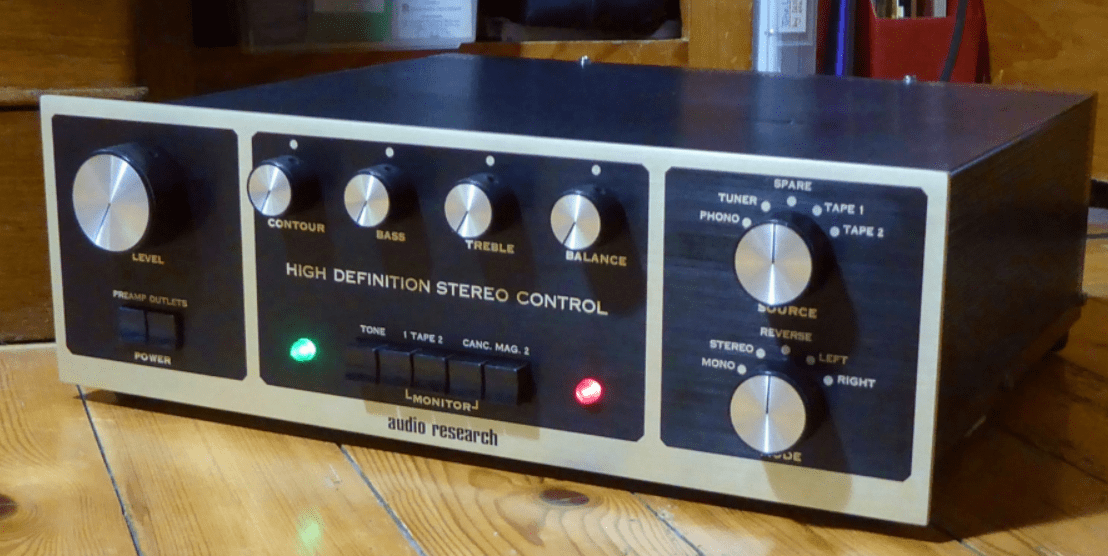

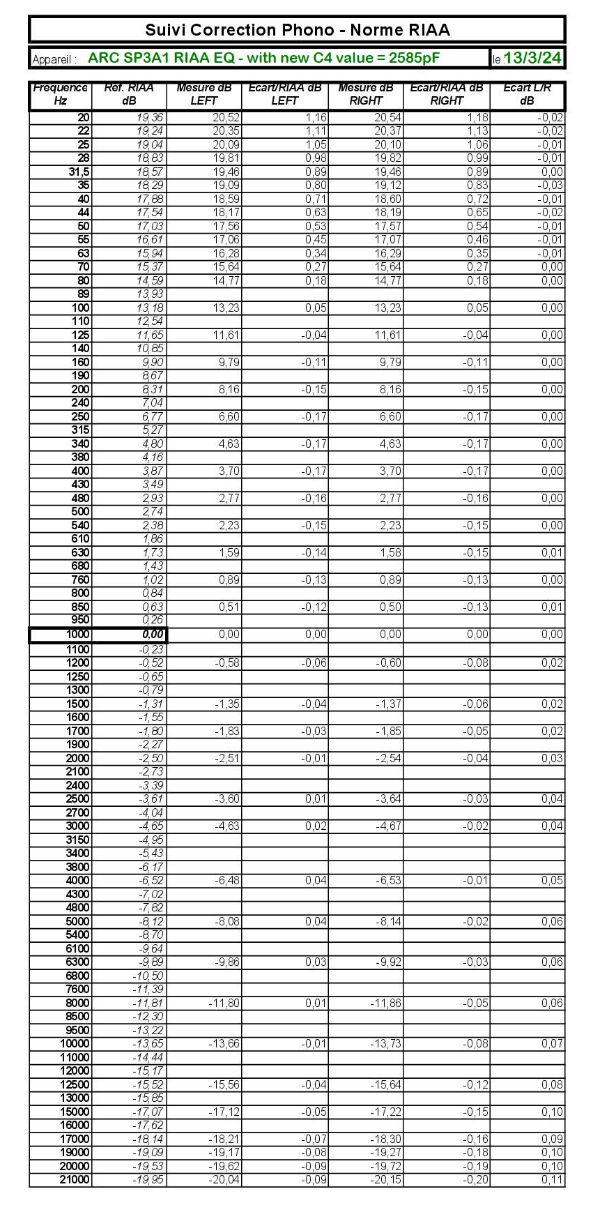

Here are the corrections that I made during the restoration of my Audio Research SP3A1 preamplifier - it concerns C4, which has been value selected and matched :
And here is the RIAA compensation obtained - All values in dB in the table below :
Aw ! Translation of the French terms, sorry...
Ref. RIAA = values according to the RIAA "extended" norm.
Mesure dB = measurement made by me on the modified preamp.
Ecart/RIAA = gap between the RIAA reference chart.
Ecart L/R = gap between L and R measured channels.
