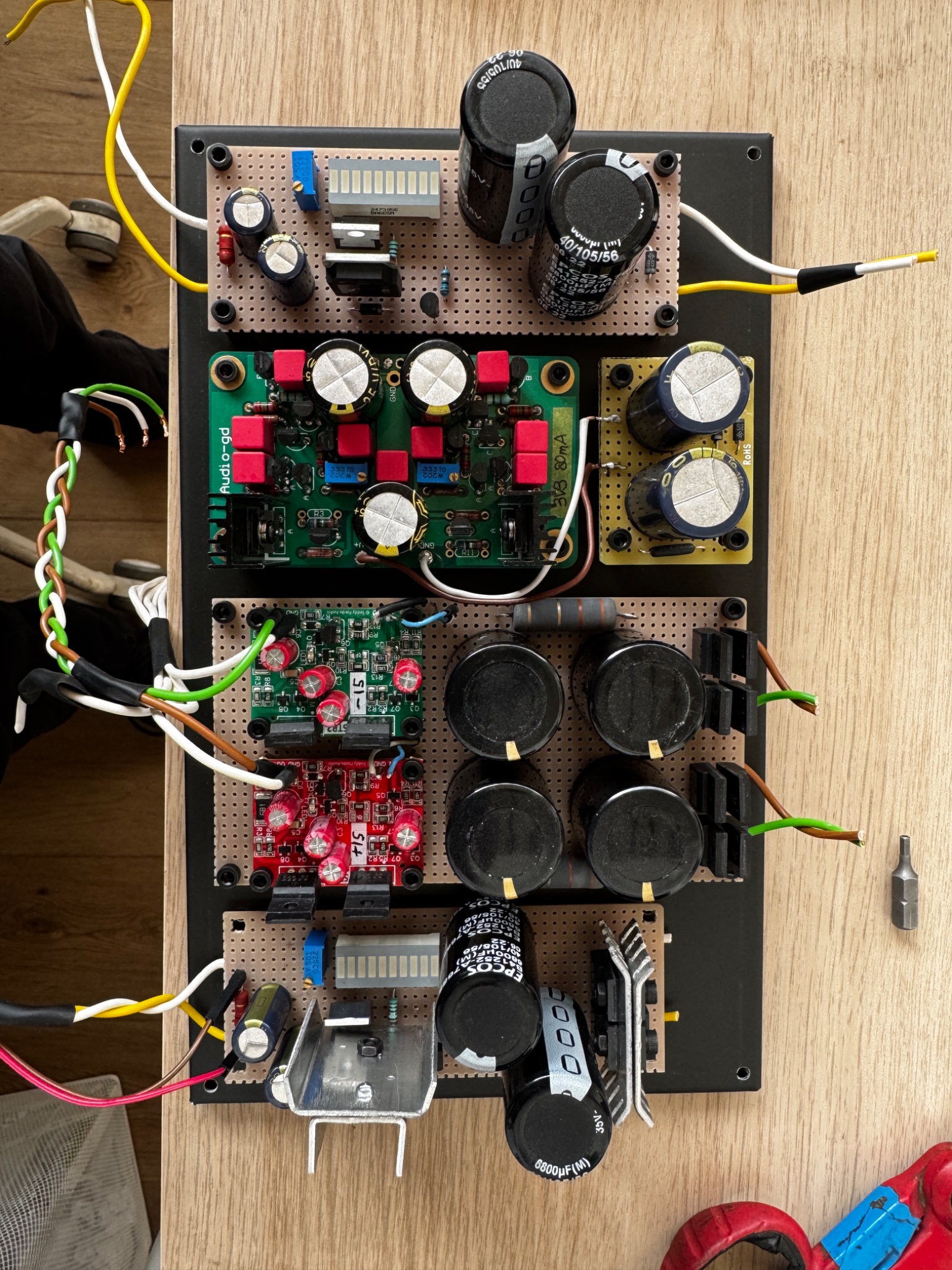

Good evening,
I have an issue with connections in the power supply I’m building. Starting from a 0-9V 0-9V toroidal transformer, I connect the windings in series to get 0-18V. Then, in parallel after each of two smoothing capacitors and a series resistor, I connect the two Teddy Pardo regulators.
It works correctly, but when I connect the two GND outputs of the regulators together, the resistors between the capacitors start to smoke. Where am I going wrong?
Thank you for your help

You can not create a dual supply with a single transformer winding connected this way.
If you use two single diode rectifiers on one side of the secondary and ground the other
transfomer tap it is already symmetric, but even in this case you can not use the "same"
type regulator for both outputs. You need a positive and a negative version like 7815 and
7915 as example. I did not investigate the "Pardo" units come in both versions or not.

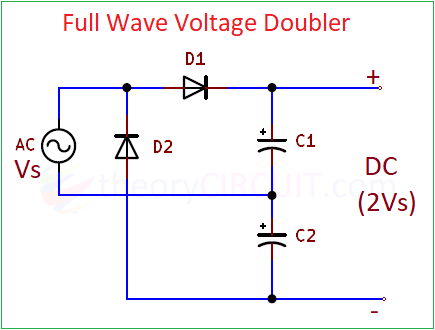

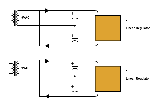

If the secondaries are only 9VAC each, you would need to use voltage doublers instead of a FWB to make this work.
This circuit can use either identical or complementary regulators. Which do you have?
