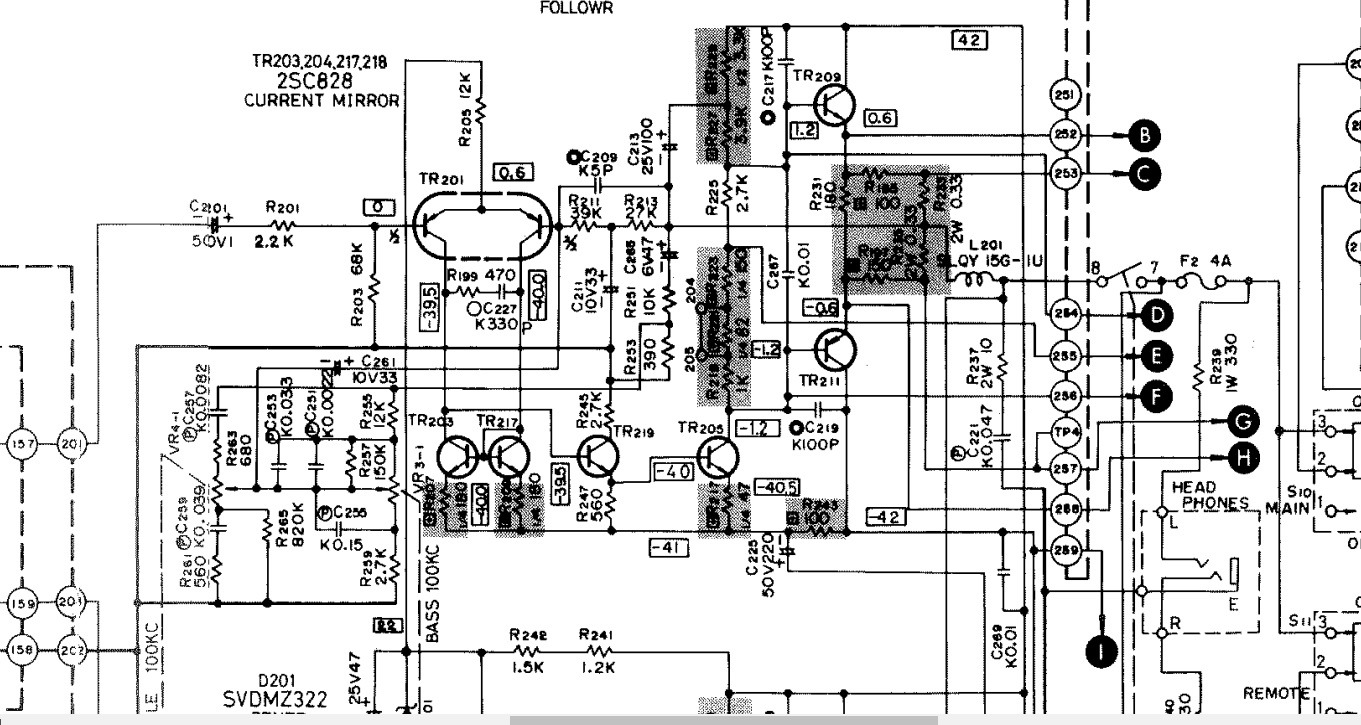

My opinion:
The circuit, the concept, is quite good for complementary transistors push-pull. But the whole build-up is a complete hindrance to the sound. All the unnecessary parts, solder joints, transitions, switches, and so on. This is the main cause of the noise. I would choose an input and connect it directly to the output stage. Then I would replace its solder joints. Measure the caps and replace them if necessary. Then the right channel should also be equally loud.

Oh no , not a amp that integrates the tone controls into the feedback loop. I would not trust that.
Lead (5p) and the lag (470R/330p) is the exact same as my sonance 260.
I would ditch that scam feedback network and buy an equalizer. Technics was too cheap to make a proper
tone control !

What I meant was that the feedback loop is THE most important section of a classic AB amp circuit.
I'm sure the present FB network ( looping through the tone controls) gives the technics it's "characteristic
sound".
On the bad side , parasitic's and any other anomaly can screw things up. On similar circuits , just a few more pf (C209)
can make a amp like this oscillate and act quite "squirrely".
I also meant that this amp could be "better" with just 68K (R211+213) and a 47u + 2.2K dc blocker connected to the (-) TR201.
Then it would be "locked in" as a typical 600Khz bandwidth loop.

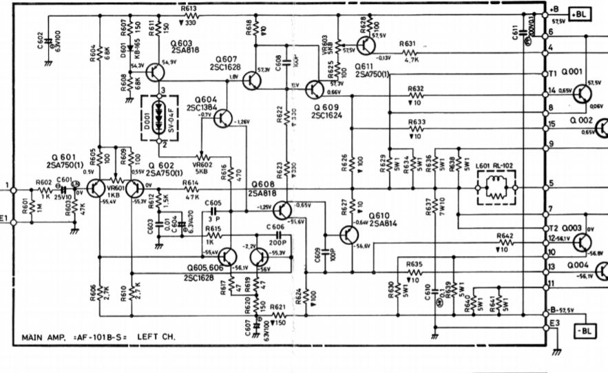

Rotel RA-1412
Nice , same "last forever" circuit as my Sonance 260. No looped tone FB here !
As far as sound , the Rotel should be the same as the technics.
Same basic 600khz bandwidth feedback AB amp.
The Rotel uses better parts , silver mica pF caps and the more refined VAS,Dual mono. But both
are bog standard EF2 output stages.
OS

I would do:
Input directly to power amplifier, i.e. C201.
Bootstrap capacitor, C213, out without replacement. These sound terrible.
Remove the bias network bridged capacitor, C267, "K0.01", and replace it with the removed bootstrap capacitor. Then at least something will reach the "top";-)
Remove the entire sound regulator network in the feedback and use only R213, 27kOhm. Place a 2.7kOhm in series with C211. That's roughly how I would do it.
So you have lost some unnecessary and sound-degrading circuits and paths.
A few little things here and there, and complete new-soldering. Then you can already recognize a few tones and listen to music;-)
Like this, if I haven't made a mistake.
