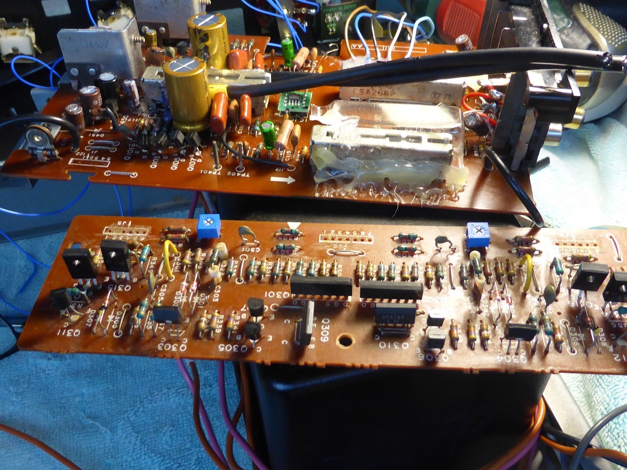

Good news, the silver V8, passed the dim bulb test, and i let her sit idle for 5mins. Should be safe to proceed with adjustments
I wonder if i skip the dc balance and go straight to clamp and icq settings. I fire up the amp each procedure to make sure i have no slip on the clips. I power up the amp with leads attached and turn the DMM on at about 10mins. Finish off with dc adjustment to 0mv.

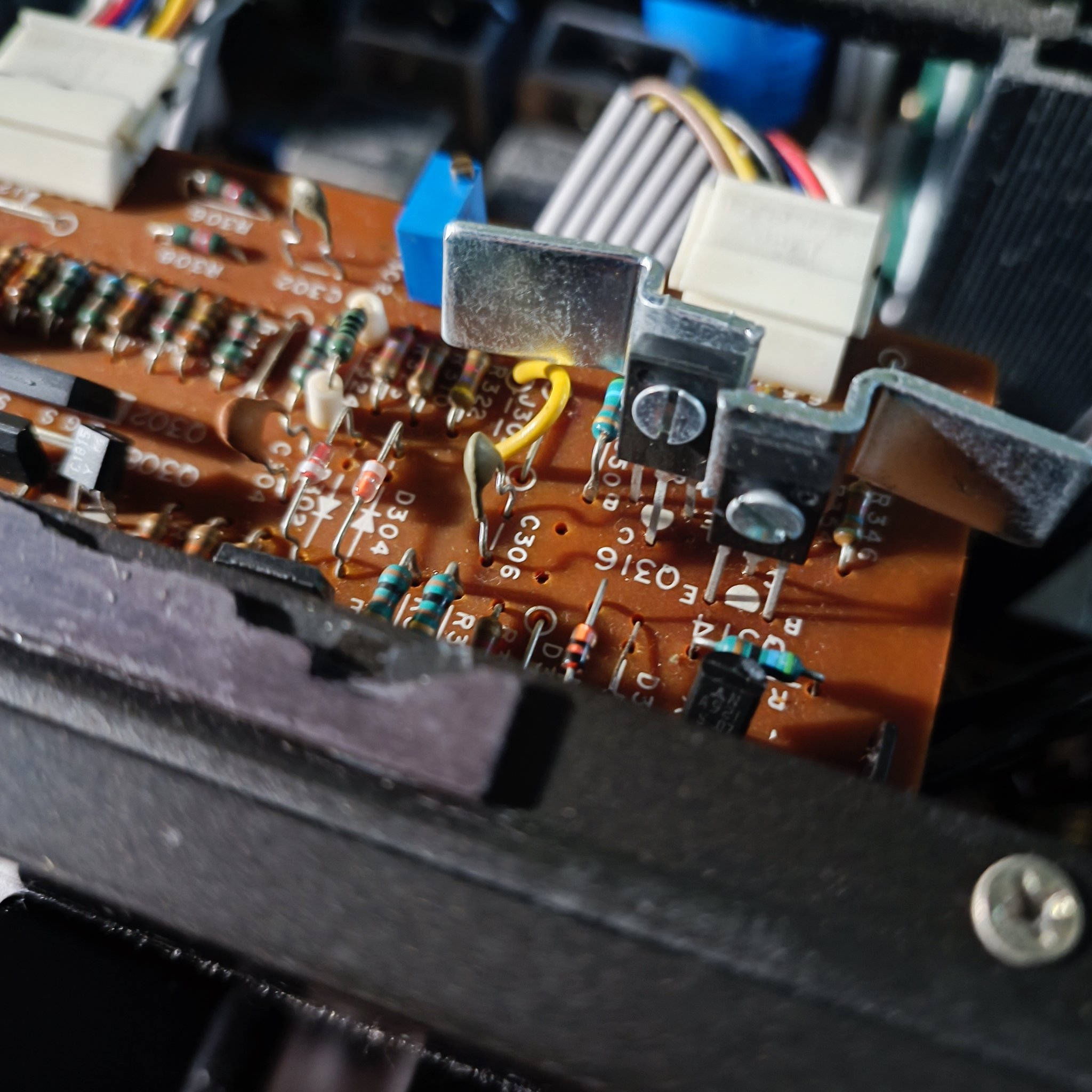

Another issue manual says between R651 and ground. I assume its the speaker end of R651 as in images below, or the front end of the resistor.
Manual points to the back of the resistor

Hello, Sam,
Just follow manual's instructions - points A, respectively B (yellow).

hello.i repaired this amp,its working ok but those transistors 2SC2632/2SA1124 at vas and current source dissipate around 440mw and get quite hot even now at winter with a room temperature of 20 celcius.i am afraid to use it at summer due to high temperatures. i have ksa1381e and ksc3503d. ksa1381e is a good replacement for 2sa1124 but ksc3503d has a lower gain classification. i was thinking of using ksa1381e in place of 2sa1124 as vas stage and TTC004B in place of 2sc2632 as a current source.what do you think?View attachment 1159399
