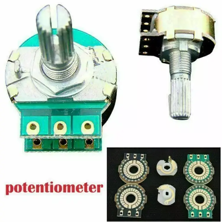

@NIXIE62 I'm not using that pot in the picture, just the control portion along with an RK27 blue velvet model.

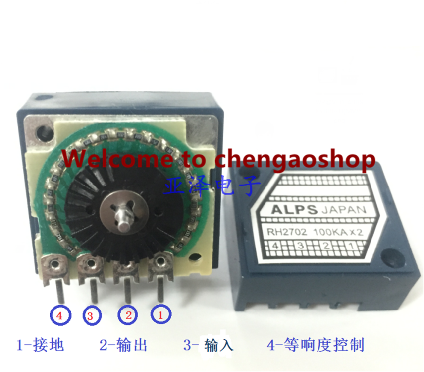

I prefer cheap step attenuators with tiny SMD resistors. They sound better to me than the ALPS RK27. The only thing is that these cheap ones only have 21 step, but I don't mind that. I use a buffer without amplification, the range of the potentiometer practically goes from 0-60%. The regulation curve is good, I have no problem with it. Excellent sound quality, perfect tracking between channels, and low price led me to this solution. Unfortunately, such step attenuators are not suitable for motorization.

Those smaller round body attenuators are nice, especially for the money. I wish they made them motorized somehow.
