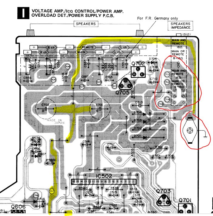

By accident i shorted main speaker output left directly into right! top stupidity🙂, amplifier was idle, no signal going out at that moment, but amplifier was turned on. after this accident amplifier was still working, until it was switched off, after switching on relay was not working anymore.

voltage drop over relay coil is 0,1v
at Q608 collector is 0,1v
tried gently and not very gently tapping and wriggling relay, no action.
Hi, ive just been testing mine also, using the schematics in the service manual ad the advice in this thread.
IC601 pin 12 C04 is 0v at switch on and 2.71v when the safety light goes solid amber. So I guess this is OK (voltage lower than the 2.8v you mentioned SVI2004)
I then measured all three pins of Q608 but I don't know which is which but going off the labels on the circuit board:
E is always 0v
the middle one with the semicircle is always 0v
B is 0v at switch on and 0.66v when safety light goes amber.
So am I right in thinking B looks normal, ie power from IC601, but one of the other pins should then emit a voltage to the coil but isn't?

do you mean R630, the big one? both sides of that are also 0v at all times.
So do I have a rectifier issue? just to double check having no speakers connected would make no difference? im gonna plug one in just in case.....
Anyway, I think it looks like im getting no dc power from the rectifier and also therefore not to the SVI2004 pins that share it, as Ive noticed its not getting warm at all.
tomorrow Im gonna start at the top, with the transformer and impedance switch which looks to select 2 different voltages depending on it's setting. Illl see if that has AC there. then work back from there.
Yes... 0V at R630, indeed is a feed issue... check for DC at main capacitors. Sounds like you know what you’re lookin for....

I checked the pins 13 and 15 on the amp chip and also zero volts.
Checked ac outputs on the transformer and all good (38v, 32v and 11 ish).
those large capacitors are my suspect, but I just need to figure out of any of the transistors Q701 to Q705 and associated components in any way control whether there is the +-50v output from the rectifier or if they are unrelated and control other functions.

So whilst at work today Ive done some more studying of the schematics in the service manual.
since I know I have correct AC from the transformer, and I know the functions coming from the 11.5v supply through the IC701 regulator are working OK, but that I dont have any output from the main rectifier (that provides +-50v) i was hoping it may be a simple case of bad ground connection as circled red. The ground is then traced highlighted yellow.
However since that also is used by IC701 (which is working) I think perhaps the ground must be OK but I will check it tonight.
So Im also then looking at the inputs/outputs from the speaker impedance selector switch. However it seems unlikely that more than one terminal would be faulty meaning no AC of either 32 or 38 gets through.
So then I think OK maybe D701 to D704 or C701 or C702 are likely culprits. However looking at the effects of a failure of any one of these seems to mean I would still get some form of DC output just lower voltage and less steady. Whereas I have zilch. So then I think perhaps the other capacitor C713 (which is present in my case) could possibly cause lack of AC to the rectifier if it was faulty and short circuited? Not really sure what it's for anyway.
So this is my train of thought at the moment and I will remove this main board tonight so I can test the points from the underside since I cant get at some of them from the top.

It’ll be simplistic... tried using 4 ohm or 8 ohm mode... impedance sw may be it...
Check continuity from xfmr to rectifier.... diode test will quickly reveal rectifier health...
check continuity from rectifiers to caps... - there are a few jumper pins- it’s a long shot but could be dry joints...
It’s a simplistic circuit involved here... the answer is near.

after some more testing i found that speaker impedance selector switch was not functioning, after cleaning it was fixed and working.

I have also decided my impedence switch is suspect. Quite why it would be likely to fail I don't know since the number of times it will ever have been switched can probably be counted on one hand!
So aside from my last confused post (having googled how transformers work I think indeed all windings share a ground so probably nothing to worry about) I tested the output poles of the impedance switch relative to the switch position and the two sets of inputs. There was no continuity in either position but moving the switch slightly forward and back gave some intermittent continuity.
So I am now thinking this is likely the simple answer and I might just bypass it as I always will likely use the 8ohm setting.
