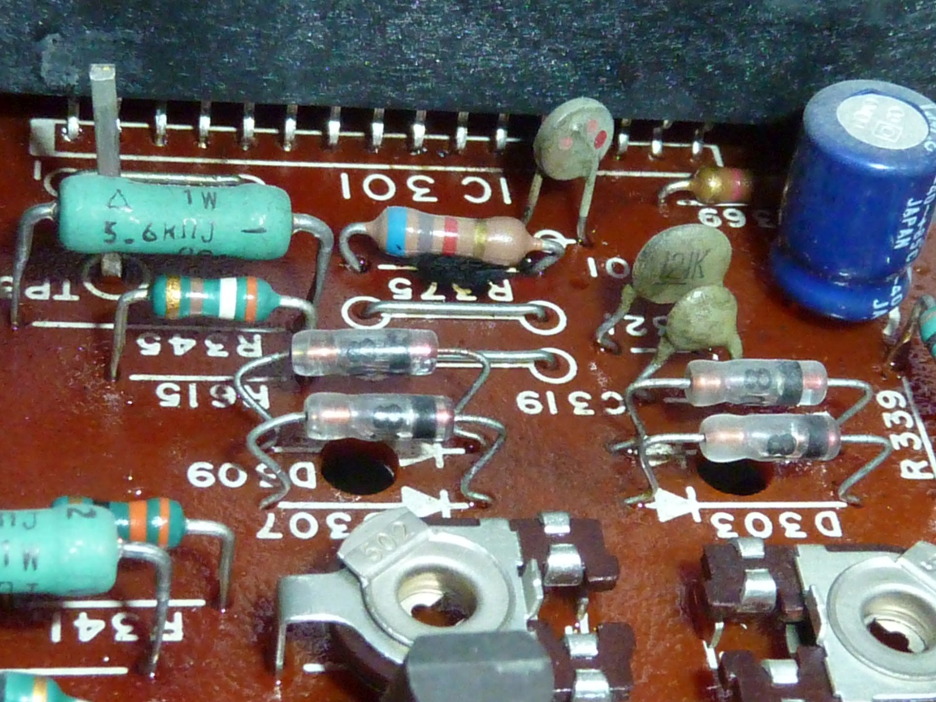

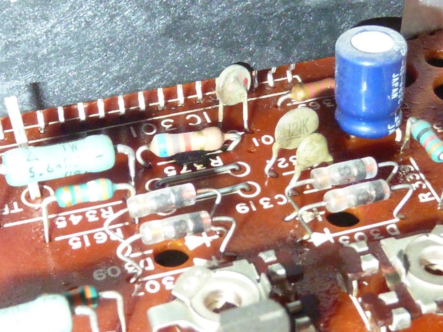

I've looked over the PCB from both sides, I found one solder pad connecting R375 to TH301 had lifted from the PCB, along with the components. I resoldered these two together, so I don't believe there is an issue here anymore. Guess that's why it's black under the resistor. I would say this is on the Left Channel.

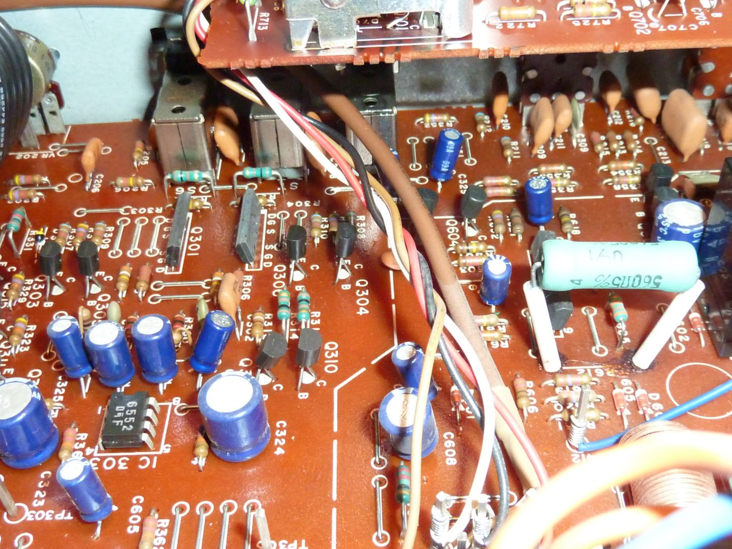

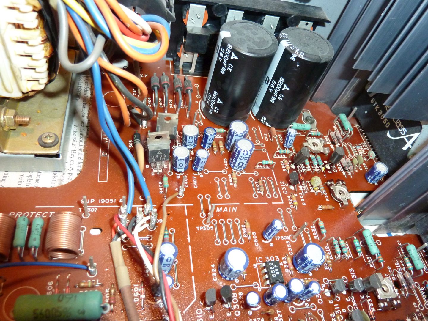

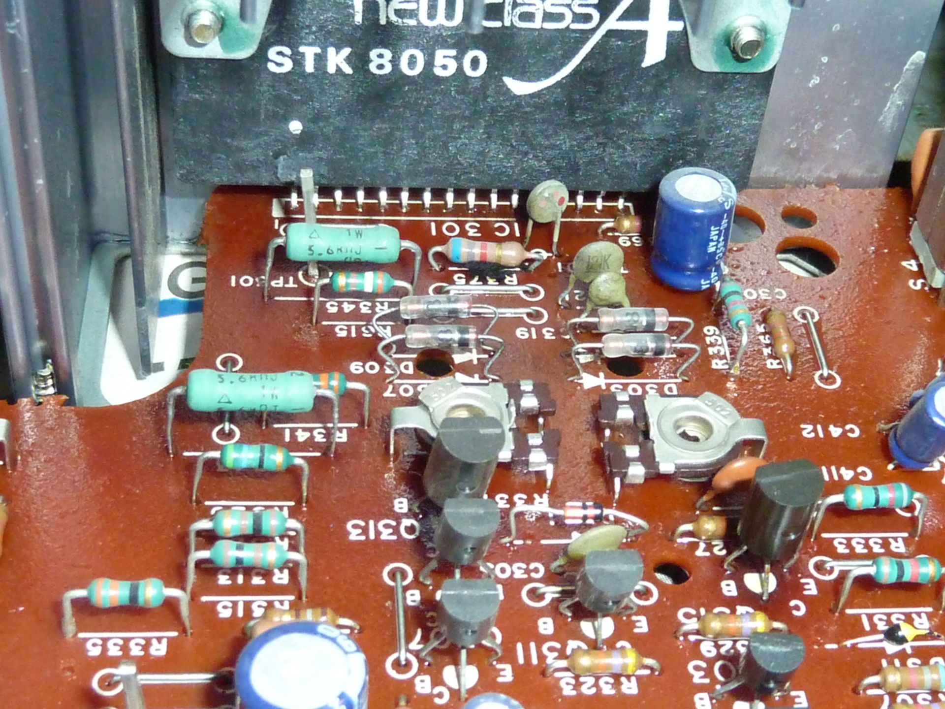

I took pics of the main & side boards a year ago and again today. I'm not seeing anything different. Small dark spots under a couple of transistors ( Q314 & Q316 ) and under R375, but I don't believe it's anything major. I think the spot under the resistor is from heat during the original installation, as that one is physically larger than the one at R376 and the solder joint doesn't look as nice as the others.

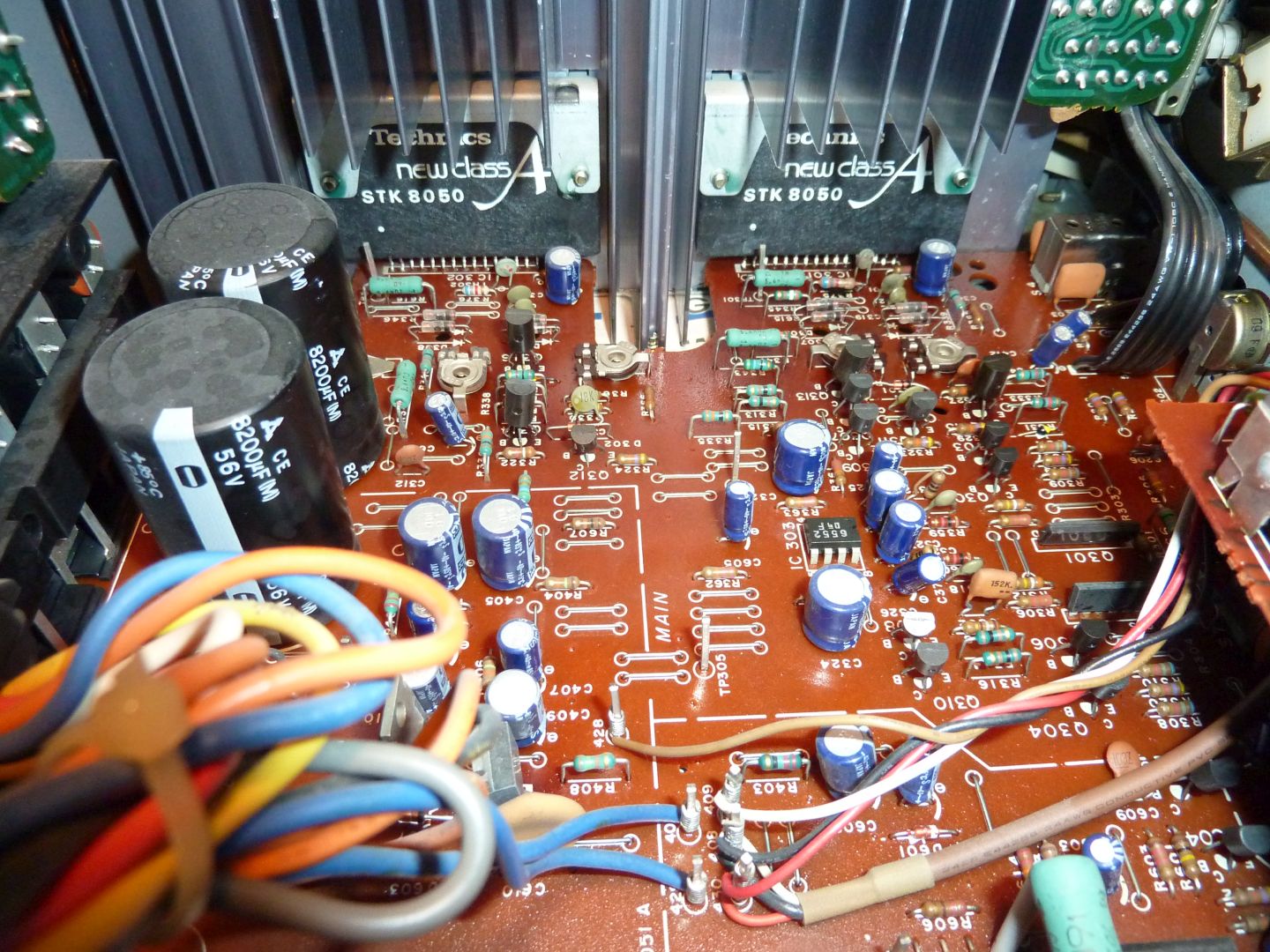

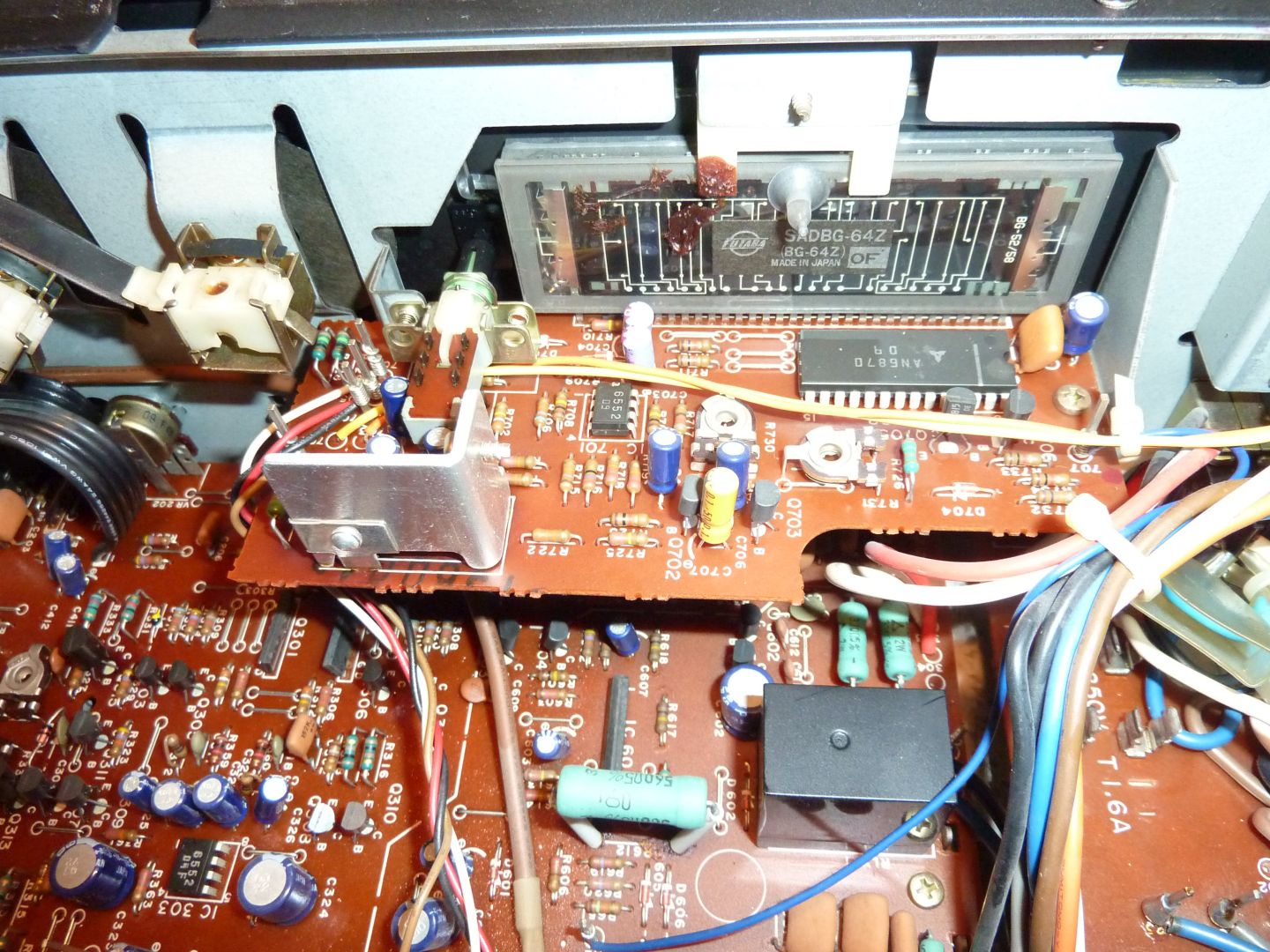

Here are some pics of my PCB:

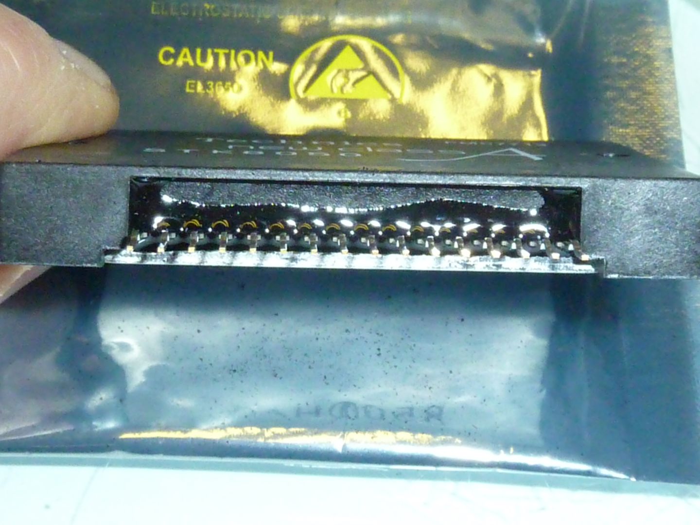

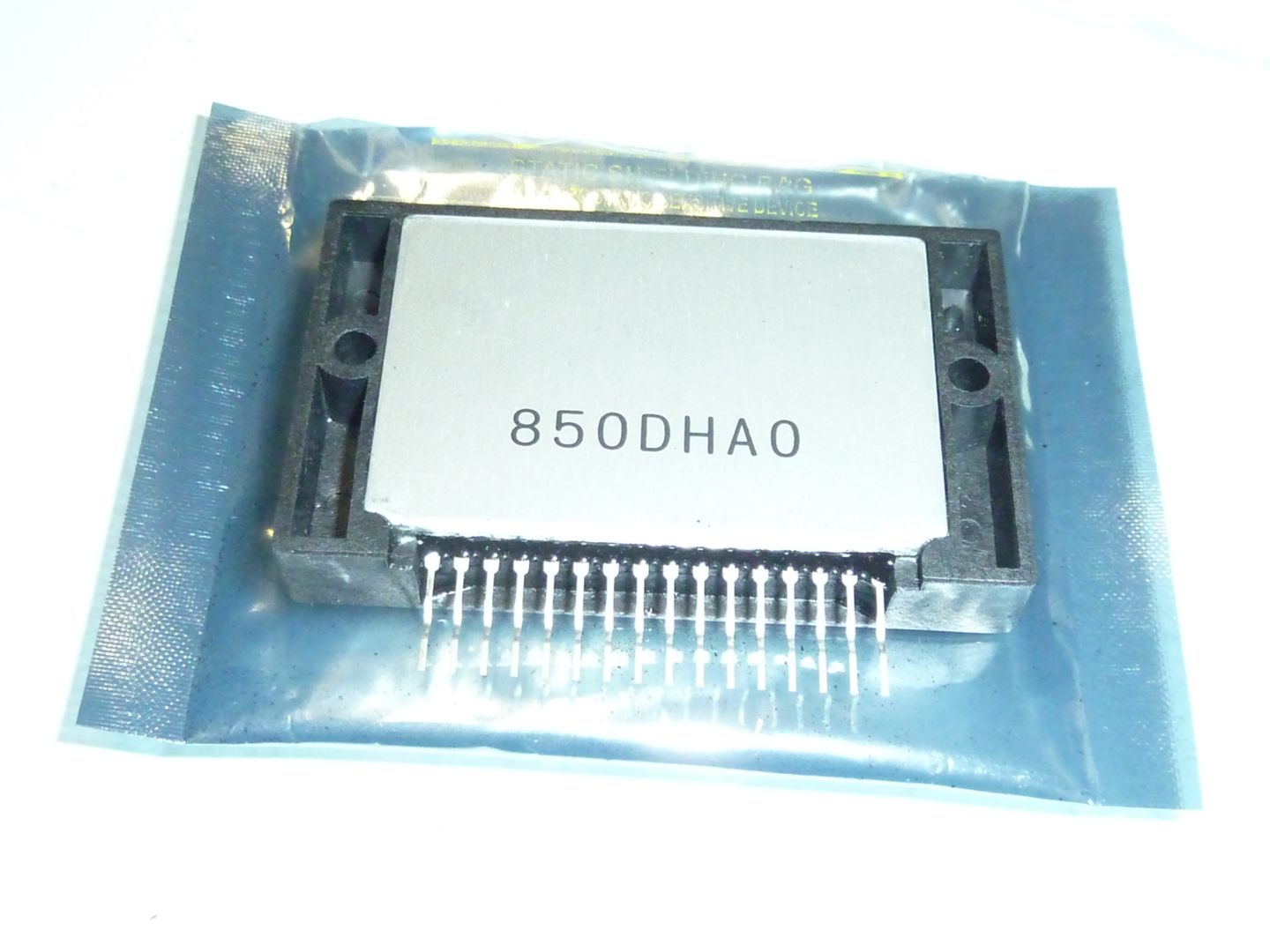

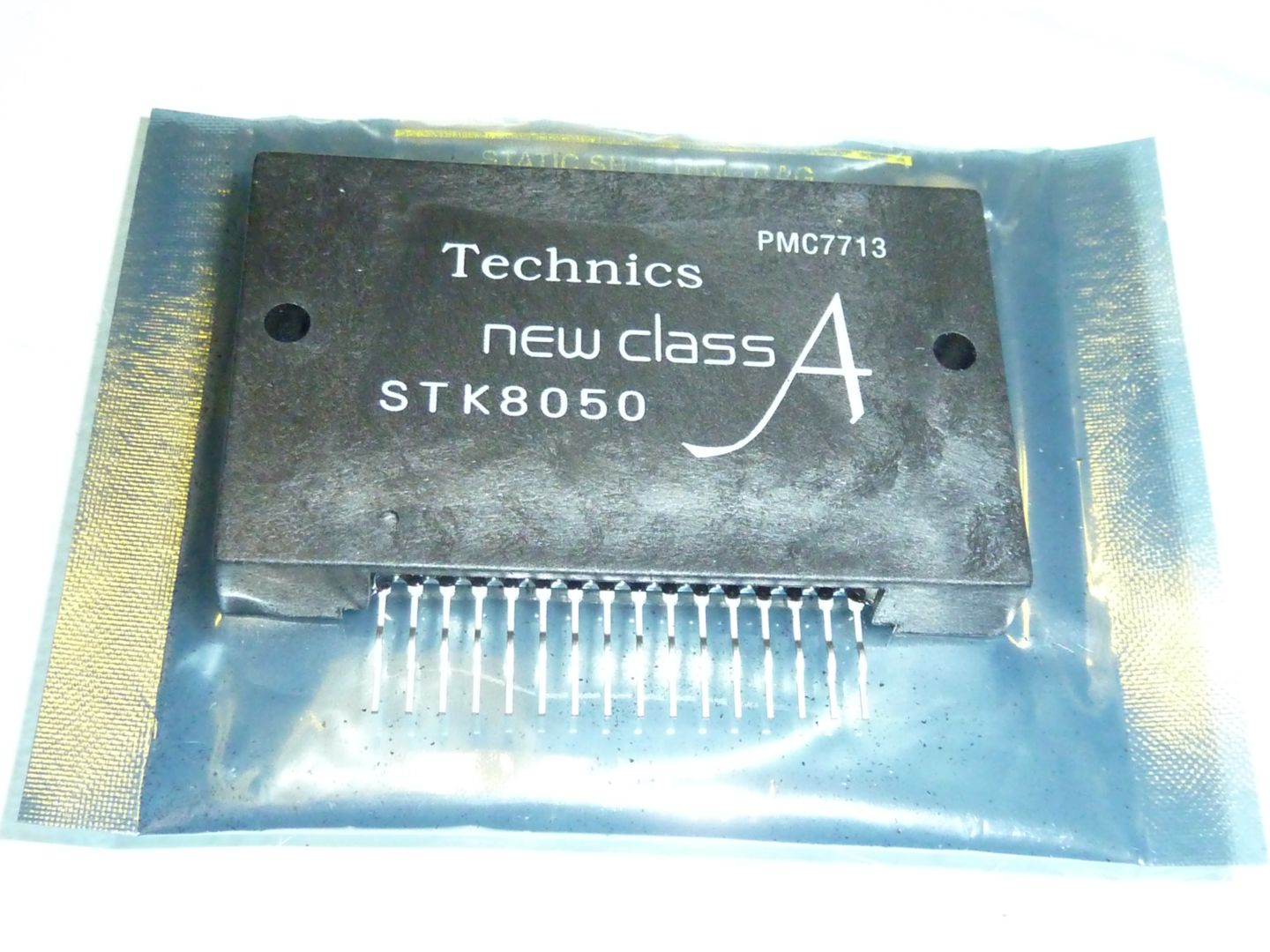

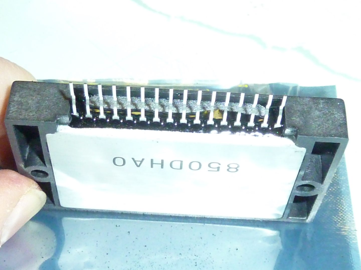

I also have a couple of pics of my "Replacement" STK-8050's.
I do see some difference to the units in my AMP -
1. The Typeface is slightly different note the "T" etc.
2. the "A" logo is a bit different as well
3. On the ones that are installed in my amp, the first and last two contact legs are bent backwards, on the replacements, they are all in the same direction.
4. The installed ones have a small white dot below the "STK"
Wondering if these are counterfeit or a different series? I know the installed ones are the originals.

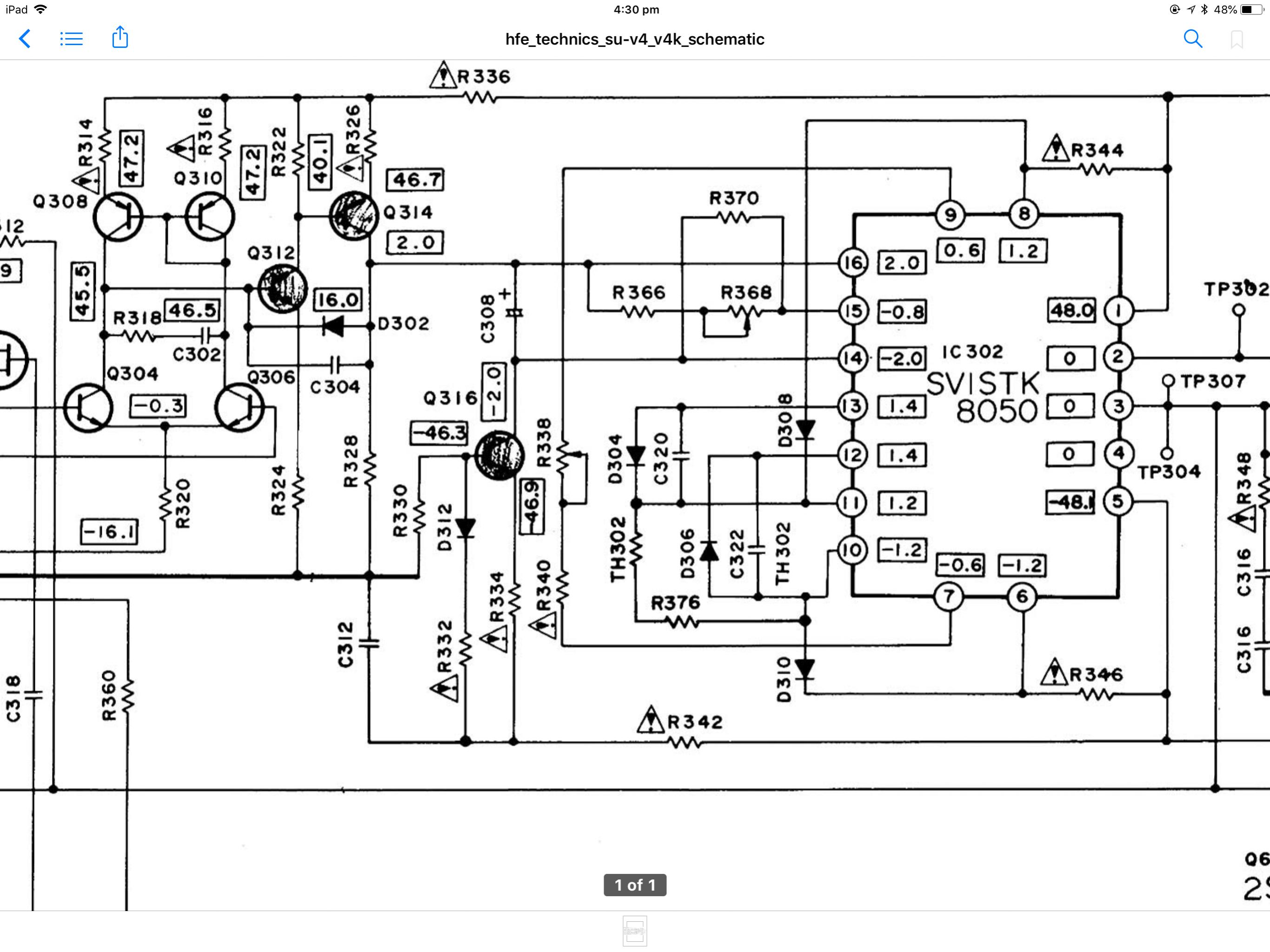

OK, did a bit of "Research" and figure that I measure between chassis ground and whatever. So here it goes:
When the unit is switched on from cold, the FL meter on the face went to a 30 on the low range, then the level slowly dropped down to the 0.1 in around 1 minute. Nothing is connected to the amp, volume turned down and all other pots centered, switches to 'off'
I measured both STK's from below, the soldered side of the PCB.
Left channel (good) both pins 10 & 11 read O.L.
Right channel (no sound), pin 10 goes from -65 to +56 mV dc.
Pin 11 reads O.L.
So, I guess that the wildly fluctuating mV are no good and that that power amp / driver is no good...
Looks like R375 was replaced (most likely knocked off when old ic failed) (you say left channel is working now)
With that set ODD # is left ch - even # is right ch
Examples R375 R376 TH301 TH302
It’s helpful for comparing things (voltages at locations) to other channel
R376 is it 6.8K and what resistance is TH302? (Removed from board)
Are the OA90 diodes all ok?
Thanks a bunch Bailey.
This amp has never been serviced previously. I bought it new and haven't done anything to it aside from contact cleaner... yet. It was a Military Market unit with the multi Voltage adjustments.
So both STK's have been in it all of the time. I picked up 3 replacement STK-8050's out of GB a few years back (just in case they are ever needed), with the assurance that they are 'Originals' from a Panasonic Service center. Hope that it's the case.
But yea, R375 is slightly larger than its' mate on the other side. And the pad on the bottom where it joins up to the thermister is loose from the board, but these are the only components on that trace, so I think it should be fine.

1st call with set off check Rch STK (IC302) check with power off continuity from pin 2-3 and pin 3-4 (should be 0.2-0.3 ohm) - this ensures Emitter resistors are ok (definately check if thermistor TH302 or R376 was open)
Of that checks out, power set up
Checklist for 2V at collectors of Q314 and 316 (drive from differential amp)
If 2V isn’t there at both points, other voltages on STK won’t add up
If ok... check voltages on Rch STK - it may help find what is adrift.
As for OA90 diodes can check with one pin lifted. (These are germanium diodes) - with power off

1. Continuity checks - IC302 --> 2-3 0,3ohm, 3-4 0,3. IC301 --> 2-3 0,3, 3-4 0,3
2. Voltages to Gnd: Q314 --> E= 51.0Vac, C=1.962, B= 50.1
Q316 --> E= -51.0, C= -1.894, B= -50.3
Q313 --> E= 50,8, C= 2.117, B=50.4
Q315 --> E= -51.0, C= -2.092, B= -50.4

Do you think the STK's I have are originals or fakes?
I use braid - I got to the point where I never have stretched or bent pins and pcb suffers no stress from removal.
The STKs should be fine... there was a re run done that was not counterfeit- I have installed a few over the years... it’s been 4 years since I’ve worked on a V4

I have removed IC302 (the STK8050) by removing the upper heatsink, unscrewing the IC302 (nice that they made some holes in the side board to allow access to the attachment screws).
