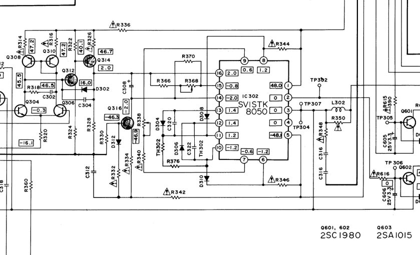

So I'm working on one of these for a friend. One channel was dead and I diagnosed it down to the STK8050 on that channel plus D308 which is an OA90 germanium diode.
I have a few STK8050s, so I have replaced the dead one. Unfortunately I do not have any OA90 or suitable germanium equivalents. I just have 1N0007s. I fitted one to test that I'd correctly diagnosed the problem and sure enough it's working and sounds great (and the same, to my ears) through both channels. However I don't know if there's any long term issues with leaving this substitution in the amp. Obviously it has a higher voltage drop than the OA90.

I would find the schematic for the STK8050 and see exactly what is the purpose of the diodes. It may or may not make any difference, if it does make a difference the STK8050 will let you know and not in a good way.

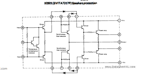

According to the STK8050 datasheet - the diode anode connects to pin 8, which is connected to the collector of a bias transistor. The cathode connects to pin 11 which is connected to the base of a driver transistor
As for the voltage drop, comparing with the other channel which still has an intact germanium transistor...
D308 ANODE - 1.10vdc (original also 1.10vdc)
D308 CATHODE - 0.60v (original is 0.89v)

These diodes control/affect (to some degree) idle current.
So the drop voltage will matter.
Maybe it'll be good enough to re-adjust idle current after replacing the diode.
You may also lose symmetry between upper/lower swing..

Okay, having previously thought it was probably okay based on this thread - i'm now thinking it's probably not okay based on your comment minek123. I'll tell him to go without it and we'll courier it down once the 1n4148 arrives.
