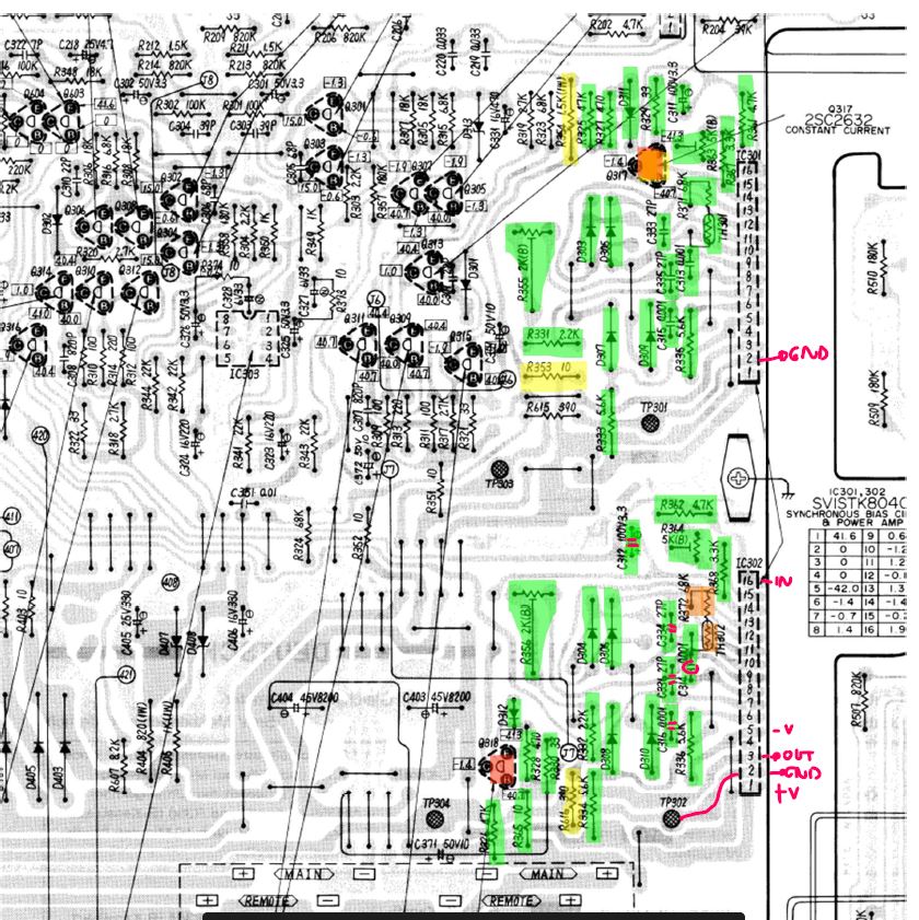

Introduction: My SU-V2A has been repaired a couple of times by replacing the burned STK8040 with those IC ... fake IC I could find online. I opened them after burning and I could appreciate the main differences between the burned original and the non original. One stk 8040 is still working, just one channel. I tested it also in the other channel in order to check the electronics around the IC.

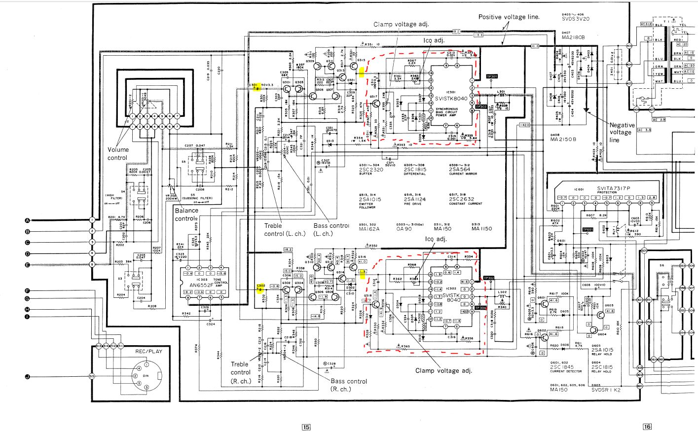

Repair with replacement of discrete components: I've dismounted the STK8040 ICS and the relative controlling electronics, hope not too much 🙂 (green and orange in the picture), and red dashed line in the schematic pictures.
(The red hand written gnd indication is not meaning that the pin is GND, but my intention to connect it to gnd in order to have a try to manage with the protection circuit)

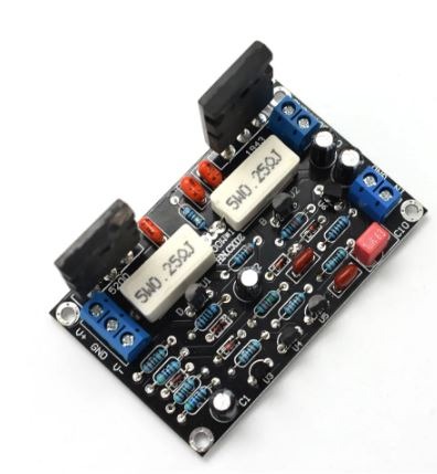

I'd like to implement the amplifier with a couple of Amplifier board like the following "Suqiya-nuovo tubo 2SC5200 2SA1943 Mono canale HIFI scheda amplificatore Audio 100W DC 35V C1-001" that needs the same potential powered by the amplifier supply:
Question: How may I improove the SU V2A with these kind of boards? where can I get the signal from the SUV2A preamplifier (including tone controller)? Is it correct having removed those components I mentioned above? ... may be the Q317 and Q318 should stay ...
My test: Giving power, I read the dual voltage both in the power and service lines. Signal in aux in order to look for the preamplified signal in the SUV2A to test with an axternal amplifier--> found signal just in C301 or C302. Signal NOT managed by the filters and tone control... . Trying to get the signal from pin 16/14 ... NOTHING.

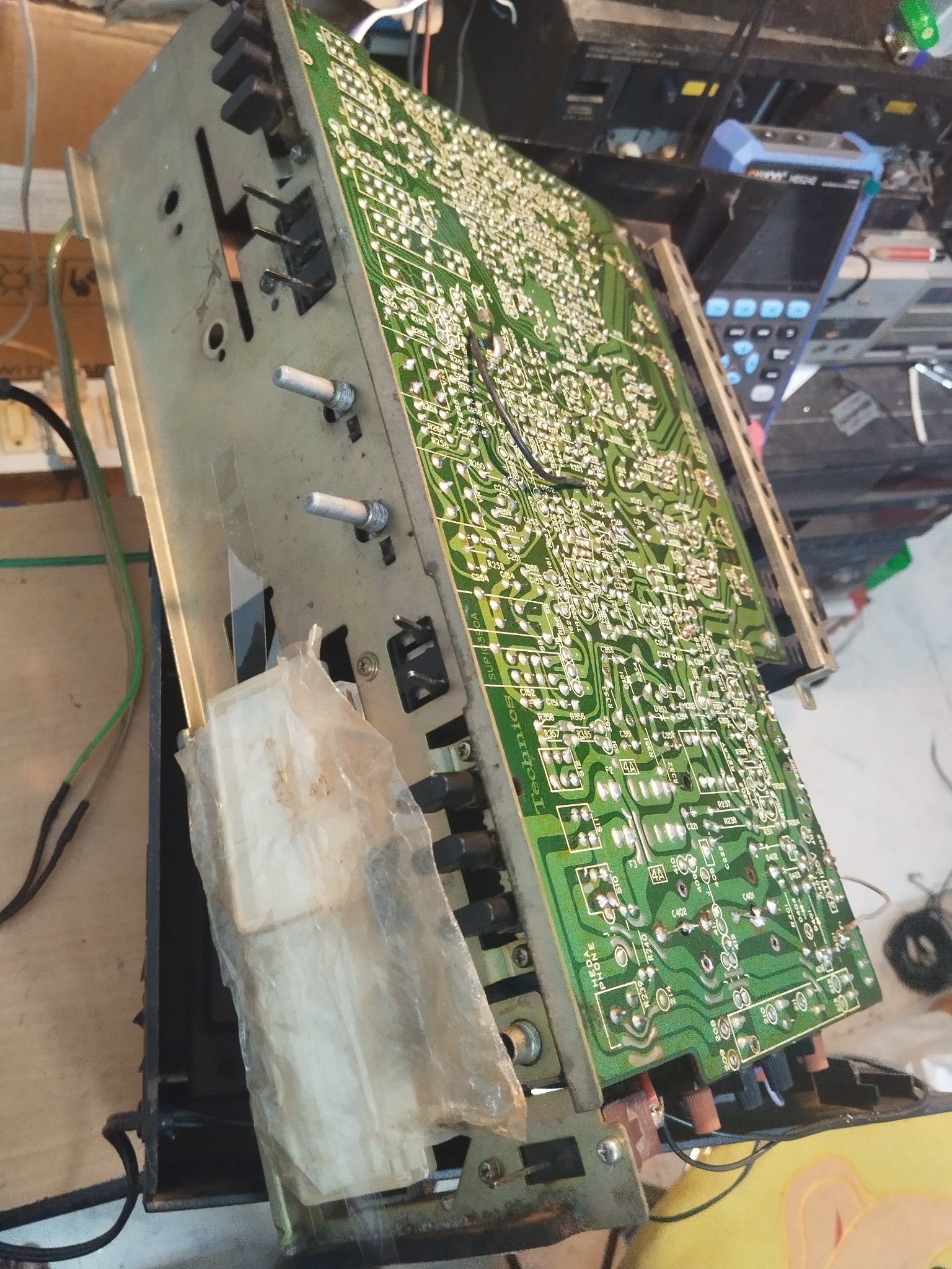

Hi there.. Greetings 4m Mangalore, India. Wanted to tell you that although ur post is>year old I answered to share my exp on the same. Had earlier had repaired SU7700 with several issues, most off then related to failed electrolytics even the main filter in one of the legs.. What pictured me no end were queer voltages making me go crazy like a merry go round. It was only nu chance that I "heard" sometime on the net explaining the same issue. Once you take a Technics amp apart you've got to confirm the earthing as Technics prefers to keep it "floating"for some reason and I believe it's 'official' for trains best known to the company. This earth is complete only on installing the bottom cover which completes the earth, so look out for that and watch out where you complete the earth as you may easily create an earth loop of arnt too careful. Is singing beautifully now and I really appreciate the reproduction of this amp. Coming to the subject in Q, I've gone thru the ckt and in the amp that I'm repairing is got a horrible sounding opt. The
Both opt Ic,s appear ok. And there isn't any Dc on the opt. The opt relay works too. I'm looking at the preamp,s and investigating the issue. Will keep you posted on the same. Point worth nothing is that the tone controls are part of the feedback in the Pwr stage, this is a rare approach and may req indepth investigations. Don't go for drastic surgery as you've suggested as it may not yield itself easily to installing any other another amp if there is some fault in the opt stage due to the inclusion of the Fb n/wk within. Glad 2 to know that there are still some "brave" guys out there willing to walk the extra mile, sorry many miles to do the job. Best wishes. Thank you Bye n take care. Snap shows 7700 being 'wrapped' up b4 delivery...
