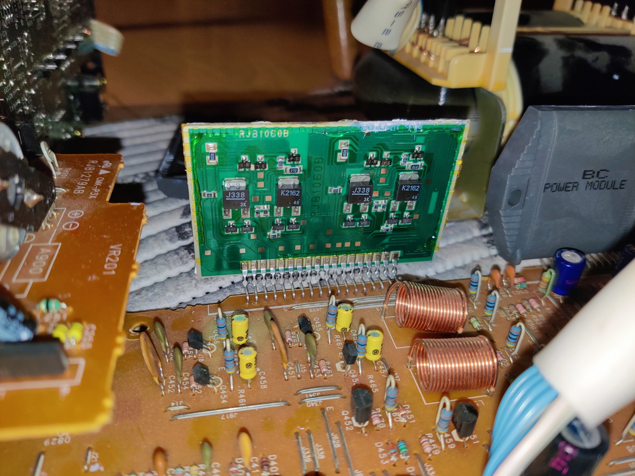

few years ago my son unfortunately overloaded Technics SU-A900MK2 amp, full volume on 2x 100W 4ohm speakers... This exact device was in 2 service shops and both told that it has faulty AMP and it's not worth it repairing so they put their hands away from it.
AMP "does not amplify", it just leaves the sound that comes into the AMP
I haven't seen any burnt transistor, shorted capacitor or burnt route on the PCBs, relays do turn on so the protection is fine
the 2 power modules - SVI3205B + RSN6000B seems also fine, zener diodes checked with multimeter, nothing weird 🙁
RSN6000B does have a power transistors which can be purchased from link below - 2SJ338 + 2SK2162
https://www.ebay.com/itm/192202054620
17.2V rail does provide 17V
Q751 + Q752 are quite hot -- they wobble so the solder is melting
I will try reflowing the PCBs, desoldering the transistors and checking them.. in best scenario I wish hopefully the transistors inside the RSN6000B are faulty and nothing else 😀
Does anyone had a similar issue with Technics AMP ?
Schematics included in the attachment
Thanks a lot for your thoughts!
