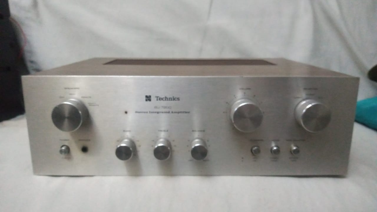

Hi, thank you wg_ski for your valuable contribution. My Technics SU-7200 has come back to life! It has an excellent sound despite its really simple circuit. I hope it has a long life! Thanks again. Best regards.
