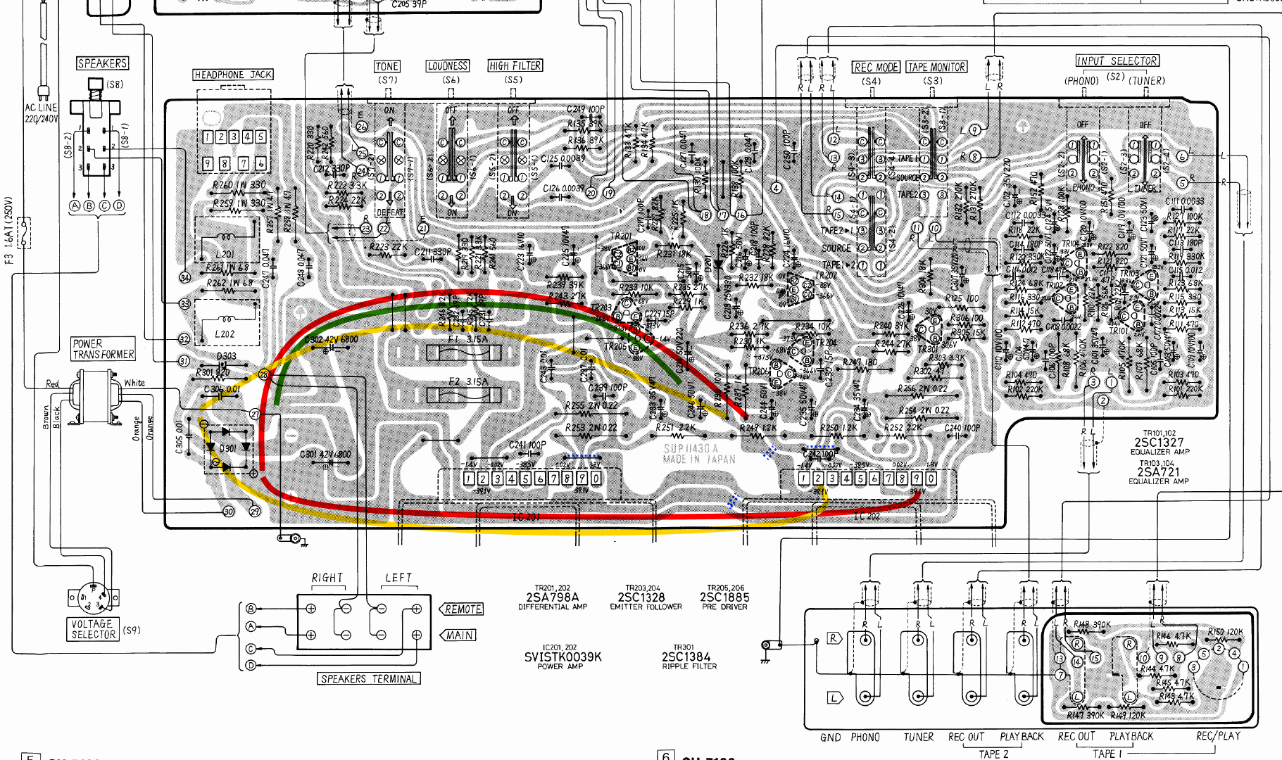

I restored a Technics SU-7100 once, with both STK0039 and all other semiconductors still working.
Apart from the recap, I analyzed the PCB layout and ended up correcting some of the original supply tracks. These are meandering across the PCB going from one current sink to another, reaching the sensitive voltage amp stages last. My intention was to give it a proper star design.
red: positive rail
amber: negative rail
green: ground
dotted blue: removed jumper or scratched track
Soundwise, the result of the restoration was very pleasing.
- Johannes

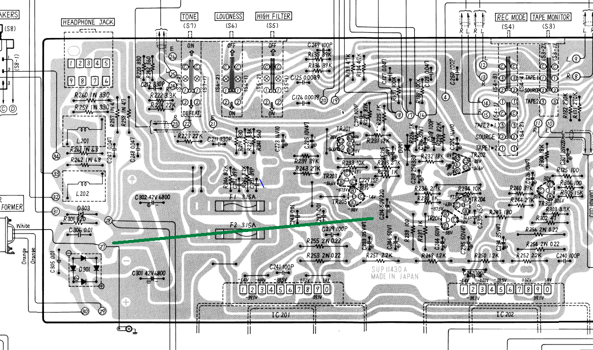

I'm not sure whether this would have a super great effect, the LTP/VAS supply is being RC filtered after all... I would consider doing just the mod pertaining to ground. (EDIT: See attachment. Color scheme basically the same - thin blue = cut, thick green = ground wire.) Making the path from D201 to point (4) lower in impedance may also be worth considering, but honestly it's fairly short as-is.
Speaking of ground, where did you cut that? Maybe I'm just blind or you forgot to draw it. I'd suggest next to C231 if you don't want to unsolder anything.
As someone else wrote here recently, these Technics amps were quite well engineered and usually don't have anything major wrong with them as far as execution goes. Of course you would no longer use 250k volume pots and such these days, but that's just how things were back then.
Rerouting supply paths: Going for star topology at the very least makes sense for the high-current rails to the STKs. Originally both, positive and negative rail, first visit STK IC201 and then continue from there to STK IC202.
Recommended extra ground connection:
You are right about the missing cut. I believe I put it close to where you have marked it.
Your recommendation for adding another ground connection (D201 to Cinch ground) makes sense as well, as I now see.
I see what you mean. It probably isn't terribly terribad as they generally managed to keep the V+/V- tracks next to each other for low inductance. (Really not a bad layout for the time.) Still not as good as two twisted wires of adequate diameter, mind you.
That part comprises the lower two supply wires, the removed jumper next to IC201 and the cut next to IC202's heatsink.
The other two wires and cuts can be left out, they really aren't doing very much as I said.
