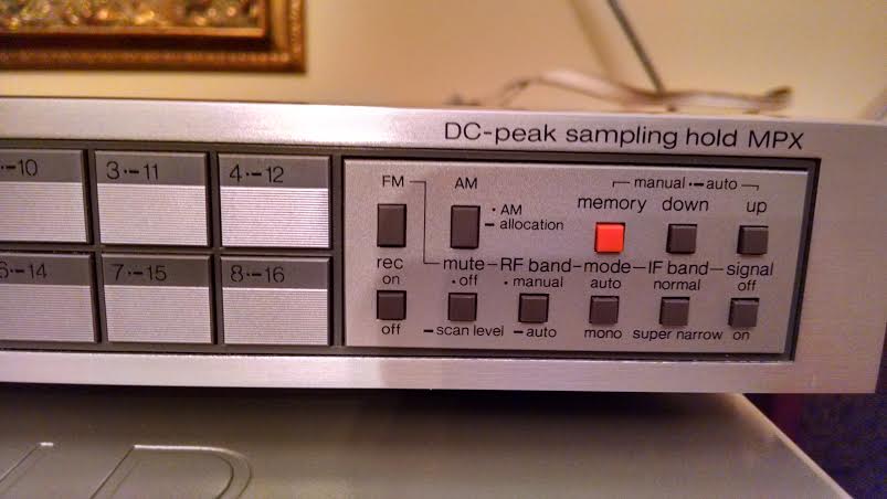

Now as this tuner is well equipped with capabilities, use the reduction method to do the initial FM troubleshooting without poking inside.
Ensure the FM antenna is properly connected.
Dial on a strong signal.
25 kHz/100 kHz tuning selector to 25kHz.
Auto/ Manual selector to Manual.
Muting to OFF
Mono/ Stereo to Mono
RF narrow
IF narrow
If the problem is due to some switch settings, the above combination is the least interfering.
If with these settings you have no signal cut-out problem, change switches position –one at a time-starting with the switches at the bottom of the list.

Thanks George and DF96 for some excellent advice. I'm feeling a little stupid for not reading the manual before messing around and asking questions. At any rate, the tuner has a variable muting function that can be set to 20, 30, 40 or 50db. It defaults to 30db. It can be turned off but it automatically comes back on each time a new station is tuned and must be manually turned off again, if desired.
So I can get rid of the annoying muting but it still goes in and out of stereo mode in concert with the audio level peaks. So, is it possible I still have a bad cap or does it just need an alignment?

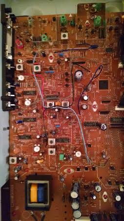

Here is an internal photo and the subject MUTE OFF/SCAN LEVEL button

Tweaking a discriminator coil usually isn't that hard to do. You just need to know which one of the two in a hi-fi tuner to adjust (T101, T102), and preferably do so with a non-metallic or non-magnetic tool in order not to throw off inductance. I'm not sure what sort of coils this tuner uses, maybe it's a screwdriver-friendly type already with a unit this "new".
There are two test points marked "FM off-set voltage 0 mV" here, between which you'd connect a multimeter. I suggest you do so now, you'll probably find an offset of several hundred mV.
Hi-fi tuners usually have two tunable inductors where you tend to find only one in more basic equipment. This more complex setup allows widening discriminator bandwidth and thus bringing distortion down. One of the inductors will be adjusted for minimum DC output voltage, the other for minimum distortion when using an appropriate signal generator (depending on tuner spec, it should be good to about -70 to -80 dB, or 0.03% to 0.01% THD). We are only looking to adjust the DC offset here, which thankfully brings down requirements in terms of tools a fair bit.
Going by other tuners, I think T101 should be the one we're looking for. You should be able to verify that, however, by approaching both coils with some decidedly ferromagnetic tool like a mid-size screwdriver while watching offset voltage - one should show a lot more effect. (If in doubt, mark position, watch out for effect when adjusting, and return to original position if things don't look promising.) If you don't have clip leads for the multimeter, get someone else to help you with this step.
Most people will have to make a non-metallic adjustment tool themselves, but if carving wood or plastic is not your idea of fun, a conventional screwdriver may also get the job done, though in a more tedious manner as you would have to remove it every time to check whether your alignment is OK now. Just be careful if you find inductors requiring hex tools, these are very easily damaged especially when tight.

I followed sgrossklass's instructions.
As he mentioned T101 was the inductor to adjust as verified by the screwdriver test prior to adjusting anything. I put the test leads on the locations specified and sure enough, there was over 500mV! I only had to give it less than a 10 degree turn (modified chopsticks make great tuner tools) to bring it as close as possible to 0mV.
I then hooked it up and confirmed that, indeed, it was no longer self-muting.
