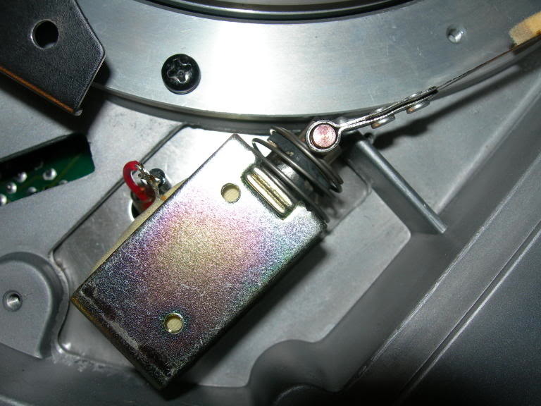

After quite a long search, I've managed to find a complete braking system for an SP-10 Mk.II on Ebay, with the added bonus of a (supposedly) working strobe light too. £70 so rather an extreme price, but it's all advertised as working, and I guess these spares are pretty rare now. It'll be nice to finally have a 'complete' deck at last, as my SP-10 had the braking system removed by its last owner.
Unfortunately the braking solenoid needs some work by the looks of it. It needs cleaning, a re-lube, and the rubber end-stop washer (part 14-4 in the service manual) isn't there.
I assume I can use a bog standard rubber washer of appropriate size there. Does anybody know the thickness of this item though, and the circumference? Also I haven't a clue what kind of grease I should use to re-lube the solenoid - any advice here would be much appreciated indeed.

I looked through my disassembly photos to see if I could pinpoint the washer you're looking for but unfortunately came up empty. The above photos is as close as I can get to the brake solenoid. For whatever that might be worth.

Managed to find a slightly clearer photo of the whole unit, and looking/measuring the solenoid shaft the inner diameter is approx. 10mm, the outer 15mm. I shouldn't think it's too critical. Have ordered a few rubber washers and hopefully one of them will fit.

I'm a bit late to this thread, came to it while doing a google search for pics as I am doing a bit of an overhaul today. John, i noticed in your photo there is a circlip missing where the brake strap connects to the solenoid. There is also one on the other side. Not sure whether you had not yet replaced it, or didn't know that there are circlips.

I removed the band brake mechanism from my SP10MK2 because when in brake disengage mode, there is rubbing between the cotton felt and the platter. I can hear this rubbing using a stick to the TT chassis.
When I adjust to de-tension the band brake so that it won't rub, but end up with no braking effect when the STOP button is press.
Now my SP10MK2 is so quiet when spinning, you may want to consider this option. Rather than spending so much effort to get your brake mechanism working and ends up have this rubbing issues.
also when adjusting the band, sometimes you have to try the "wrong" way, so it may seem like it needs tightening when loosening it a little will actually be the right move and vise-versa ... I managed to get mine silent without any rubbing and I was a complete novice ... (JP is right ... "bend the band back in to proper shape" ... or as close as you can possibly get before refitting and adjusting) ... but I guess if your band is too badly beaten up it may not be possible. ..... When I ran the deck without the brake, I missed it.
