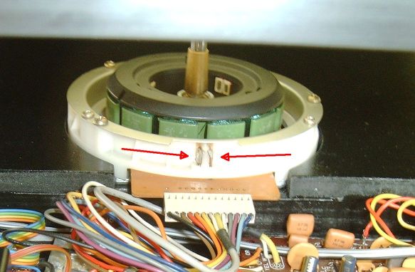

had that same prob with my SL5210 which utilizes the same Chipset.
Turned out to be a almost invisible crack in a solderjoint of the FG wires to the PCB.
Resoldering the pins solved the prob.
I suggest to search around the FG and associated tracks and components.

can you provide a picture of the fg wires? I have the same problem on mine.
the FG-coil is a flexible PCB ´wound´ on the outer aluminum ring, covered by the white plastic ring.
Two pins connect the FG-PCB with the brownish interface-PCB.
Due to moving the motor assembly several times in and out of the plinth microcracks had devolped around these pins, leading to a high-speed revolving platter.
