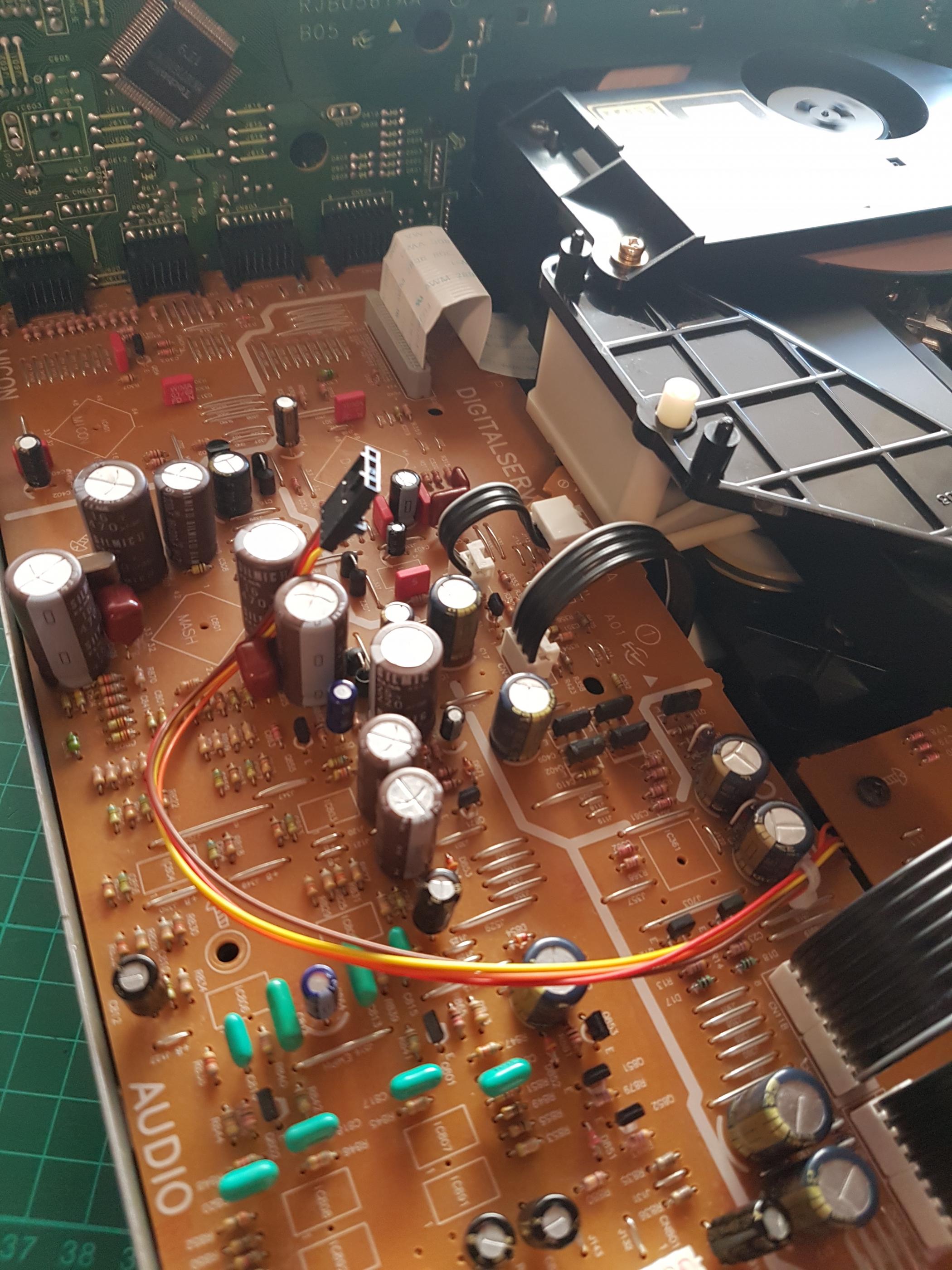

Hello StewartH3,
Yes, and the answer is simple and complex:
The perfect starting point is always with a new unit, but this is not possible with a cd player manufactured in 1993 (25 years), so I try to get as close as possible. That's why I have three units, because I want a unit in a cosmetic and functional state like new. Dismantle, clean thoroughly and oily. That is my starting point.
Then I replaced all the power capacitors, and updated the operational ones. Then I install a new clock, I put a photo.
Little else has to be done with the player.

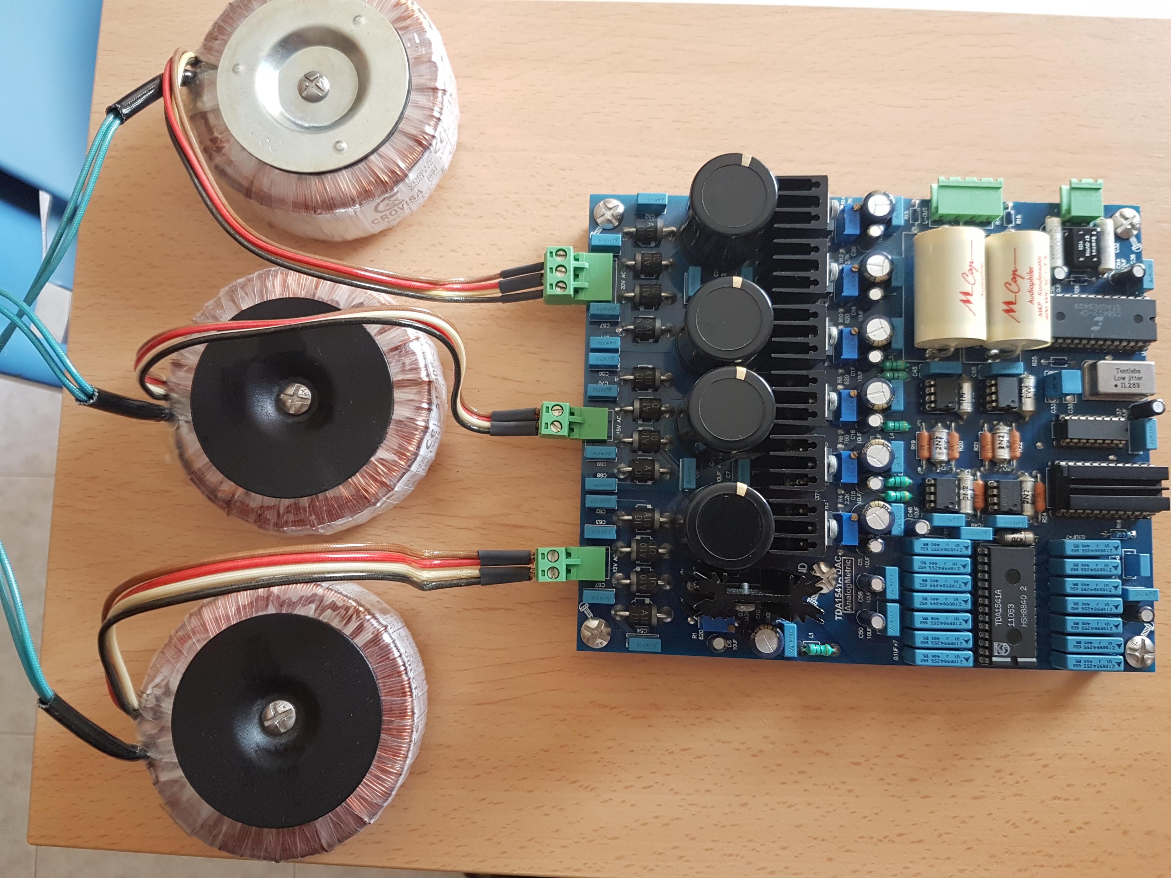

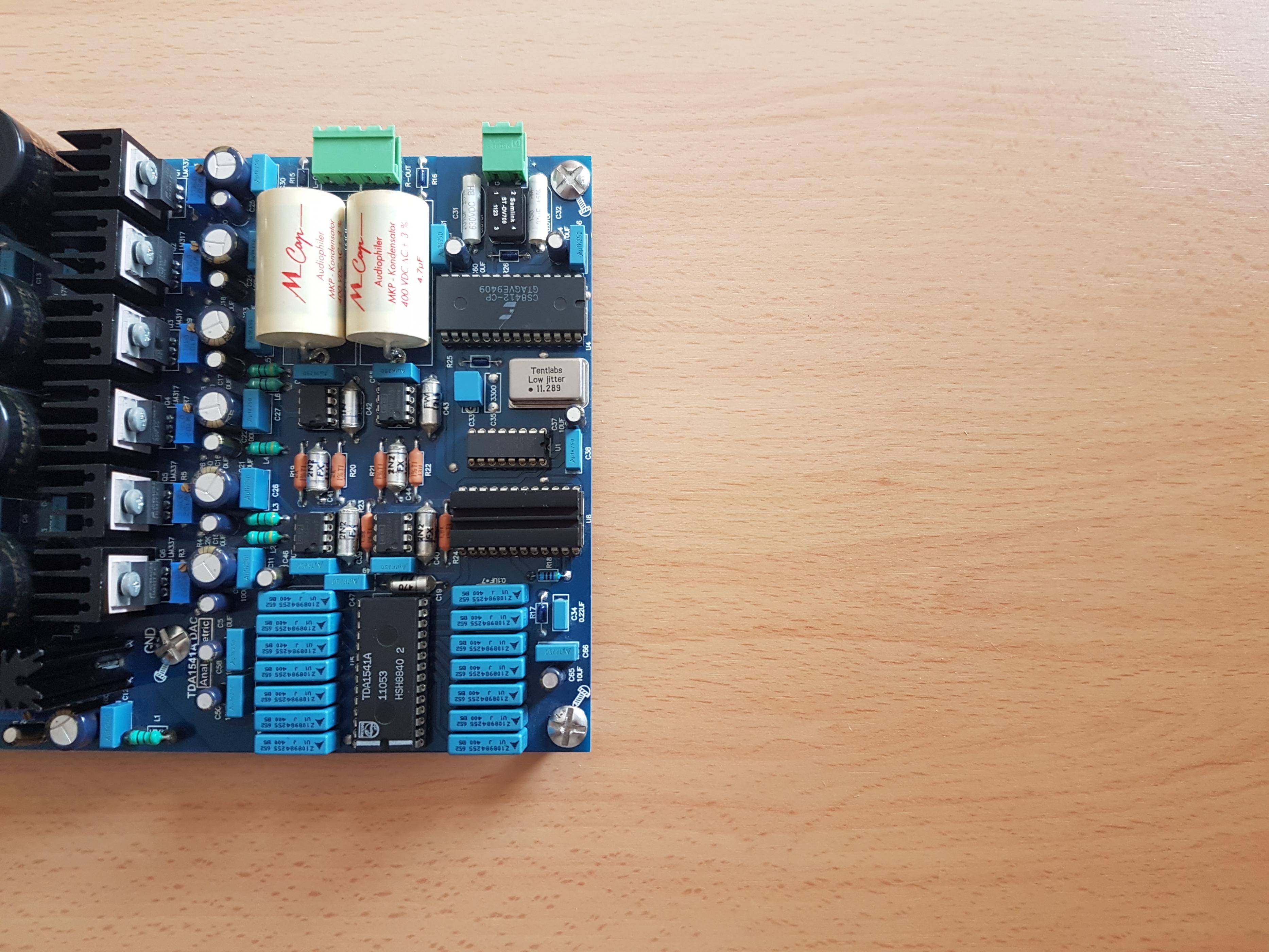

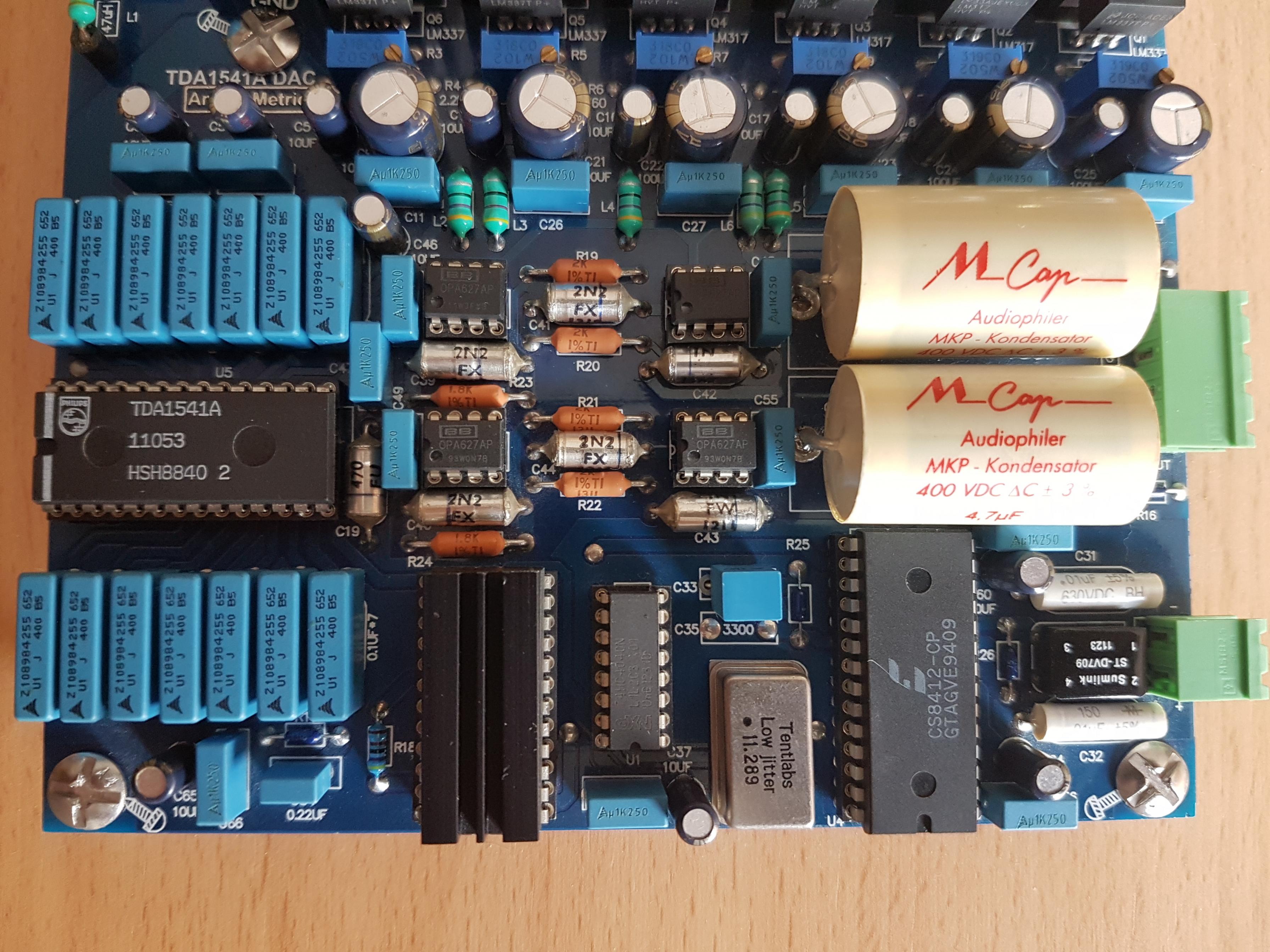

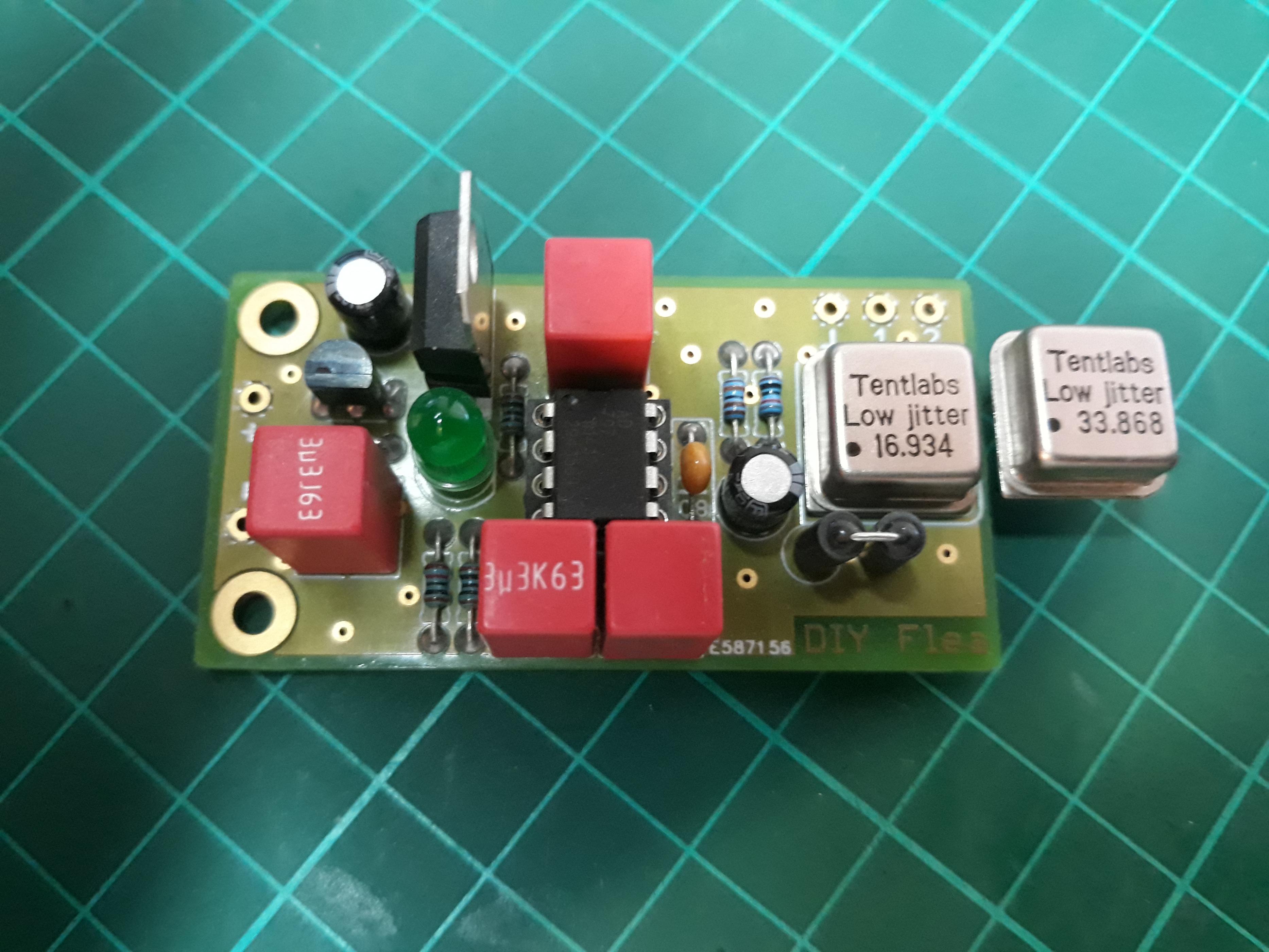

For my part I am going to add this other external DAC to my project:

t is still in development in the background, so I have left space for the output section. I'm still thinking about changes, because I've got original Philips capacitors (oranges) and original and never used ERO, in a Phillips technical service that closed.

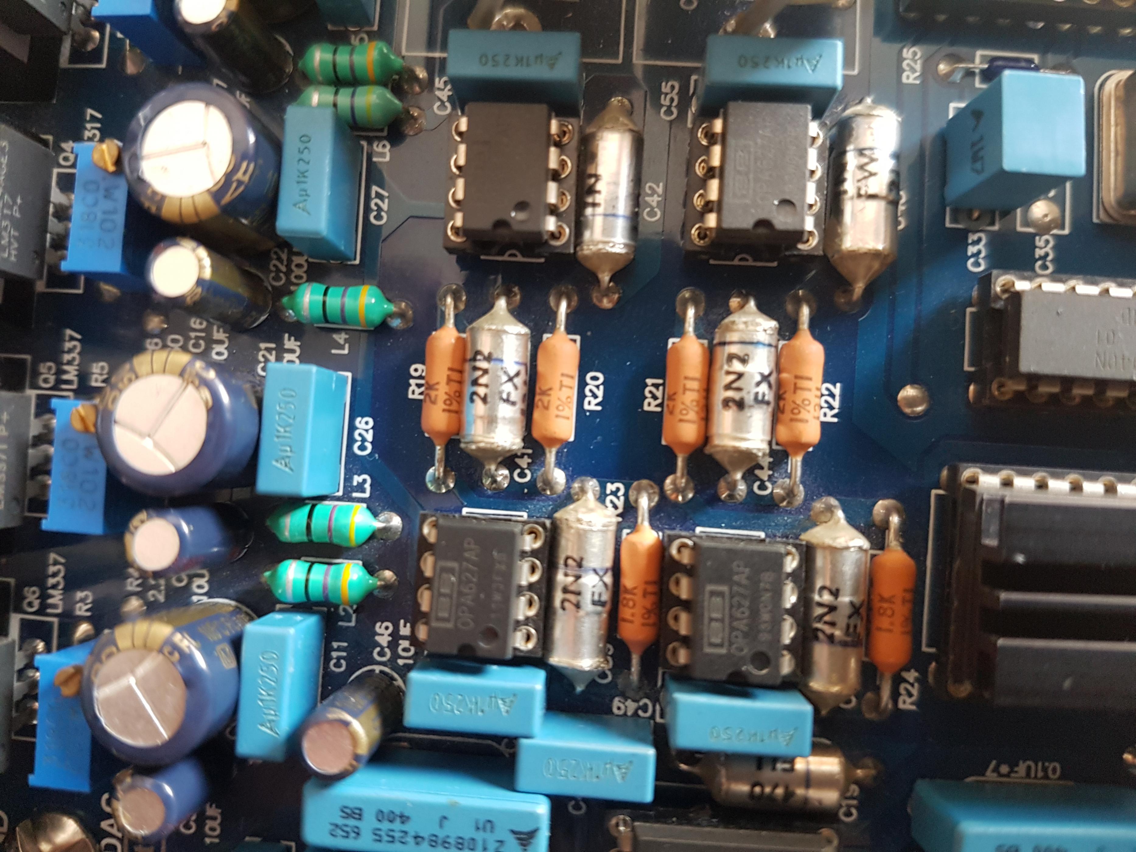

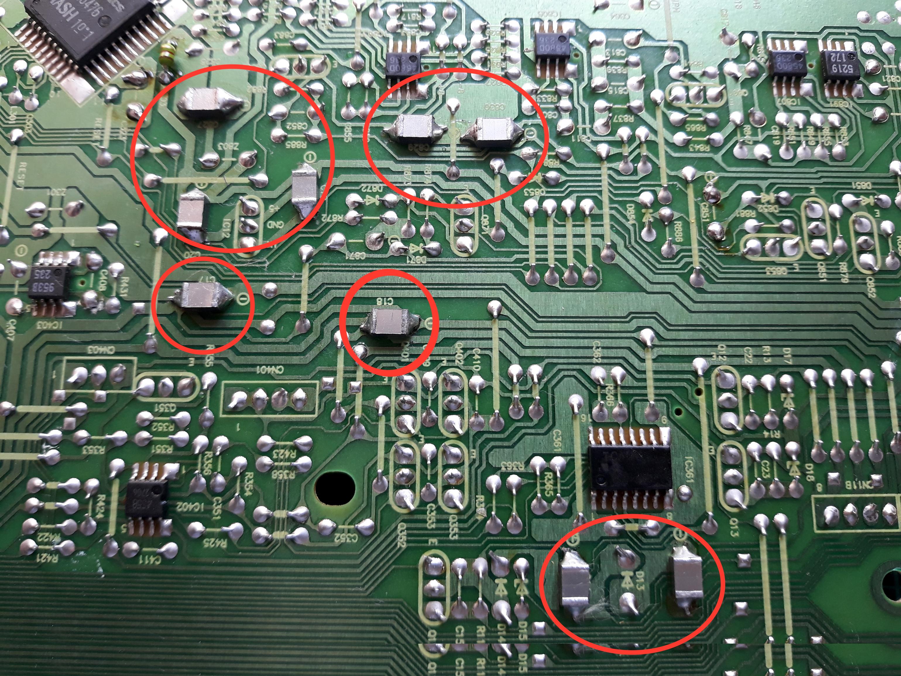

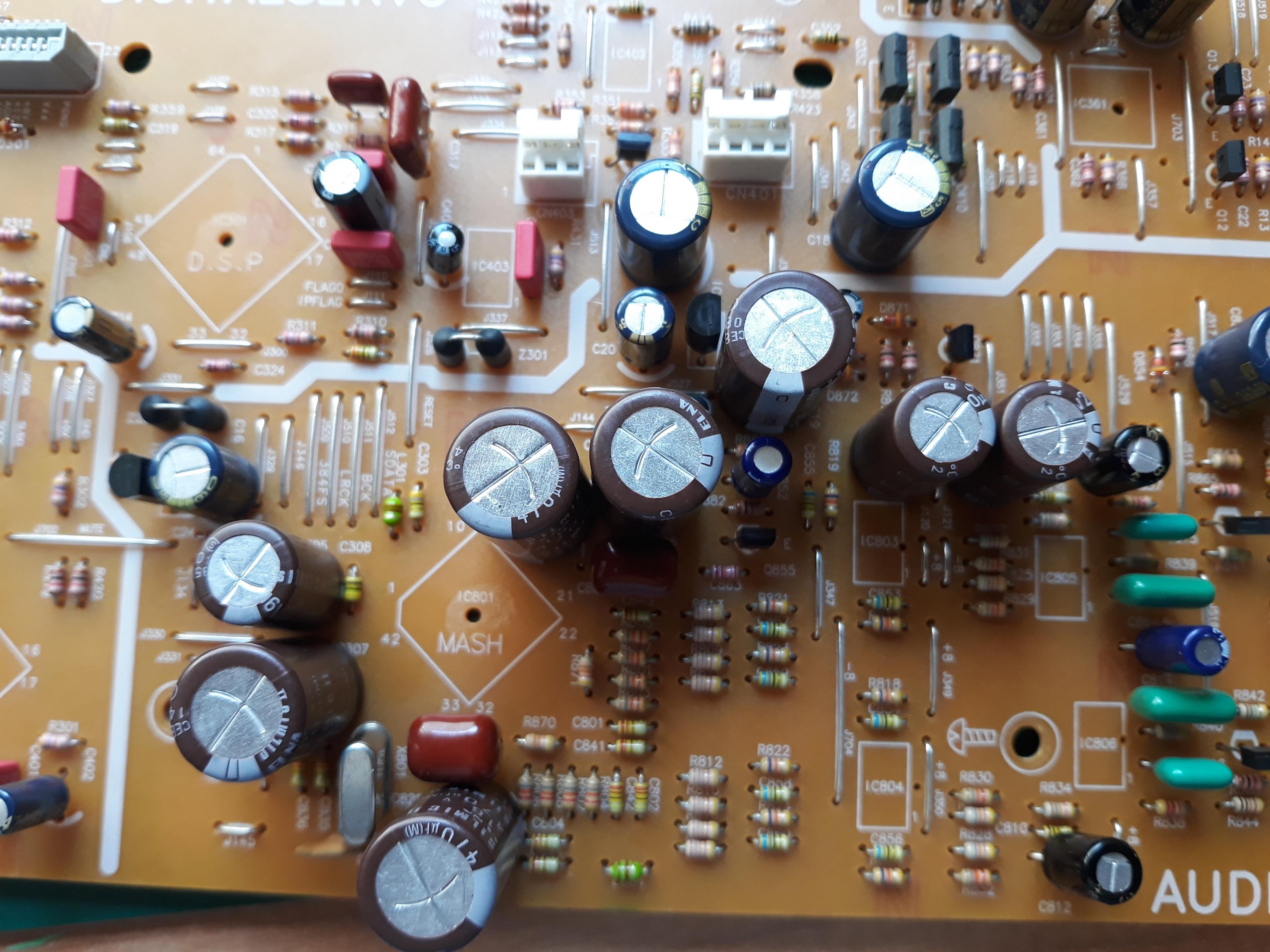

Completed the change of capacitors on the main board, in general I have respected the values ​​of all the capacitors, except a few.
For the capacitors located in the feeding sections not related to the audio process, I used Panasonic FC, I think it is an excellent choice.
For capacitors located in feeding sections related to audio, such as digital audio processor, DAC, or operational've ridden Elna Silmic II, which provide some improvement in performance of the player.
All 0.1uF ceramic capacitors have been replaced by wima the same value and added film capacitors SMD Series Panasonic ECHU (X) are shown in the picture in red circle. (I'll have to remove some of the solder in the solder)
The sound in general I think is better now, but it is a very personal opinion.
The next step is to replace the electrolytic capacitors of the power supply by Panasonic FC, here I have no doubt.
The two large capacitors of 3300uf will be replaced by Mundorff Mlytic (Audio Grade) of 4700uf. and 100nf capacitors will be added between terminals throughout the section.
I hope to receive the rest of the material Monday or Tuesday.

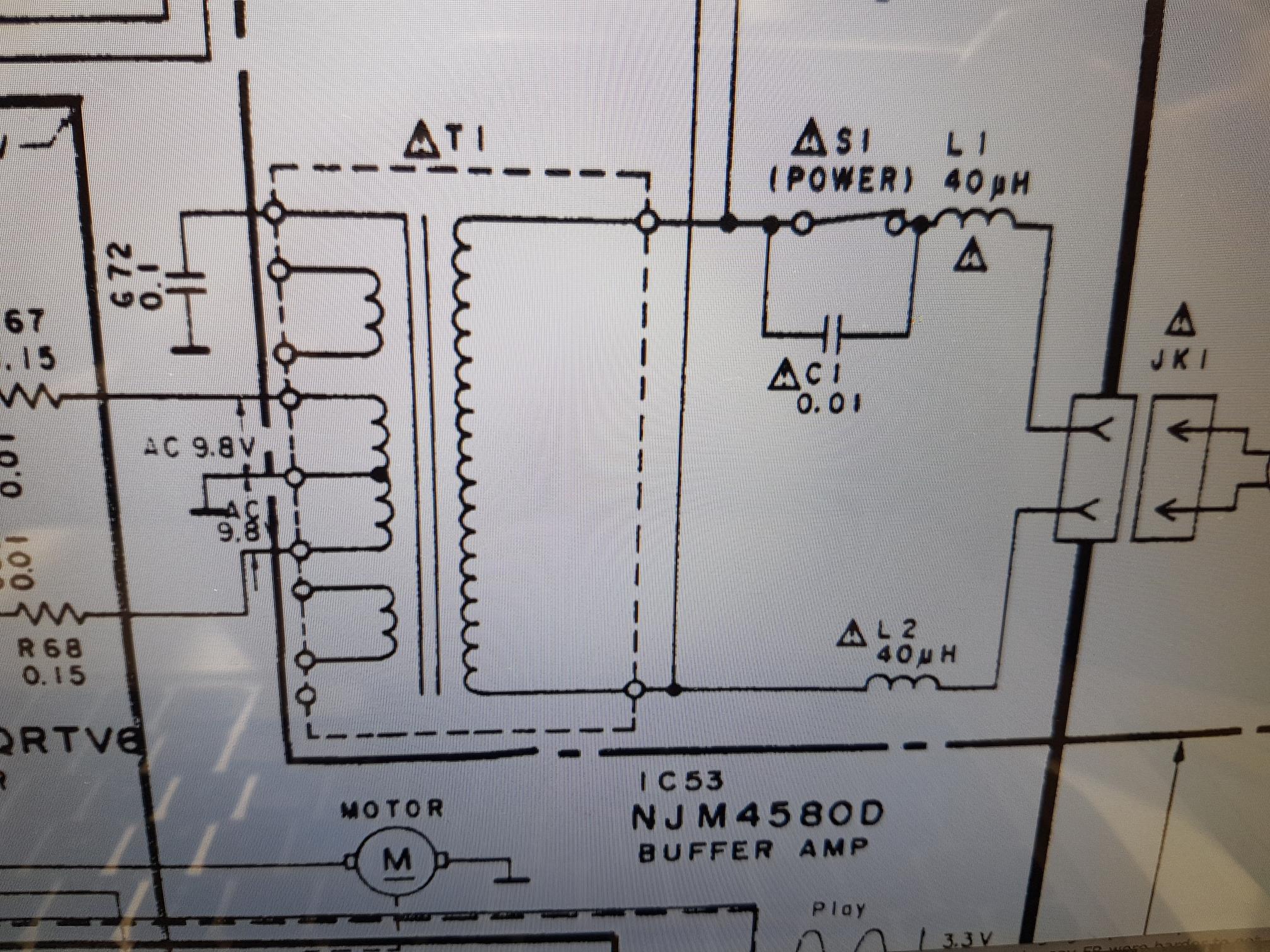

I have completed the replacement of all the capacitors in the power PCB, and I have given another "turn" to the issue of the operational, first I tried with NE5532 but the sound did not convince me: it was missing the sound, too flat (maybe for try with a bipolar doing the job thought for a jfet), so I tried with LT072, much better, but I wanted to go something further, so I tried OPA2134: too much stuck, some dynamic was missing, but good sound otherwise, so I changed the IC 807 and 808 for LT072, leaving the rest with OPA2134, and the sound was so good and balanced that I leave it in this configuration.
I have prepared the connection for the clock feed, I do not need to install transformer or take power from another circuit transformer T1, it has two free outputs: one of 12V and another of 6V from which I will obtain the voltages for my watch. Good for Technics.
In the photo the cable with the voltages of the winding of the transformer.

I finally used Panasonic FC on all non-audio feeds, I can get Panasonic FR without problems at Farnell, but I feel more comfortable with the material I know, just for that reason I used FC.
Inexplicably some power capacitors did not have their corresponding decoupling, so I added them, I think Panasonic film SMD, has been a good choice, and easy to implement. Without complications.
In all feeds related to the generation or processing of the audio signals I used Elna Silmic II, which has meant an improvement to my ears. The drawback is that they are bulky for a given capacity.
With the aforementioned operational change, and after a lot of listening compared with another unmodified unit, the sound has gained a lot, a lot, a lot.
How to say, sound more slowly, without veil, and live at the same time, I stay with this configuration without hesitation.
For the feeding of the clock, I thought to use two windings without load or connection left in one of the transformers, although I could use another new transformer ... I have to think a little more.
