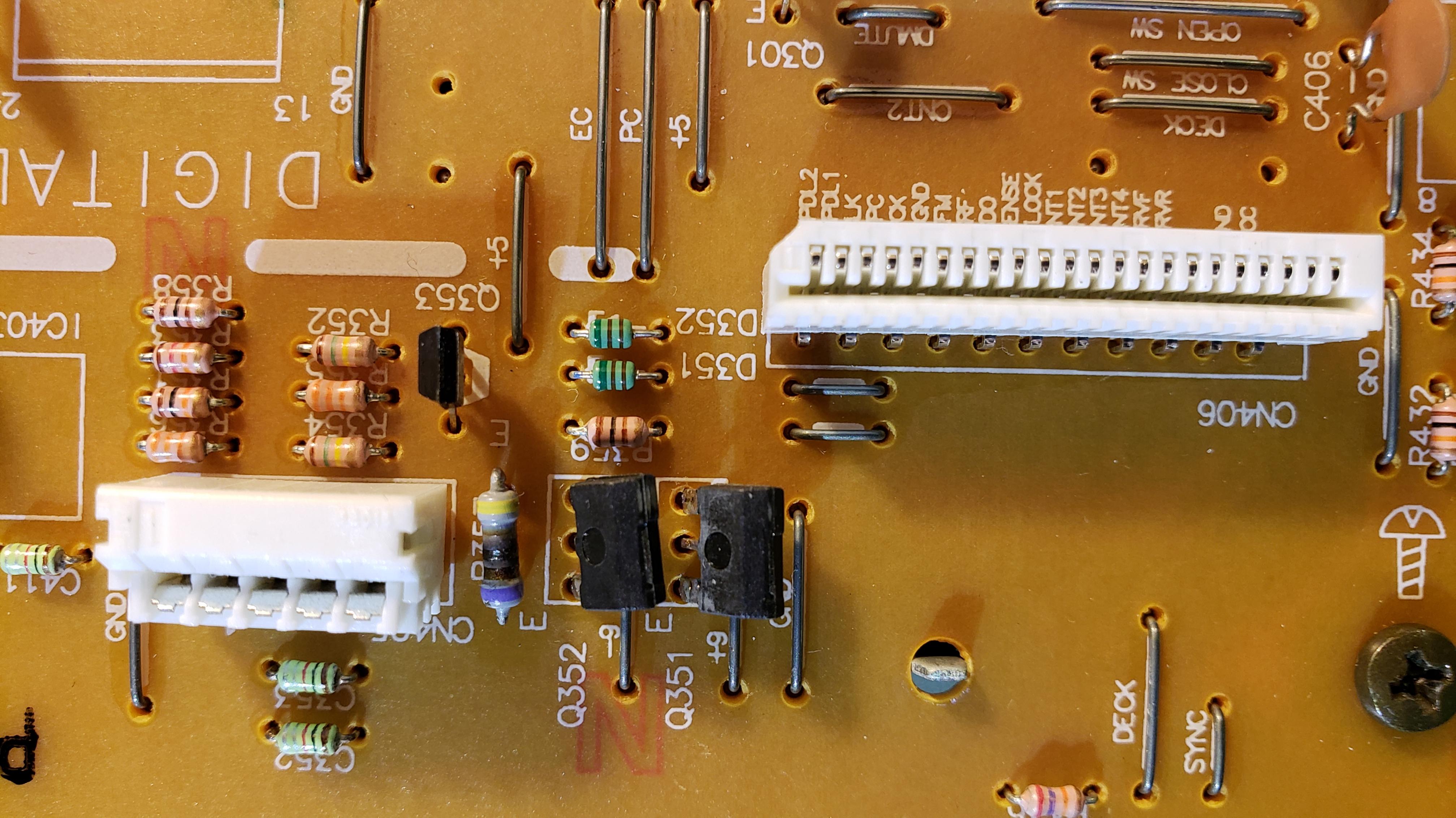

My friend gave me her technics sl-p102 cd player manufactured in 1989, which looks practically new except it was dusty. I was able to play about 10 cds, then it quit playing and the symptoms are exactly as described here.

I got lucky and was able to bring it back to life, I disassembled the drive and gave it a good clean up, but I did not see anything obviously wrong with the board under the laser.
but when I checked the main board I found a resistor burnt or half way burnt that still read about 8.1 ohms, so I replaced it with a 10 ohms, then it started working just fine again.

thanks, guys, it is running for now, but eventually I will replace those caps, the resistor I replaced gets hot, so I assume the spindle motor is drawing plenty of current to run.

not so much, the ones that draw the current are actually the focus and tracking servo, still is not that normal that a resistor heats up, can you post a picture of where is that resistor?.
also the pots rarely need adjustments, specially on those machines who used very noble materials for the lens suspensions and don't wreck with time like the plastic from sony or the rubber from pioneer
Ok, so I changed the resistor again and it burned last night after playing 3 cds, it went up in smoke.. attached is the picture.
it is resistor 357 next to the white connector.
Q351 looks bad, from what i can see the sl-p370 service manual is the same as your machine, even same names, also your burnt resistor is part of the same circuit as the Q351 and drives the spindle motor, maybe the spindle motor is bad, which is quite normal on cd players, or that transistor is failing, also check for cold joints
I checked Q351 and it is good, I checked both pairs of transistors for the loading motor and spindle motor and they all tested the same good. so I replaced the burnt transistor, and it is playing as I type. so I think your right the spindle motor must be failing as Q351 and Q352 do get very hot. so I am done with it. thanks for your help PC91.

you can try replacing it, is just a regular dc motor, or you can leave it as donor for a higher end machine, lots of higher end machine used the same mechanism and you might need a laser or servo board
I re-flowed several joints on the drive transistors and resistors in the area, as you suggested and it started paying right away. so maybe that was the problem. as now the transistors do get hot during play and the resistor is not burning up. but I will play it more tonight to see how it goes.

So good! also check for cold joints on every component subject to stress or heat, power regulators, phono jacks, etc..
Well, it finally died, it won't spin anymore at all. so I'll use the main board for parts. haha...
