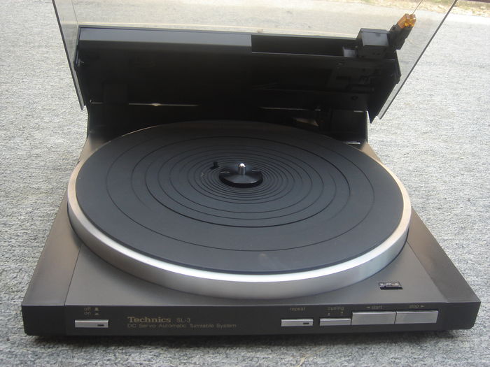

Technics SL-7 Latch Repair and Refurbish

The SL-7 is basically an SL-10, but without that model's built-in moving coil cartridge preamplifier. The SL-7 has less aluminium and more perspex than the SL-10, so you can better see the LP spinning.
There's not so much information re servicing the SL-7 out there, but there's more (including videos) on servicing the SL-10. In consequence, it's worth taking a look at the SL-10 for helpful servicing tips.
The motor in the SL-10 is different to the SL-7. The SL-10 motor is similar to the SL1200, whereas the SL-7 motor is a coreless design. Better, in my opinion.
