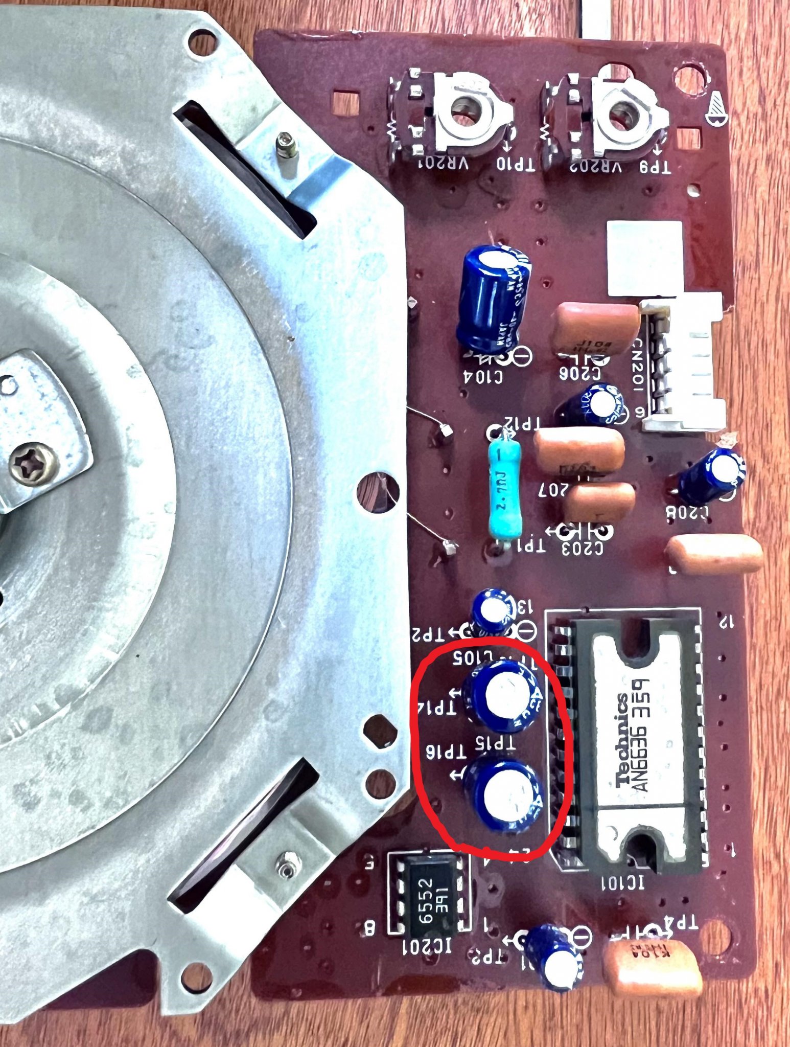

I recently acquired an all original Technics SL-6 at a bargain price. It performs well but not flawlessly, and a quick check of the electrolytics suggests their replacement might be a good idea. Considering those caps are now pushing 40 years old (the plastic cover has a 1983 date code), it's probable that they're now at the ends of their operational lives.

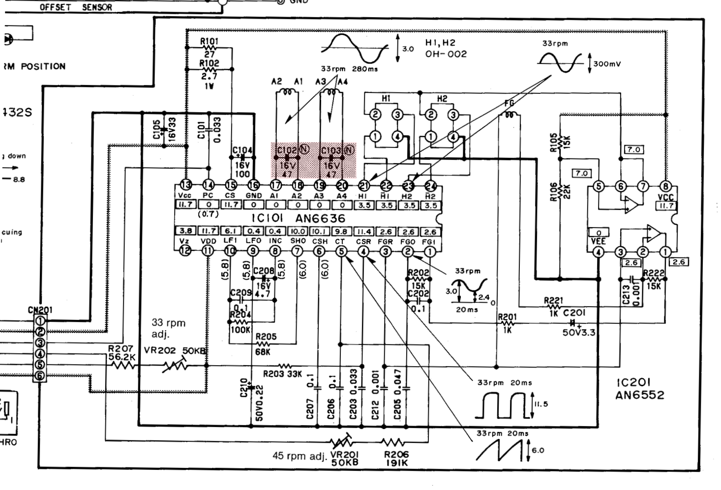

Ordinarily this would be a piece of cake, but there are two 47 uF 16 V non-polar electrolytic caps across the stator coils as shown in the attached files. There's no exact replacement available at the usual suspects (Mouser, Digi-Key, etc.), so as I see it, I'm faced with executing the least worst of several unsavory options. They are (listed in no particular order):

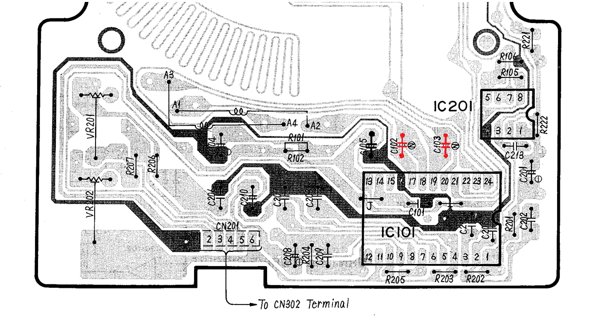

I agree with the option 5 as more effective, but trying to solder it under the PCB as it would be a SMD. No need to solder any wire. My opinion only: I did it several times when replacing starting capacitors in SMPS by the newer MLCC directly under the PCB, in the same site as the (erased) old lytic.
That's where I was leaning, but without considering the possibility of mounting the replacements on the reverse side (D'OH!!!). That's an excellent idea, but I doubt the space will be available because that board is mounted upside down with the reverse nearly flush with the top deck. It's worth measuring to be sure, though. Thanks!
It seems to me from the second pic that nothing is under the caps on question. A MLCC cap will use +/- the same space as the solder blobs plus the wire remanent underside. In any case you can put 3 caps of 15uF in parallel along the tracks removing the solder mask (if any) and 15uF units surely are smaller than 47uF.
Will do! I compare the geometries between the old and new as a matter of course. Normally the spacing between components on '70s era equipment allows for ample adjustment for newer components, but this turntable is particularly tight (even considering the reduction in part sizes over the past several decades). BTW, that photograph to which Osvaldo referred is deceptive; I photographed the stator assembly it as it lay on the workbench after removal from the unit.
