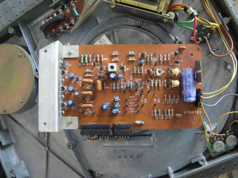

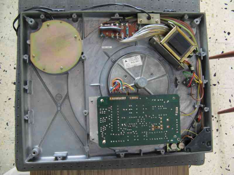

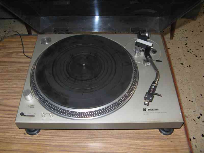

I think I have a problem. My machine is a SL1200 with an EPA120 tone arm . A picture is attached.
The service manuals of the SL1200 that most of you have, shows the area under the platter as removeable and exposing the circuit board etc. In my unit the area under the platter is part of the moulding and not removeable . None of the service manuals I have come across so far have shown this model.
Is there a service manual that shows this model ?
So do I have to open up the bottom cover to access all the boards ? A bit inconvenient to do that I guess.
There are a few screws on the chassis around the motor . Wonder what that holds. I don't want to remove anything without knowing what it does.
I forgot to mention that the platter mat is a thick black material and possibly rubber ! It's very hard right now . Is that the way it is or has the rubber ' dried up ' ?

You have a SL1200 MK 1 Turntable. Quite a bit different from the MK 2 version, both on cosmetics and electronics.
I opened up the bottom. Looks a bit like it's from the stone age !
Well the good thing is that it probably is easier to fix !
I cleaned all pots and connectors and put them back to the original position. I haven't yet looked at the various signals. I would have liked to see a block diagram . Must go over all the other service manuals to see if any info is useful.

The mat is not the original one. It's an SL-1200MK2 mat. That's a thick, hard mat indeed. I don't think it's bad though. The original mat is the same as came with the SL-1300 (MK1). Its thin, soft and has a lot of concentric ridgjes that collect dust. 🙂 See these pics:

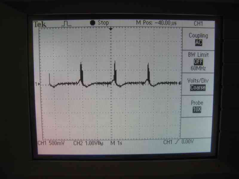

Hi Guys,
I discovered that the power supply rail ( with positive ground !) seems to have 1 volt pulses on it spaced about 3 to 4 seconds apart . This is related to the speed fluctuation . It's not a constant speed error. The speed varies around the correct value.
Strangely if I apply pressure on the turntable to slow it down with friction and then slowly release the friction , the platter comes up to speed and stays correct and the power supply rail stops having those pulses. The album then plays normally. However if I stop and start again the problem appears again till I do the 'friction operation again '.
Any ideas what could be wrong ? I changed most of the electrolytic caps including the power supply cap ( up from 470uF to 2200uF ).
A scope shot is attached.

A quick update.
I replaced all film and electrolytic capacitors and three transistors that showed wrong ( low ) signal levels. Transistors were BC equivalents of the 2SA types and some elcos were larger than the original.
Now the machine works perfectly ! Thanks for all the suggestions that some of you made.

So I replaced the AN6680, but it did not remidy the problem. It did make the table run a little more stable but I'm still can't get 2 tables to stay in sync when trying to mix. I've worked with many others 1200's so I do have a point of reference. I suppose my next step will be to replace the crystal. Btw, I have checked the pitch control settings with a voltage meter and everything is coming up good, so the pitch control is not thie issue here. Just wanted to give an update on my experience.
A few more tips:
Check if transistor Q201 and surrounding resistors are well soldered.
If you have a frequency counter, with platter removed, and motor active, check TP27 for a stable 262.08kHz.
