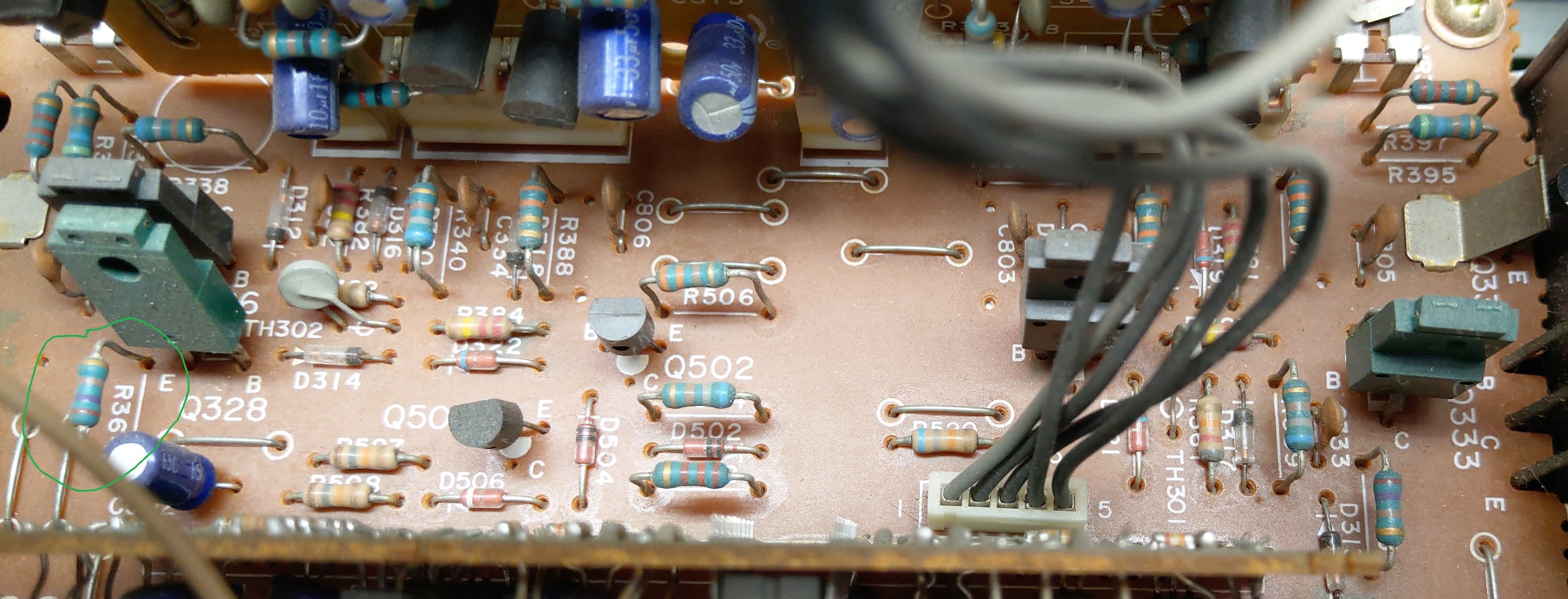

I have a Technics SE-A70 that I'm restoring. I have restored several other pieces, however this is the first piece that I'm having trouble with. I'm learning as I go.
The issues:
The amp was working(ok) but the main caps were leaking. So I did a complete recap. During the reassembly I somehow didn't install a mica insulator for one of the output transistor... This of course caused major problems. What I have done so far to fix it:

After all those parts were install I used my DBT to power the amp on. Shortly after power on the R364 resistor burned out again... So I have obviously missed something but what is the question? Any help/ideas on were to look will be greatly appreciated.
I have circled the resistor in the pic(pic was prior to recapping).

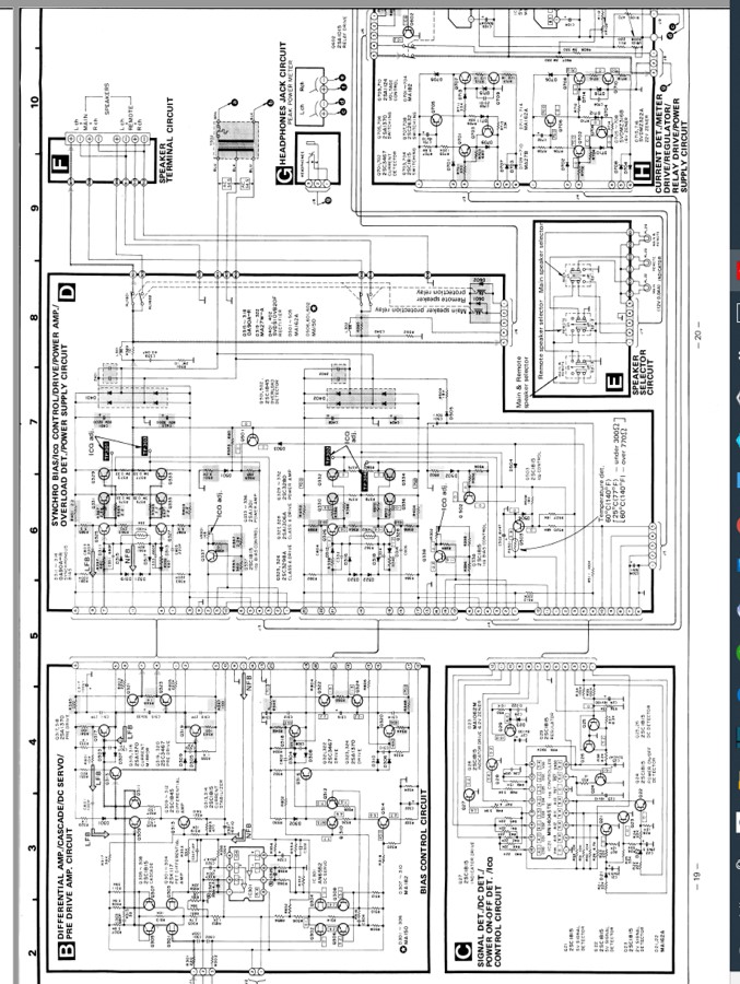

These didn't come in often, not to say never. I'll have a look at the ServMan tomorrow (print-n-gluejob).

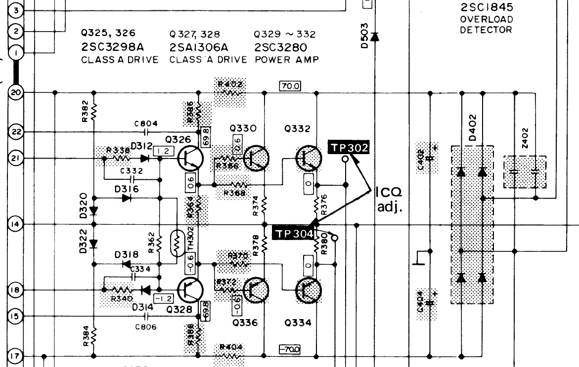

Check again on Q330-332-334-336 and Q326-328.
Raise one of the legs of R366-368-370-372 from the pcb and notice the results.
Either the bias is way to high or extra current runs through R364 from somewhere. There are not so many candidates in that location.

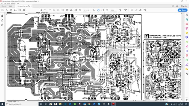

Further thoughts, an earlier issue on this forum.
Check on the pre drive pcb:
Q318-320, Q322-324, C312-314, R342-344, R350
On the output pcb:
C804-806
In general check all voltages across the circuit as indicated in the ServMan.
