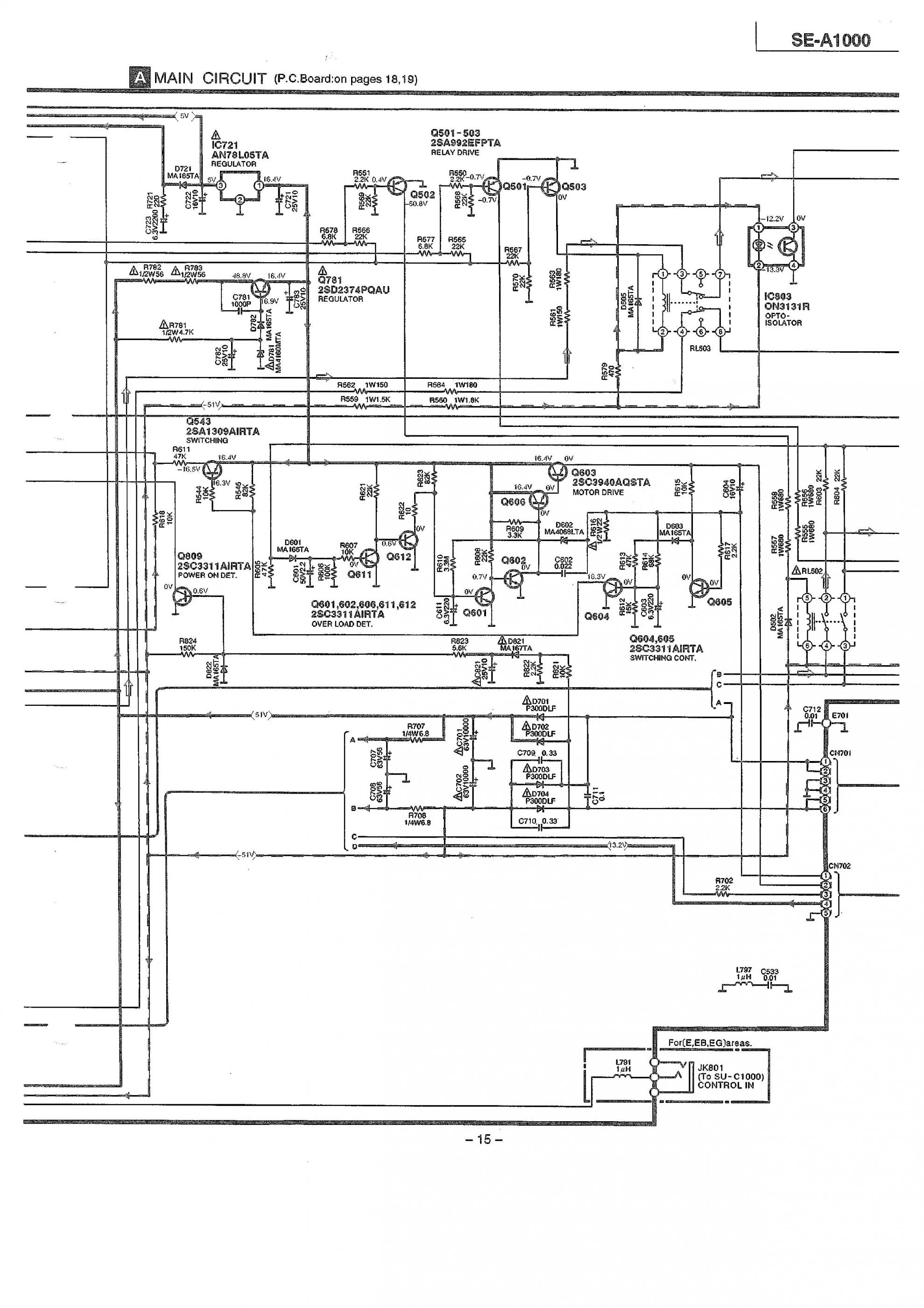

So far I have measured one and another. Started with measuring the voltages from the PSU and that appear all to be OK.
Next thing I checked the rectifiers D701 - D704. I had some notorious reading, but since there is a capacitor parallel on them, I took them out circuit en tested them all 4.
D704 failed on forward and backward. It is shorted.
Now I want to know why the D704 has failed on me. Is it because another component or just broke down and it will be an easy fix?

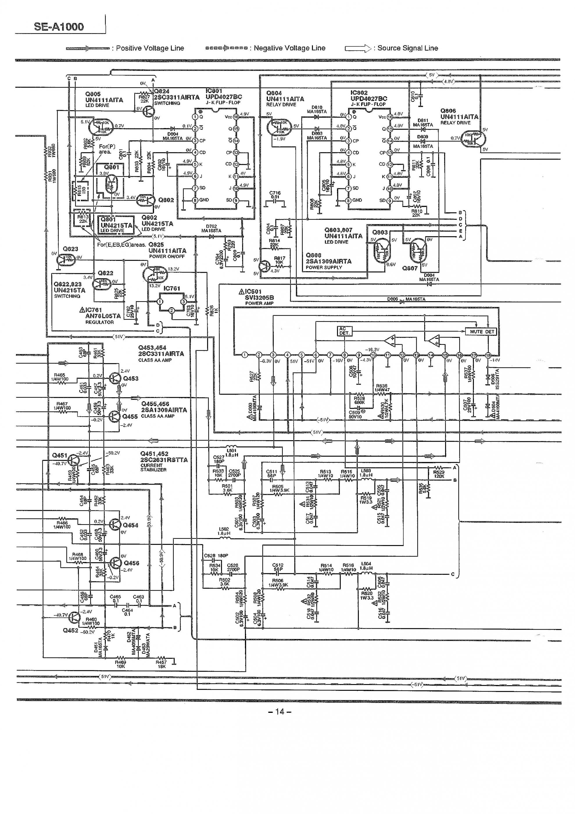

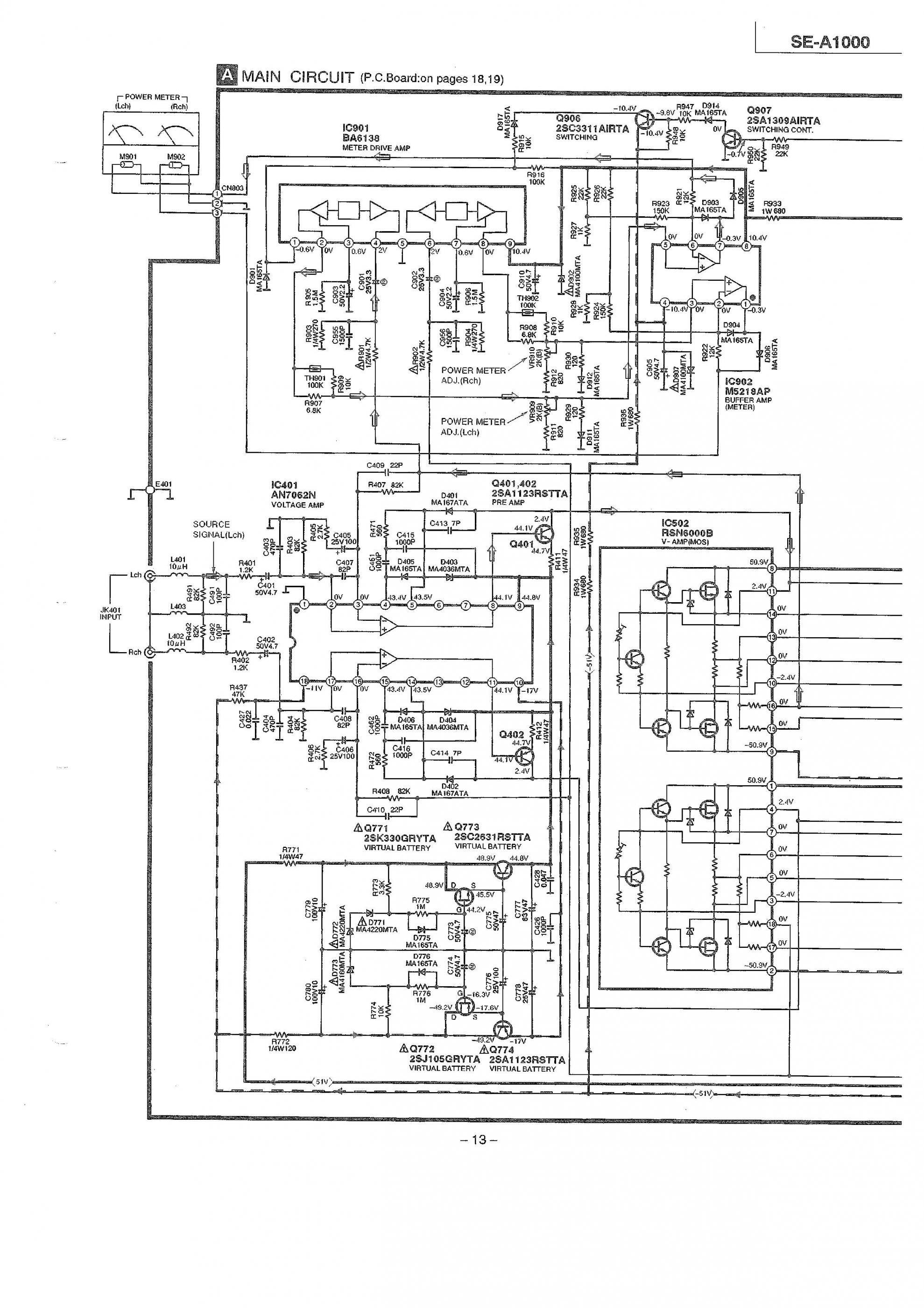

see attachments. It consist of 4 pages. Page 13 - 16
So I started on page 16 and ended up in page 15

Mmm check voltages to AN7062 to start
Check also these points.
Collectors on Q401, Q401 (2.4V)
Collectors Q451 Q452 (-2.4V)
Pin 6 and 13 On RSN6000 (0V)
SVI3205 Pins 15, 13 Inputs (0V), Outputs 3 and 6 (0V)
All voltage readings are between measured point and ground.
