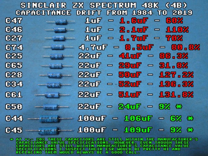

I always learned capacitors degrade in time. Or is it something different in speakers compared to power outlet current?
I searched the net and a quick search shows drifting capacitors. But this is for ZX Spectrum computer. But it will give rough idea.
EB3Fj-PXkAAfX2q
But your speaker crossover value may be drifted or not only measuring will tell.

Did a search on the net also and electrolytic capacitors do age... After 30 years they act like a resistor.
