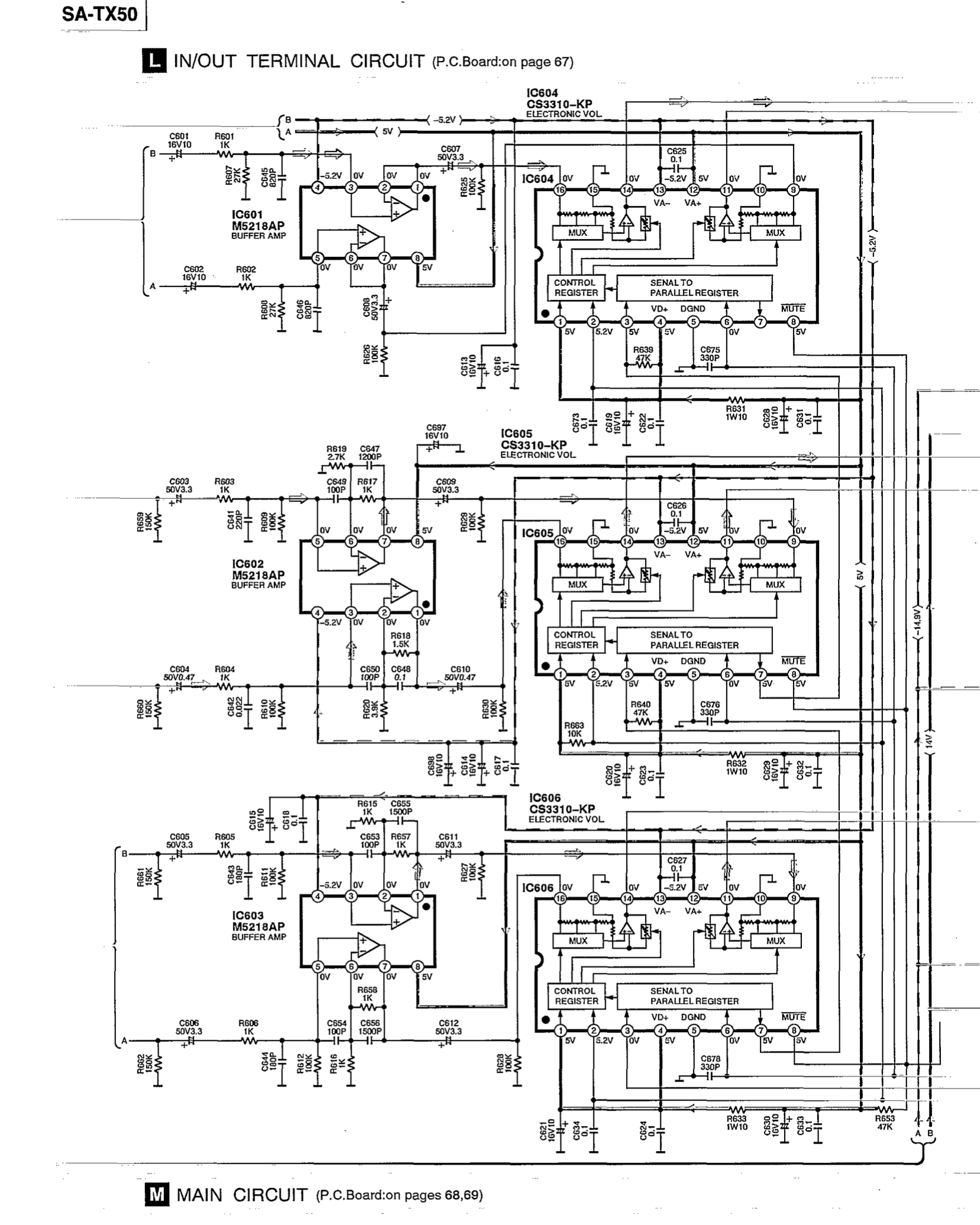

I just got my hands on a beautiful Technics SA-TX50. I've been slowly building my setup, and while this is not the king of all amps, it's the best I've had.
My issue is that it has a constant hiss! It doesn't matter which input is selected or what power outlet I'm plugged in to, it constantly hisses. The hiss gets louder as I increase the volume and can be heard faintly behind the music when it's playing. I have tried reseting, plugging in to non-grounded power bars, plugging in different inputs, no inputs plugged in at all, it always hisses!

I would isolate the electronic volume controls as there is no issue after that section so changing lots of innocent capacitors is not the way to go.
Follow the signal back into the buffer amplifiers IC501/2 & 3, that will tell you of the hiss is before that point.
Use the service manual to follow the circuit back through from vol control to the input switching.

This unit is rated at an S/N of 70 dB at rated power. Ouch. This probably refers to 300 mV of input sensitivity, so for 2 Vrms we may be able to expect 85 dB. Still no great shakes. This, I assume, is largely the fault of the non-bypassable DSP section, with ADC and DAC dynamic range rated at 100 dB each (so that's 97 dB under ideal conditions and with a following wind). There may be further screwups.

That's not going to help either, but it seems your noise is mostly coming from before the volume control at this point.

Hi Folks - An update! I had a very respected audio repairman in Winnipeg, Columbus Radio, look at the unit. They replaced 20 capacitors in the digital board and the unit sounds way better now. No audible noise between songs until the volume know is near 3/4 of max (generally to loud for even loud listening).
