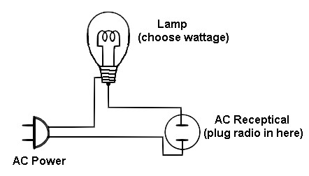

Built with secure and safe form electric shock.
Member here showed this pic.

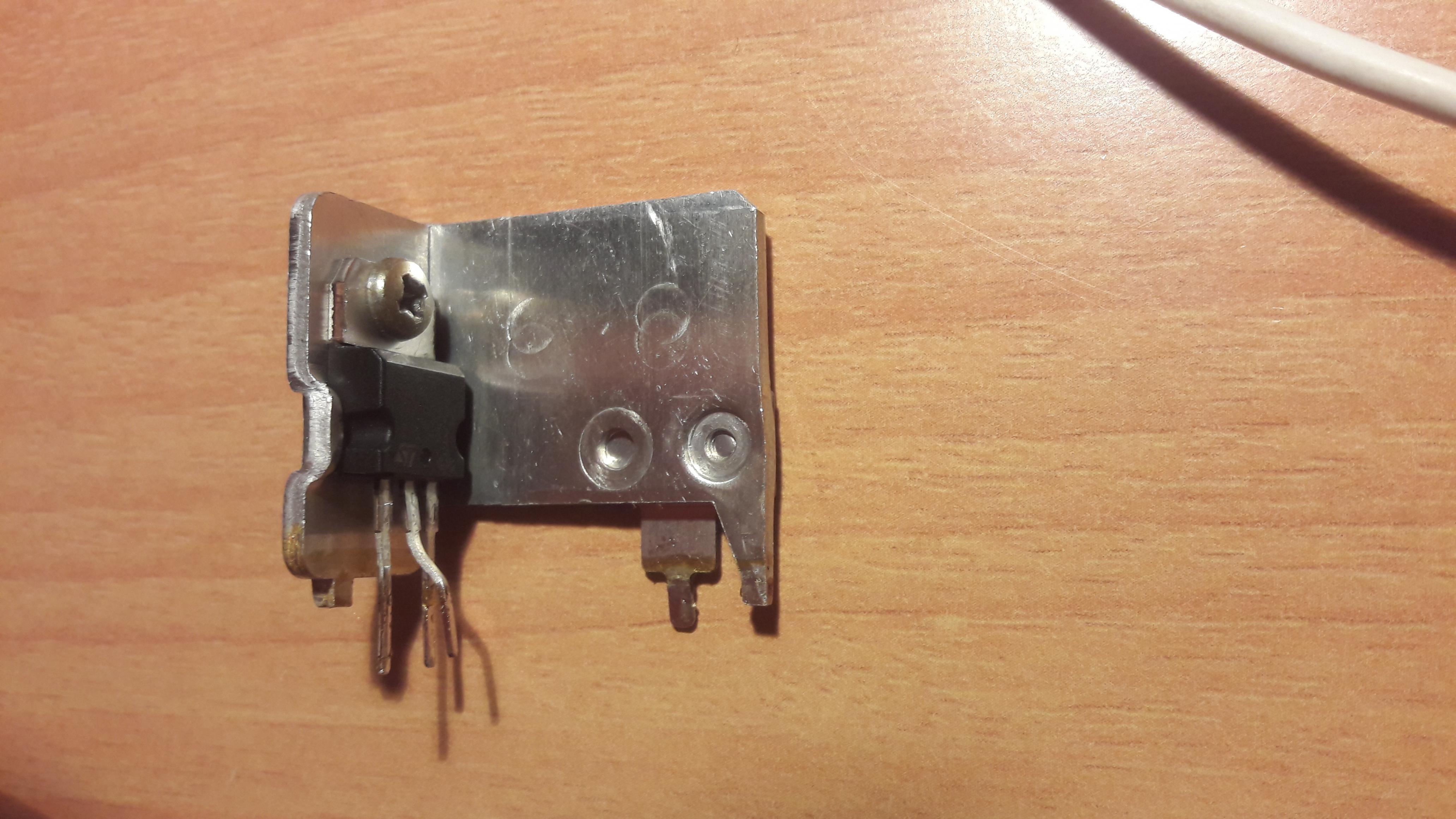

How to install a To 220 transitor, same as this video, you need a mica insulator film and a screw insulator the white plastic ring.
After install the transistor, please measure the transistor pin C(middle pin) does not short to ground.
YouTube
This is how my heat sink is looks like... But i removed it and i have the same reaction. I don't think that this is the problem... :sorry:
I have to tell you that the only fuse that i have right now for replacement is 2A/250V but fast blow. Not slow blow that was the original...
So... it was a big mistake of me and i feel sad... two cables that was supporting the analog display of frequency was naked and shorted...😡
