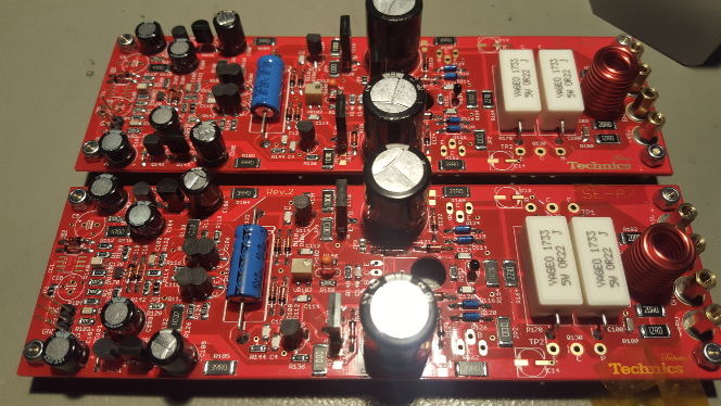

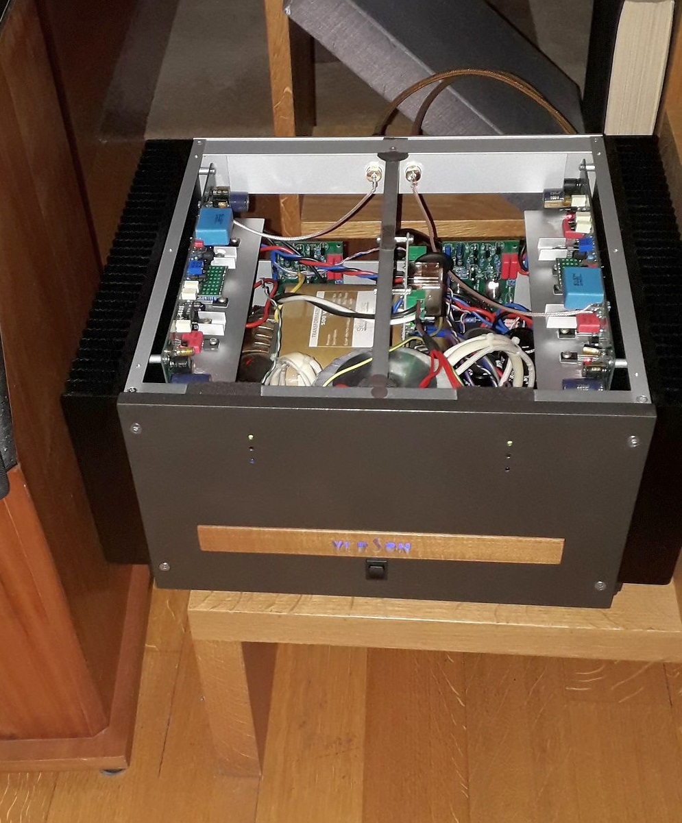

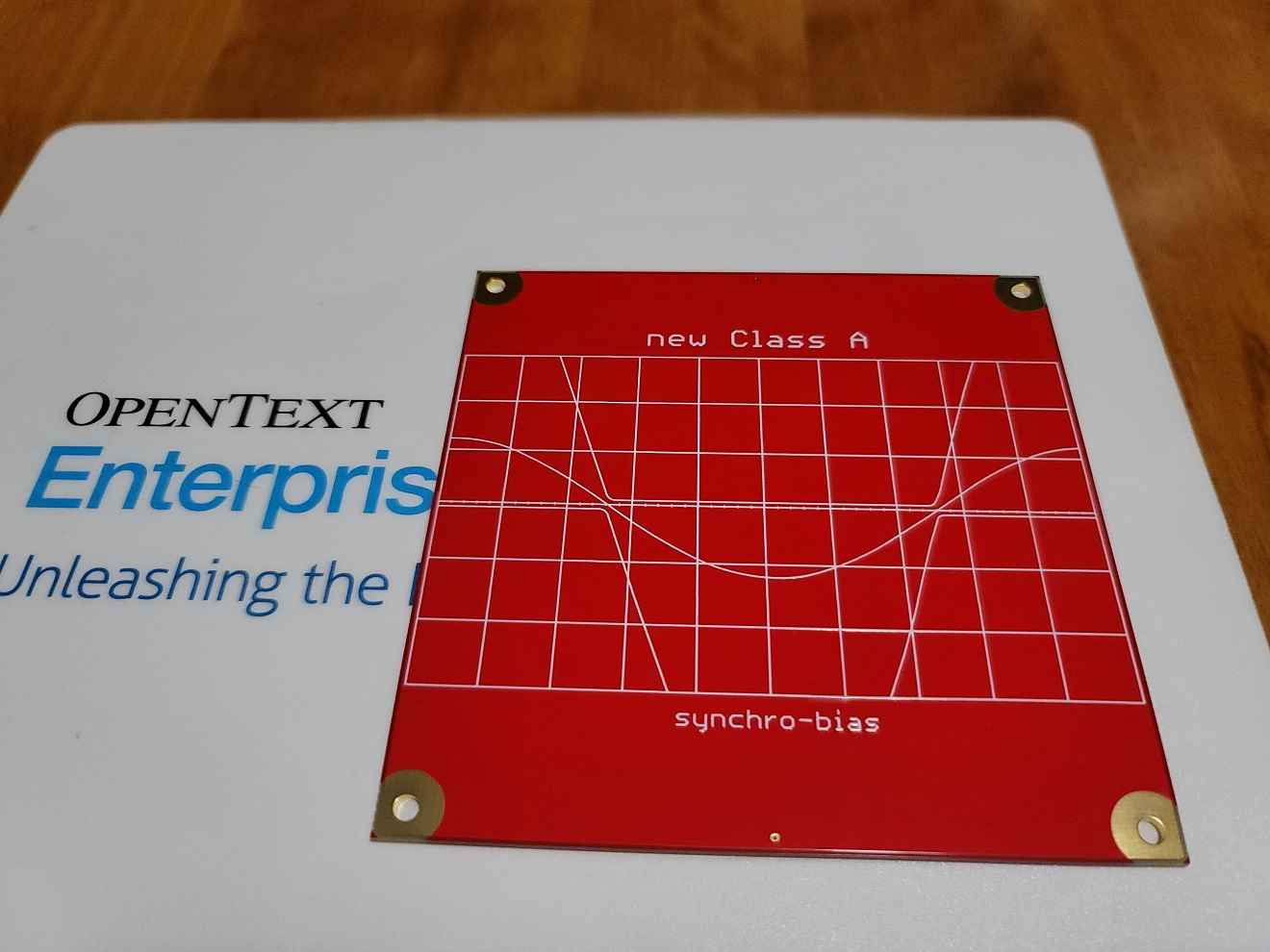

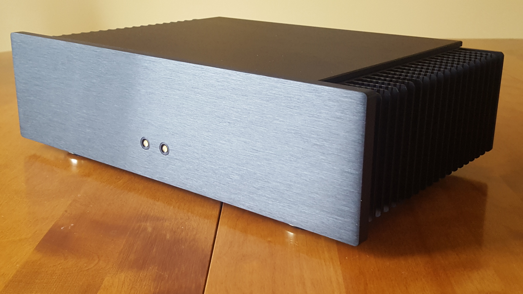

Wow, this is a real old thread of mine. Eventually I just went ahead and build a replica of a SE-A7 and SE-A5 using MT200 transistors and other Japanese made goodies for myself and a friend - for the fun of it. 4 Layers were not needed, I managed to get away with a two layer boards having only a single routing layer.

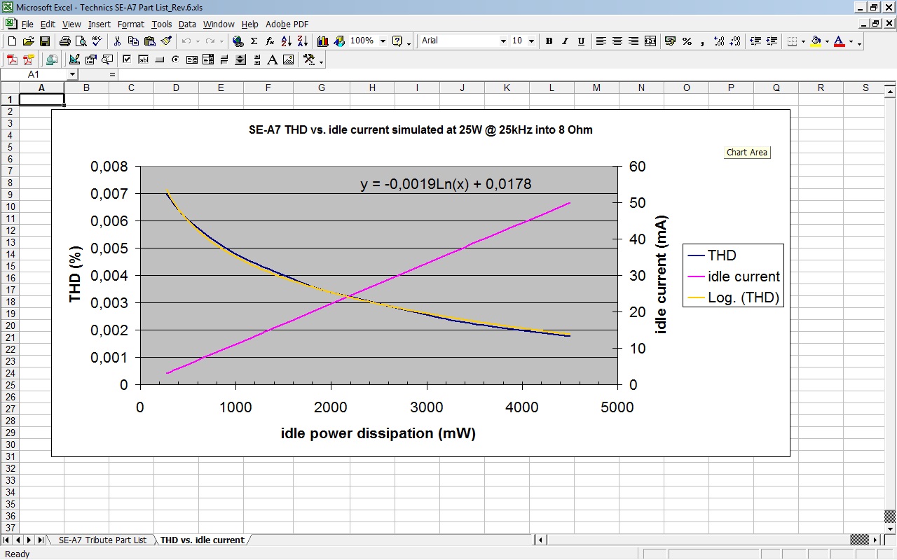

Initial simulation results were encouraging.
I did not use the old paired diodes as they are virtually impossible to get. But there is a modern replacement for these. These diodes are dirt cheap so I bought some bulk and found many decent matches easily and still have plenty of life time supply.
Well, I would not necessarily say the circuit is very complicated, unless you are referring to the SE-A100, which is a different animal all together and a bit more complex than the usual but in my books it is the cream de la cream what Technics had to offer to date. (and yes, I am working on a replica of this one too, but this is a longer project ongoing)
Today Technics does some abysmal stuff with 0.5% THD and call it a new high performance standard. - really sad story. -
They did things a few magnitudes better in the 80s than what they come up with today. I guess all real engineers retired and today's wannabe engineers who think they know it all have not even gotten a faint clue. But at least they use GAN technology - so kool.
Yes, the sound is the most important feature. My replicas, as far as I can measure and tell by A/B comparison with my well kept SE-A5 is the same. Massive bass, well defined mids and brilliantly crystal clear highs. Pretty much describes the SE-A sound on a decent set of speakers like, DSS-9, Tekton or Dirty Omen Weekends and with a decent sound source of course.
One obvious observation, the amplifier remains remarkably cool during operation while providing effectively Class A sound.

My A7 replica, uses mostly SMD components, but all power stuff is still TH. I also used this opportunity to cleanup the original wire-mess that one can find on the old Technics. Mine only has one cable and that is used for the input signal, everything else is a direct board to board connection. Turned out reasonably clean I'd say.

yes, I am following your work with interest, absolutely exceptional work I might add. Thanks for pointing out and highlighting your work on that end. Initially when it crossed my mind to build a Technics clone, I was not aware of your work at the time. So I ended up replicating the original Technics design with modern components and with a few minor tweaks. As you might have seen my 5 channel A5 and my stereo A7 Tribute replica worked out ok'ish. Both sound identical and very pleasant to me, just like the originals. I am now taking a stab at the A100, just for the fun of it. I am thinking relaxing the power spec. down to rated 150W @ 8 Ohm. I do like the concept of Class A + Class B a lot and want to try it out. I must say, while studying the old designs I realized a few non obvious tricks of the trade - the Aha effect is well worth it. To bad most of it is forgotten and most of today's designers think jacking up idle current into Class A territory fixes crossover distortion - (very) little do they know.

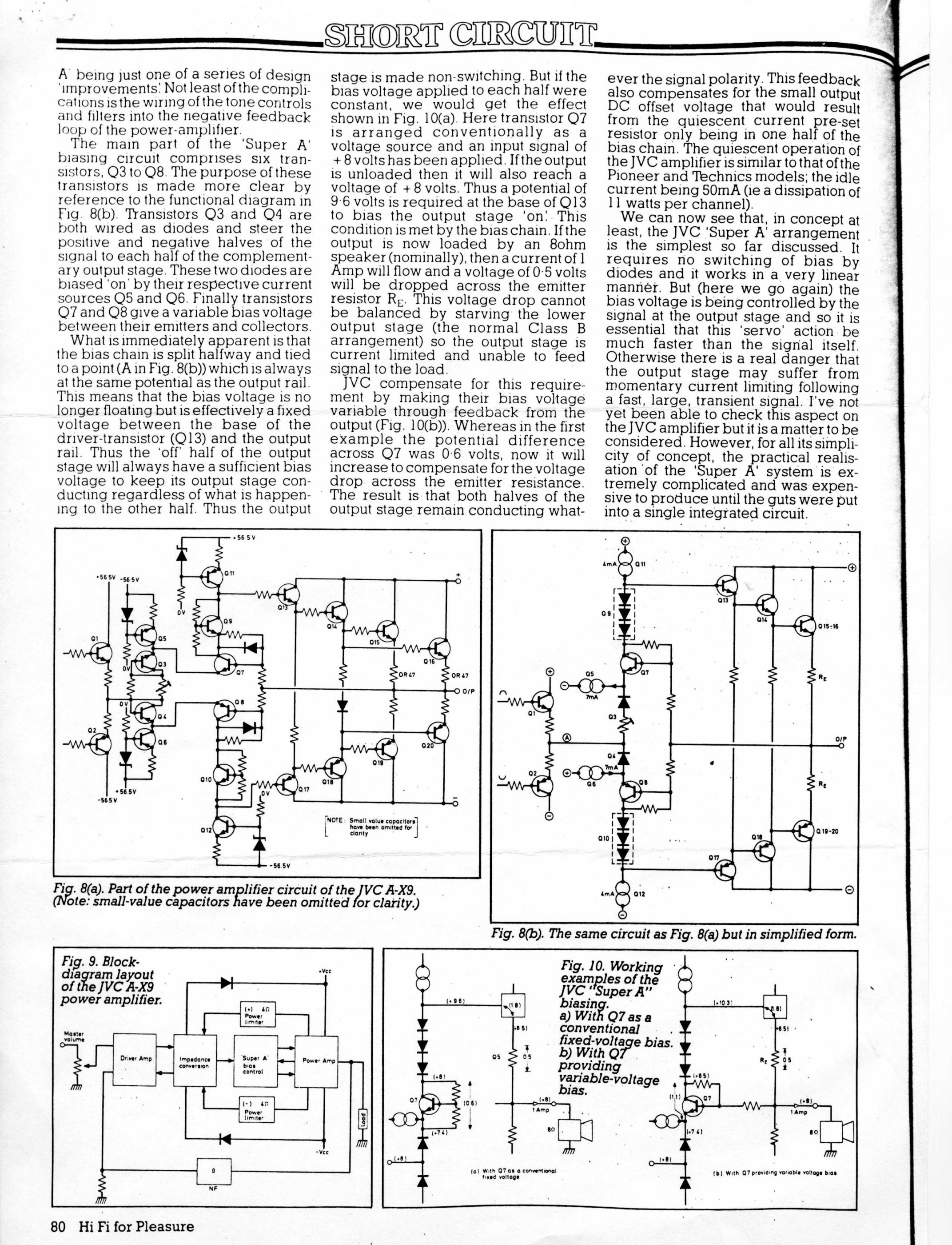

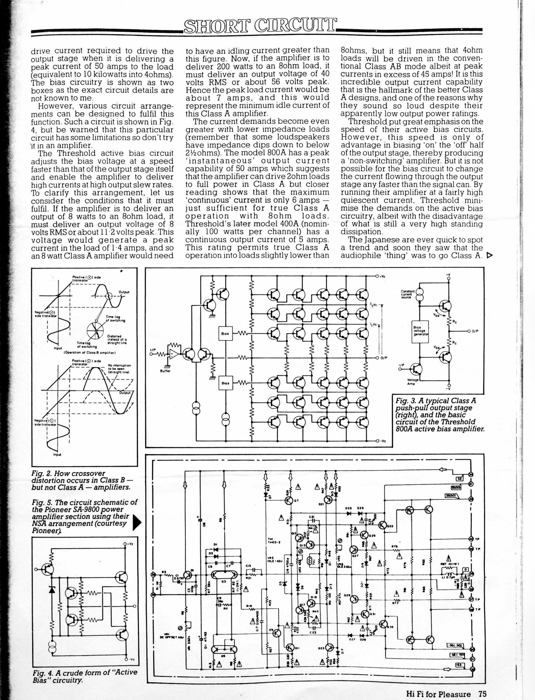

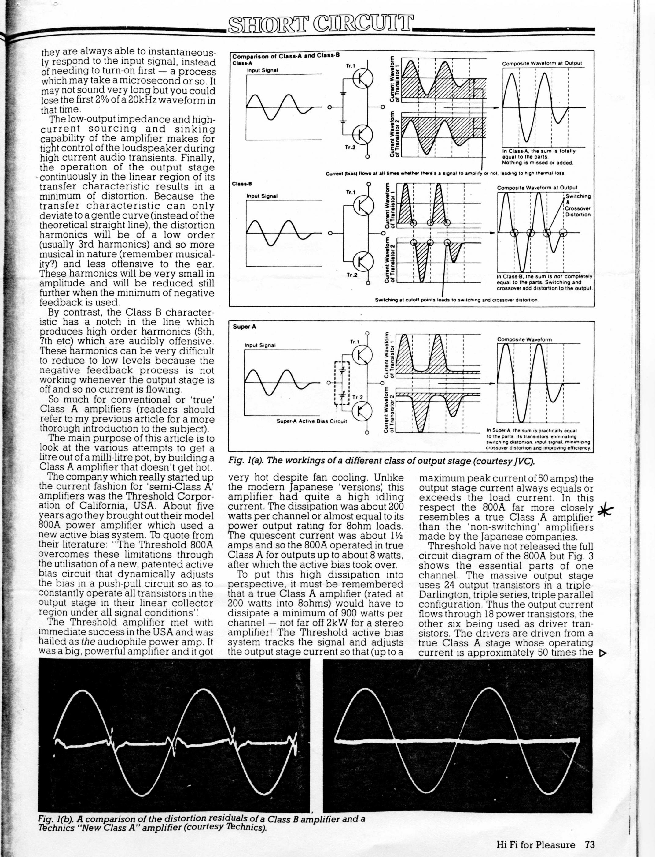

I have a copy of an old article on the subject from the 70's:
