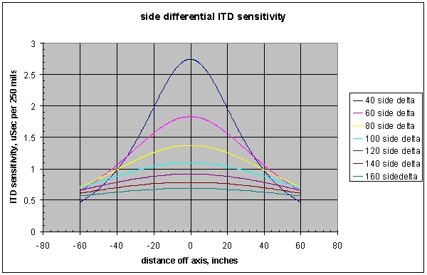

Hmmm...when I posted the statement "two dimensional problem at prophead two days ago, I meant literally, not figuratively..you apparently did not understand the term as I intended.
http://www.audioasylum.com/forums/prophead/messages/11938.html
I meant a two dimensional FFT, of the same type as is used for vision recognition systems..one which has as the plot variables, x and y in space, with the integrated volume under the surface indicative of virtual image sharpness.
Jon Risch said:
My point is that we can hear much lower down in distortion that many tend to believe....
My point is actually along the same lines..but I include ITD and IID as "distortion", that distortion being in two dimensions, not one as all the JND studies have tested.
Jon Risch said:
Yet these signal manipulations are all occuring at levels BELOW -90 dB, and would (if translated into single dimension metrics) be equivalent to distortion of only 0.003% or less. ....
So far, for image stability to a foot level, 5 uSec coherence and .06 dB coherence..at any signal level.. coherence being the key, hense the two dimensional FFT analysis..

Based on IID/ITD equations so far, I'm talking about .06 dB level variations as being audible at the one foot image stability level..small enough for whatcha talkin bout??😉
Jon Risch said:
One of the criteria used by objectivist's who favor ABX style DBT testing, is that the frequency response should not vary more than 0.1 dB, or a simple FR variation could be responsible for "hearing a difference". Thus, if one wants to avoid using their speaker cables as a "tone control", or in other words, avoiding signficant FR variations due to speaker cable resistance, then the speaker cable must have a total net AC resistance no greater than 1/100th that of the LOWEST impedance of the speaker system across the audio band. That would then include any inductive rise due to a high inductance speaker cable, and keep the FR deviation due to loudspeaker system input impedances and loudspeaker cable resistance below 0.1 dB..
Try about half that, interchannel, for a one FOOT blurring of the image..
Cheers, John
I think you either need to change the "one foot" to either "arc-minutes" or arc-degrees", or add distance to that to make the measurement precise. How far way is that "one foot difference" anyway?

Re: Re: Re: Re: Re: Reply to Original Posted Question
soongsc said:
How far is the image from the listener? If the image is 6 feet from the listener versus 20 feet from the listener, it makes a difference.
Suppose the image moves from 20 feet away from the listener to 21 feet from the listener, but in the same direction, wouldn't ITD and IID be pretty much the same? At least the change would be different if the image moved sideways along the 20 feet radius with the listener at the center of it.
I will again attempt to explain..perhaps this time I will be clearer.😕
Here is a repeat of the side differential ITD sensitivity graph. On it are 7 lines, each line represents a source that is a specific distance away from the plane of the listener. That would be the "Y" direction in space relative to the listener...
The "X" direction in space represents the distance away from the midplane of the listener. The graph states that as distance off axis..
X and Y form the two dimensional orthogonal grid that I am using to define the source location in space.
On this graph, the vertical axis is ITD sensitivity per 1/4 inch..I used 1/4 inch to provide smooth curves for the plot.
To read this graph, an example..
For a source that is 60 inches away, the violet curve pertains.
For a source that is on axis, the violet line crosses at 1.8 uSec..that means, that a source on axis that moves 1/4 inch to the right or left, will cause an ITD shift of 1.8 uSec. If it moves 1 inch, it will cause an ITD shift of 4 times 1.8, or 7.2 uSec.
Now, examine a systemm that is being used to project a virtual image in space. If the system is absolutely accurate, there will be no interchannel delays and the ITD will be zero. The image will be on axis. If the system introduces a delay in one speaker of 7.2 uSeconds, the image will have appeared to shift one inch sideways towards the speaker which is first.
As to your distance question, note for example, the 160 inch distance line, which is blue-green. One inch shift is about .7 uSec times 4, or 2.8 uSec. This means that the virtual image accuracy further away, is more sensitive to ITD shift.
As I stated initially, this analysis derives exactly what arrives at the ears from a point source in space. It does not state that we can localize an object 160 inches away to within one inch..it states the reproduction system requirements if you wish to do so.
The IID graphs are the same kind of analysis..however, the combination of ITD and IID can be used to establish depth sensitivity, as the curves are not co-axial, nor are they orthogonal.
Further analysis will establish the system limits on ITD and IID errors that can be tolerated while simulating a point in space with a physical error band, I chose arbitrarily a one foot radius circle around the source for textual descriptors.
Cheers, John

Re: Re: Re: Re: Re: Re: Reply to Original Posted Question
Cheers, John
So it's the geometric distance difference the image is between the left and right ear that is used to determine ITD and IID, should be easy with Excel. It looks comlicated when you plot the data like that. This could be used to determine ideal energy distribution pattern of drivers so that the image stability can be acheived in a wide sweet spot.
jneuron,
Before you dig deep again into ITD and ILD based modelling, consider the accuracy of the ITD and ILD only localization, the "cone of confusion", the importance of spectral clues, the party effect etc. Your model is too simple and gives falsely high resolution.
Minimum detectable ITD is around 1-2 deg at 200 Hz and getting worse with the increase of the frequency. Above around 1kHz ITD is useless ( 20 deg error), because the head size approaches half wawelength and the perceptually storng IPD clues confused.
ILD only error is around 5-10 deg.
Re: Re: Re: Re: Re: Re: Re: Reply to Original Posted Question
Correct. And it indeed was easy with excel, that is the program I used for the presented graphs.
