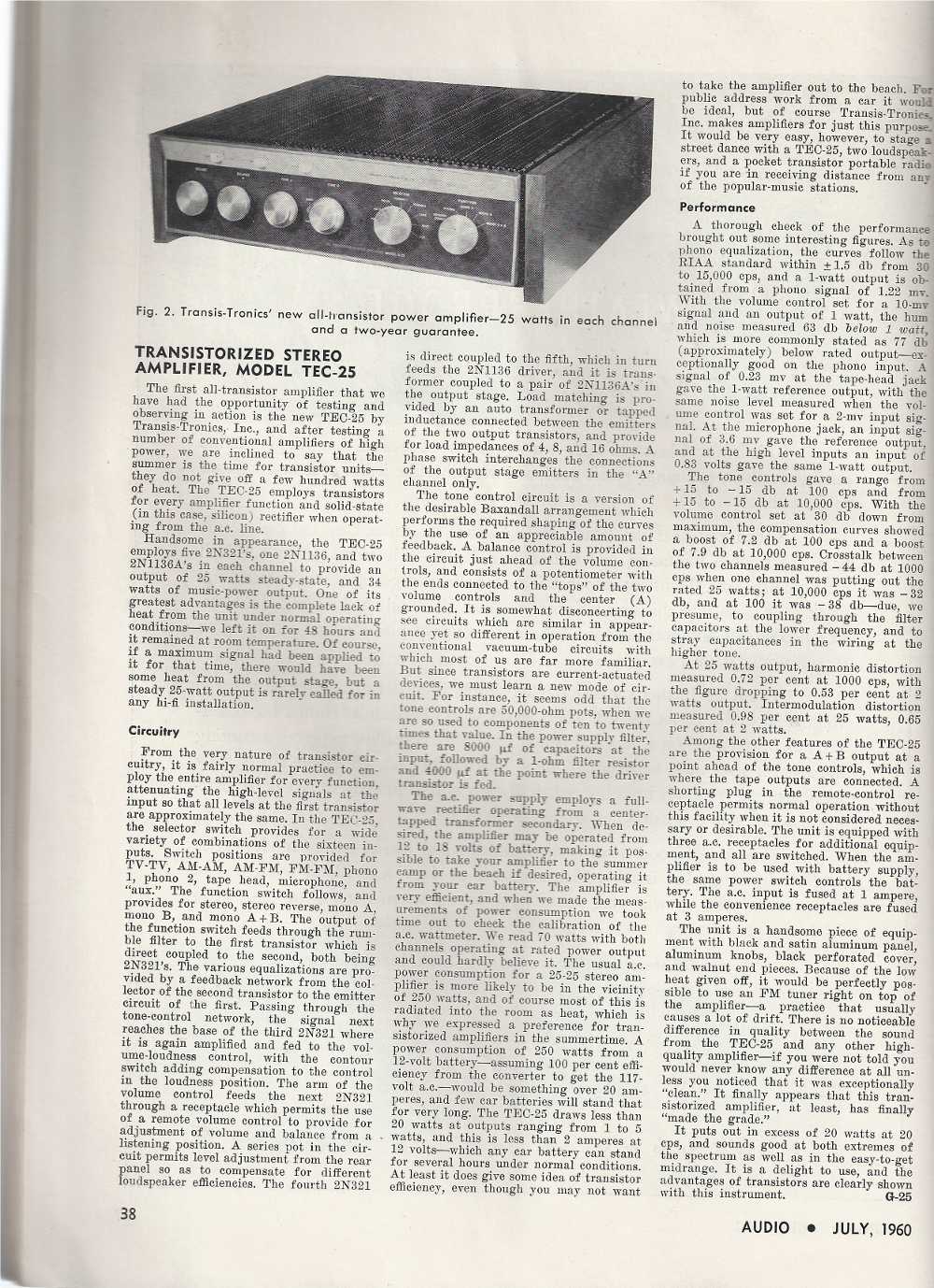

Here are the Audio report dated July 1960 and the back cover ad on the same issue.
