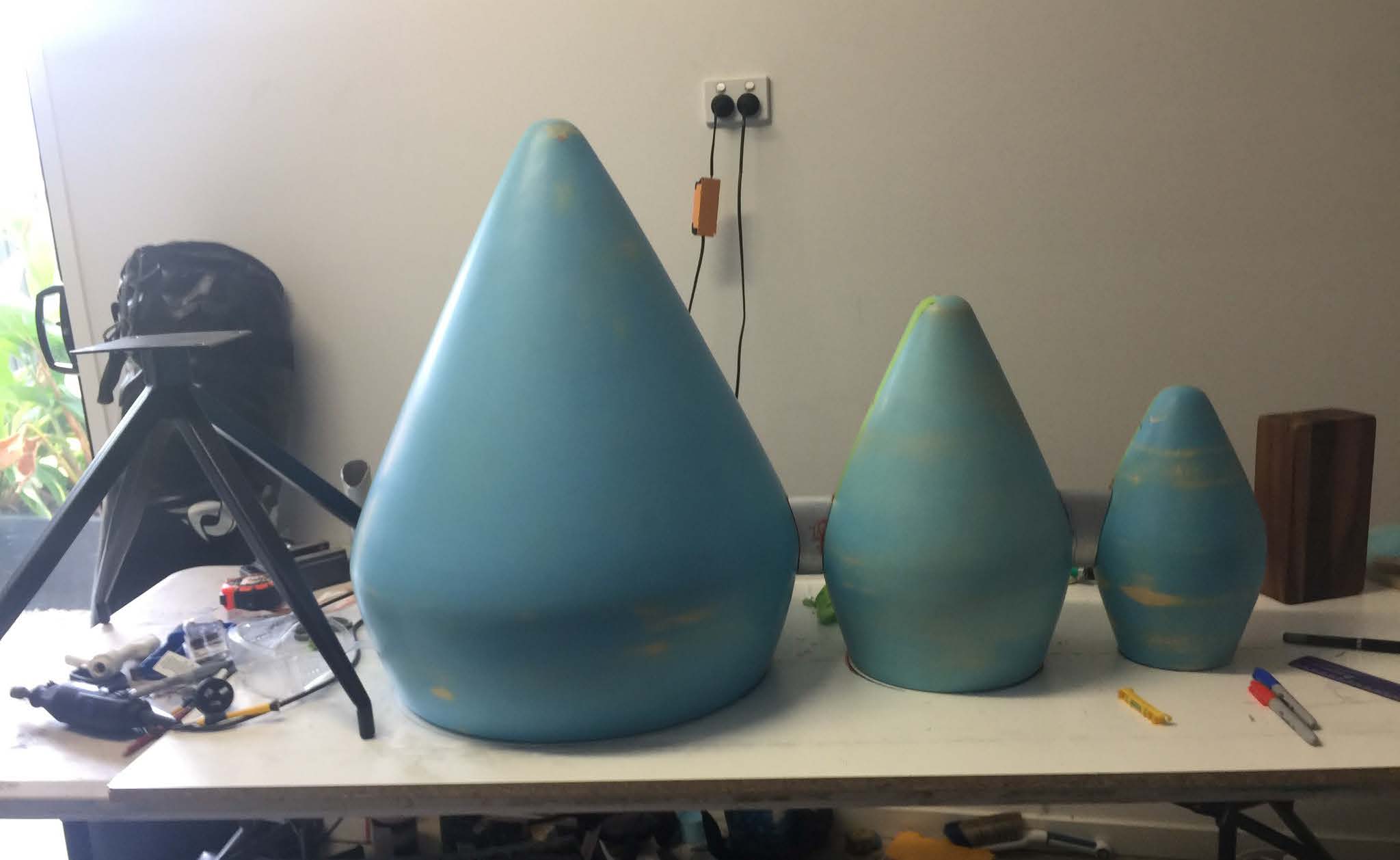

Tear shape/jet engine cowling design speaker project completed
Stunning! Builds on here often strive to get the drivers and acoustic center's close together. Not sure if that's required here but it wouldn't be hard to achieve?!
In some respects it would have been easier to achieve in relation to not having to worry about balancing and stability of the housings. The intention was to separate the drivers. I could have done away with the risers and cut flat edges onto the housings to bolt them together. One of the most frustrating aspects of the build (aside from the endless sanding, spraying puttying, sanding...) was cutting those risers to the exact rounded shape of the speaker housings.

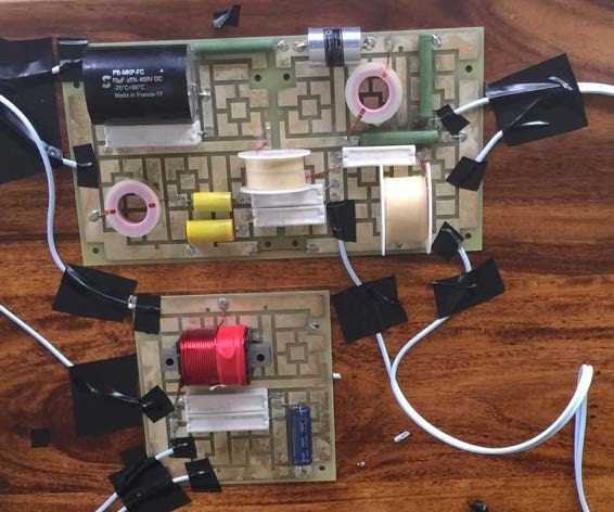

Can you give us more details on the drivers, XO, measurements?
Thanks,
X
I have attached the only build pictures I have which are from the later stages. The earlier and probably more interesting pics were on an iphone that went through the washing machine. I have attached a pic of the XOs (I didn't use the sticky tape in the build)
The speakers are approximately 60 inches in height and too heavy to move without dismantling.
subs: SB ACOUSTICS 12" WOOFER NRXL
mids: Scanspeak 15M/4624G Discovery, 5.5" Midrange
tweats: Seas H1 189
