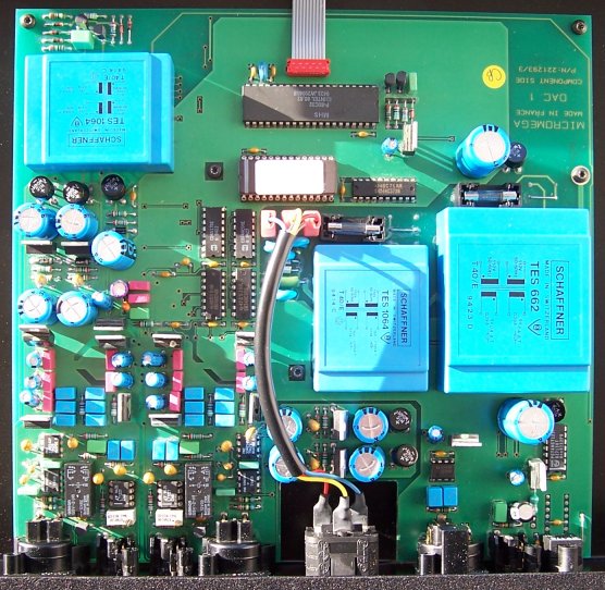

"High-end" is surrounded by a lot of mysticism and suggestion. But often a good design using pretty common components is at the heart of it and doing a wonderful job. Look at the attachment, it's the inside of a Micromega DAC1. High end for reasonable money. No esoteric component to be found...
