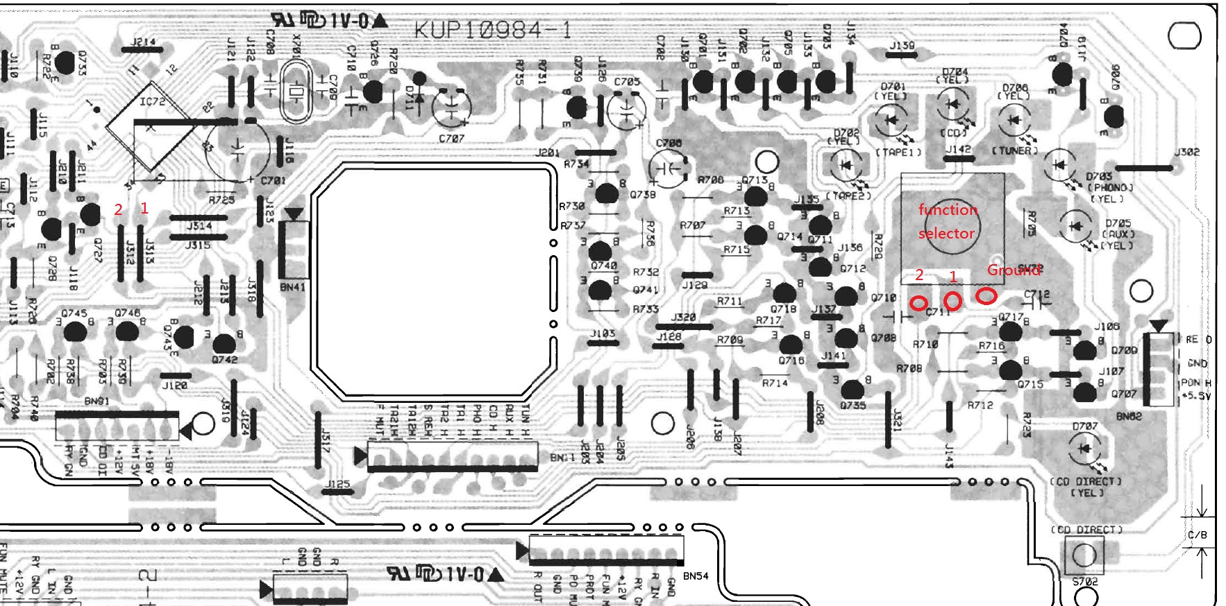

Hello Everyone!
Having a bit of an issue with my old faithful TEAC H500 AMp
The manual source selection on this old Amp has stopped working...it uses an ALPS encoder switch to increment 'Up or Down' signal.
Im confident the encoder switch is not it...checked with meter..and also had a spare ALPS Encoder which I swapped in/out and made no difference.
The thing with this is that using a Remote Control to change source input still works fine...source selection is highlighted by an LED and that works also.
Any thoughts from anyone appreciated..it would be nice to have this Amp completely working.
Seen a couple of people have had selector issues...but no luck...if anyone can help ..any thoughts would be most appreciated. Thankyou.

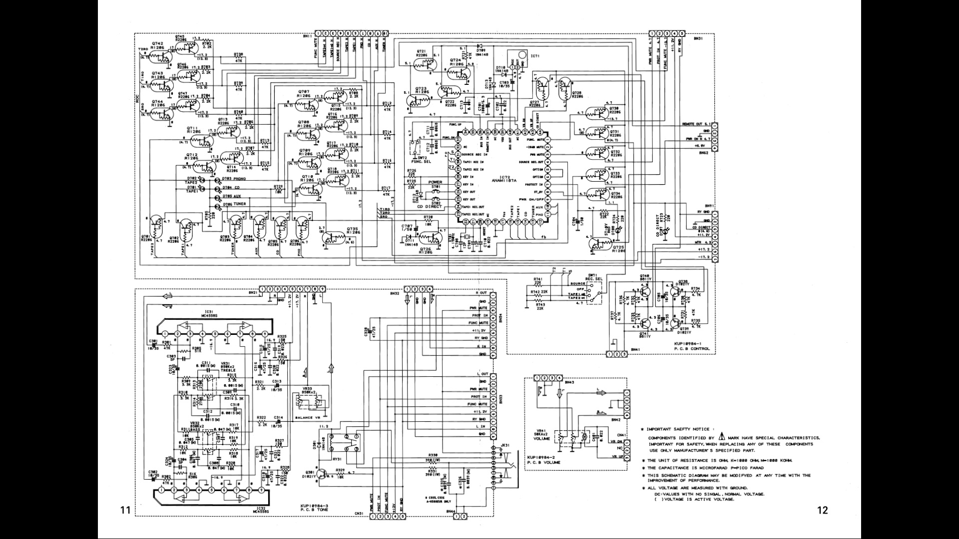

The function selector SW72 has 3 connection pins, 1 pin to the ground, the other 2 pins direct go to the MCU pin33 pin34 which have around 4.7V on these 2 pins.
Please check the PCB traces for these 2 connections to MCU pin33 pin34, if there is no broken trace and the switch is good then it will be the MCU internal problem and it can not be repaired except change the MCU.

Ive tested and found 4.7volts at both pin33 and pin34 at the same time....so I guess we can assume it must be the MCU that is at fault!?.
Resistance between Pin33 and Pin 34 on the MCU (without the encoder switch installed) is about 9megohm.
Unfortunately these MCU chips seem to be made by Anam Korea and impossible to find much info or find any to replace.

Just a final thought about this manual input selector issue...as it is it looks-like to be a fault on the MCU IC pins 33 and pin 35 (not 34 as I prev stated)
As the remote control input selection still works...so to add a manual selection option again (without finding and changing the current faulty MCU IC) then if I were bored perhaps could make up an Arduino with a rotary switch and IR transmitter..learning the remote codes for input selection and transmitting them with each selection of the rotary switch...mounting the circuit internally and rotary switch in place of the current encoder switch...just a thought to how to make it appear all working as such!

You don't happen to have a dual channel scope to take a look at what's going on at pins 33 and 35 when the encoder is rotated? I guess even a multimeter would be better than nothing if you take it s-l-o-w. I'd want to see the correct kind of pulses before condemning the microcontroller... it could still be a bad trace or lifted pad causing a bad ground at the encoder or something.

Oscilloscope testing on pins 33 and 34...tells me the original ALPS Encoder is fine...and tracks are fine up to the MCU Pins....it must be the therefore the MCU IC unfortunately...you could see with the Scope Switching of both Encoder Channels 'A and B' in sequence as you rotate the Encoder as expected... Reassembled Amp for now and will continue to use it ...all the while will keep an eye out for a spares unit.
