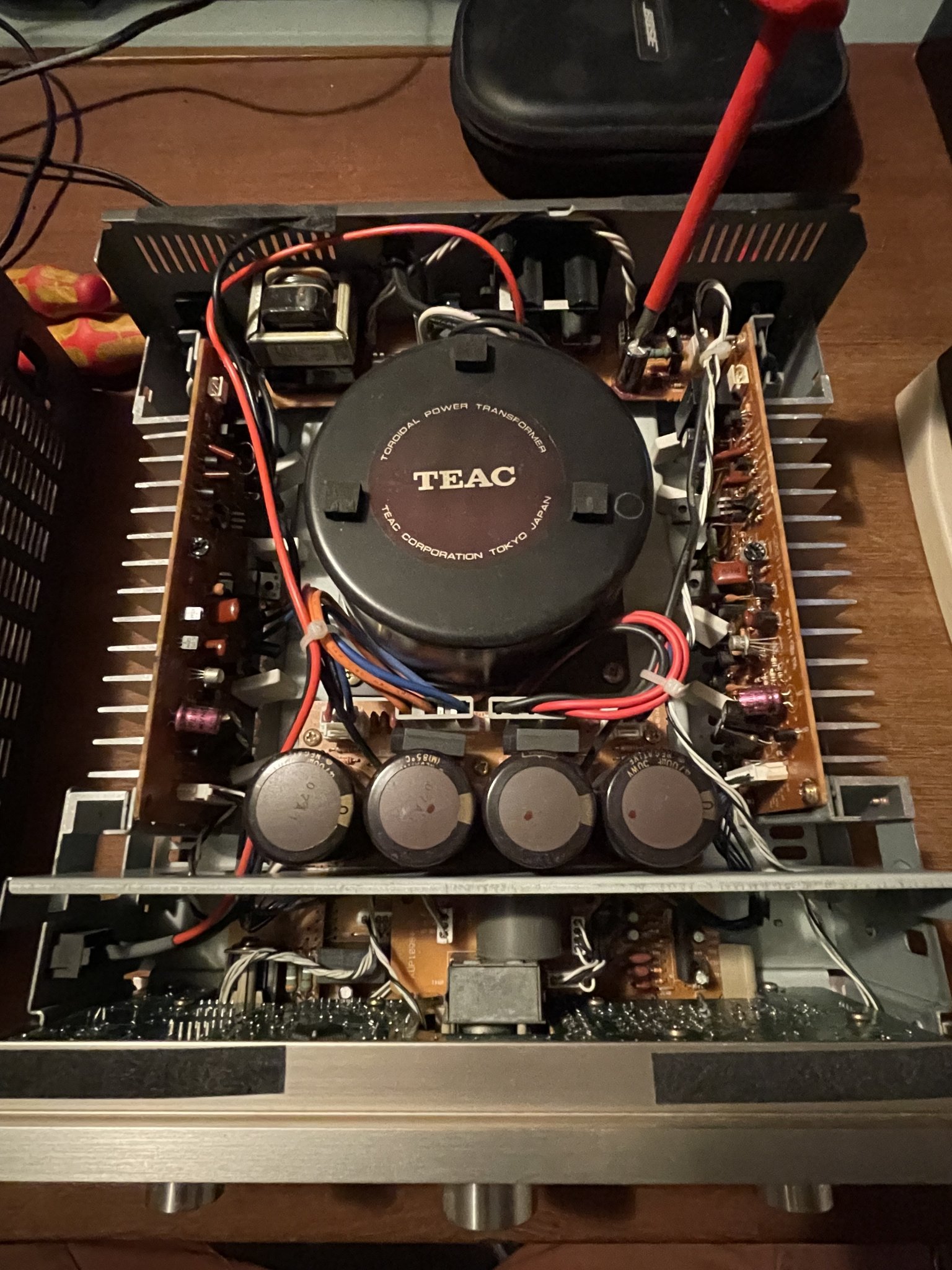

My old(ish) TEAC A-H500i looses sound intermittently in both channels (at the same time).
First I was thinking speaker relays, but that I guess would be channel specific - or?

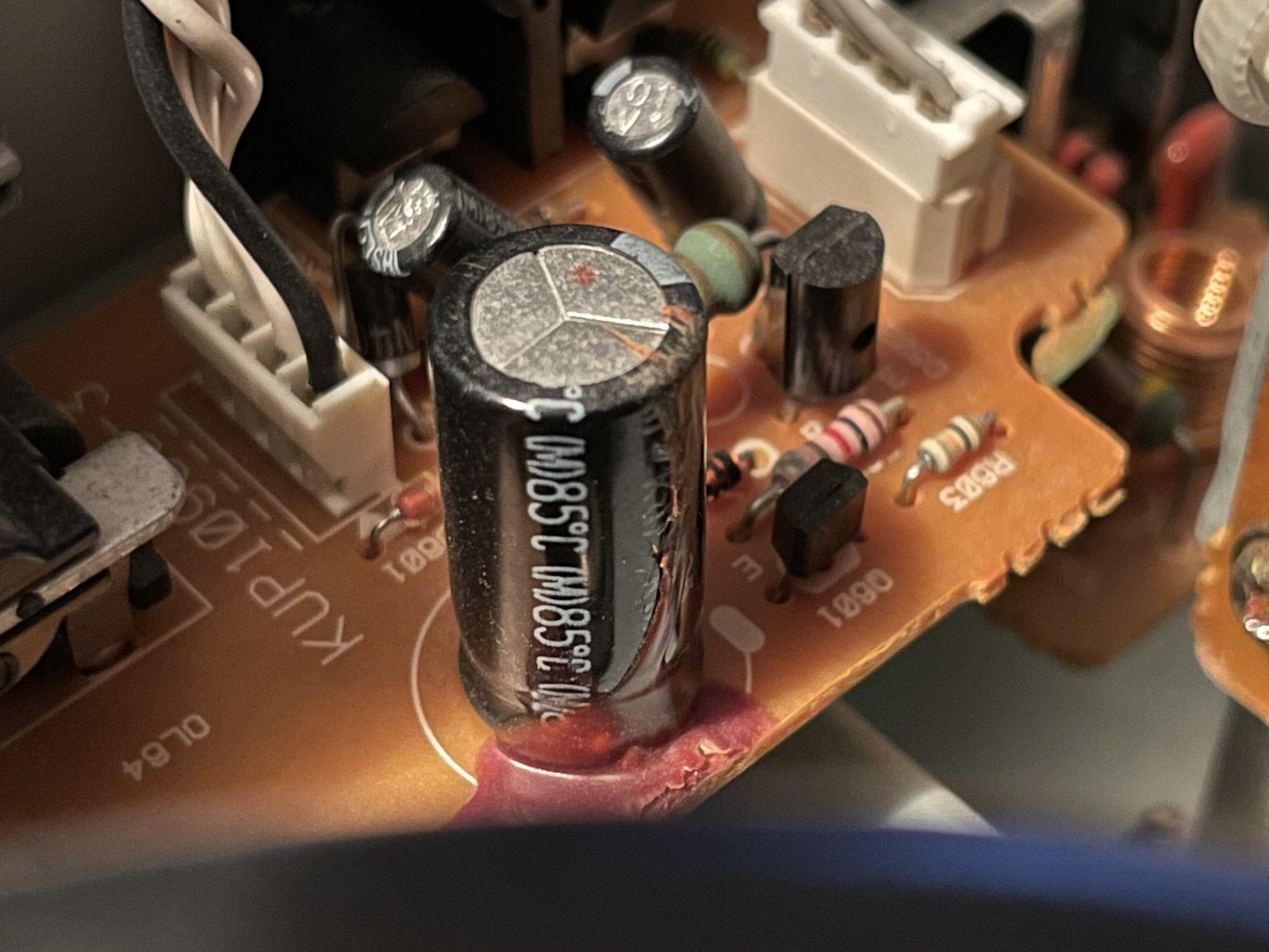

Then I saw this little fella, seemingly with a leak (or is it just glue?) According to the schematic it is on the “sub power supply pcb”.
I am not an expert and does not know what it does - anyone can help? Could this be it?
It is the one in the pictures - and link to service manual below.
If not it - what typically causes intermittent sound loss in both channels simultaneously? It is not a matter of speaker volume.
Thank you all 🙌🏻

There are lots of plug in cables, Try reseating all of those cables.
If this makes a difference, clean all of their contacts. Could be a power supply cable.
I detached, sprayed with contact cleaner and re-attached all detachable cable connections in the power supply chain. And now it has played without problems for 6 hours straight.
Thank you so much for this advice.
I simply had not thought of this simple thing (simple when you know, obviously, thank you for teaching me 🙌🏻)
