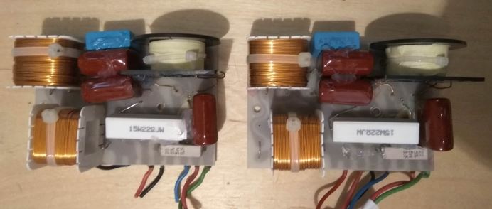

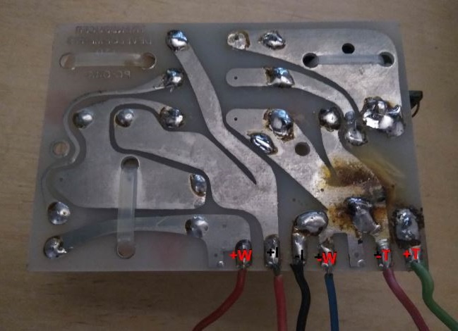

Maybe I should explain why I need these values. I have refurbished a pair of Studio 2's. The cabinets were in bad shape with scratches etc and the woofers needed realignment. All these were repaired and now they are in good condition. But the pair came without the tweeters (Elac 25DT units) and the crossover has an extra 22Ω/5W resistance in parallel (see attached pictures). The only plate tweeters I had in hand were a pair of Monacor's DT-250. These tweeters have a higher Fs (1700Hz instead of 750Hz) and a 90db sensitivity (instead of 87db). Monacor suggests that these cross at 3000Hz, which is the network's dividing frequency. The DT-250 sounds louder than the woofer.
I know that I should redesign the network but maybe someone who knows and understands a lot more than me about crossover networks can give me a piece of advice on what to do next. Shall I remove the 22Ω in parallel and replace with an L-pad? Maybe placing a 3.3Ω/5W in series with the tweeter will do the job for now?

I would assume the schematic is right on tweeter polarity. That big 15W hot-running 22R is probably in the bass section. I don't know what the small extra resistor is doing exactly. But polarity is often negative on 3kHz crossover from an 8" polycone bass.
You really have to trace each component to know what is going on. The small coil (0.3mH?) will be in the tweeter section, and the capacitors look like 2.2uF MKT. Bass coils are proably 1mH.
