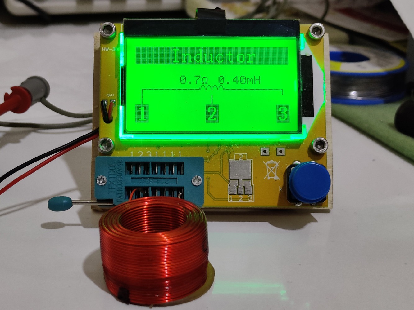

I've been using an LCR-T4 Digital Tester.The DCR readings on the original coils form post#50 seem way too high. The woofers inductor should have been getting very hot if so. Its bobbin size does not imply that high a DCR. Also the small coil appears close in DCR to the big one and that's fishy too. See alike coils typical DCR
How you got their mH? You have a DMM that reads inductance too? By the way since you are a speakers hobbyist maybe get a DATS V3 interface at a point. Measures not only the drivers T/S parameters but inductors and capacitors too in a proper way for audio band use.
There are no off the shelf such nominal inductance values for air core inductors. But there are tolerances. Being thorough, Vikash either noted down the replacement air core exact unit values or the original coils unit values. Most possibly by using an LCR meter set at 1kHz. 0.65mH vs 0.633mH is 2.7% tolerance. Not critical.

I have such a tester too and I run it on a random air-core coil to help the discussion. It shows 0.4mH 0.7Ω in the picture for a 0.45mH 0.57Ω as tested on my calibrated DER-EE LCR meter at 1kHz and then DC. Using Kelvin clips. Thus the little device with the nice bright screen could be systematically showing smaller enough inductance due to test frequency or method differences. The R shown while not precise by tending higher it isn't wild either.
By the way: Try to avoid using wire extensions to the component tester especially when for LCR purposes. If using any they should be 10cm short and thick gauge. Typical super cheap crocodile leads or breadboard jumpers have a hair of recycled blackened something pretending the wire inside that can measure into enough Ohms range alone.

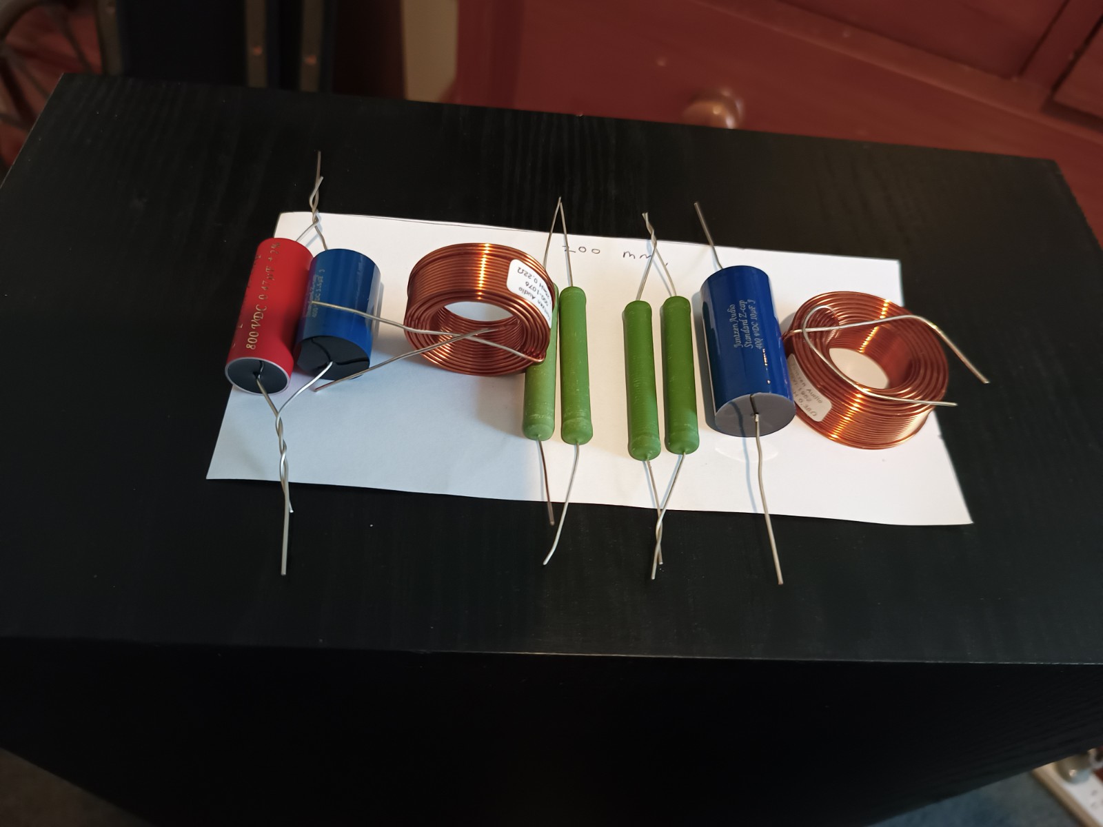

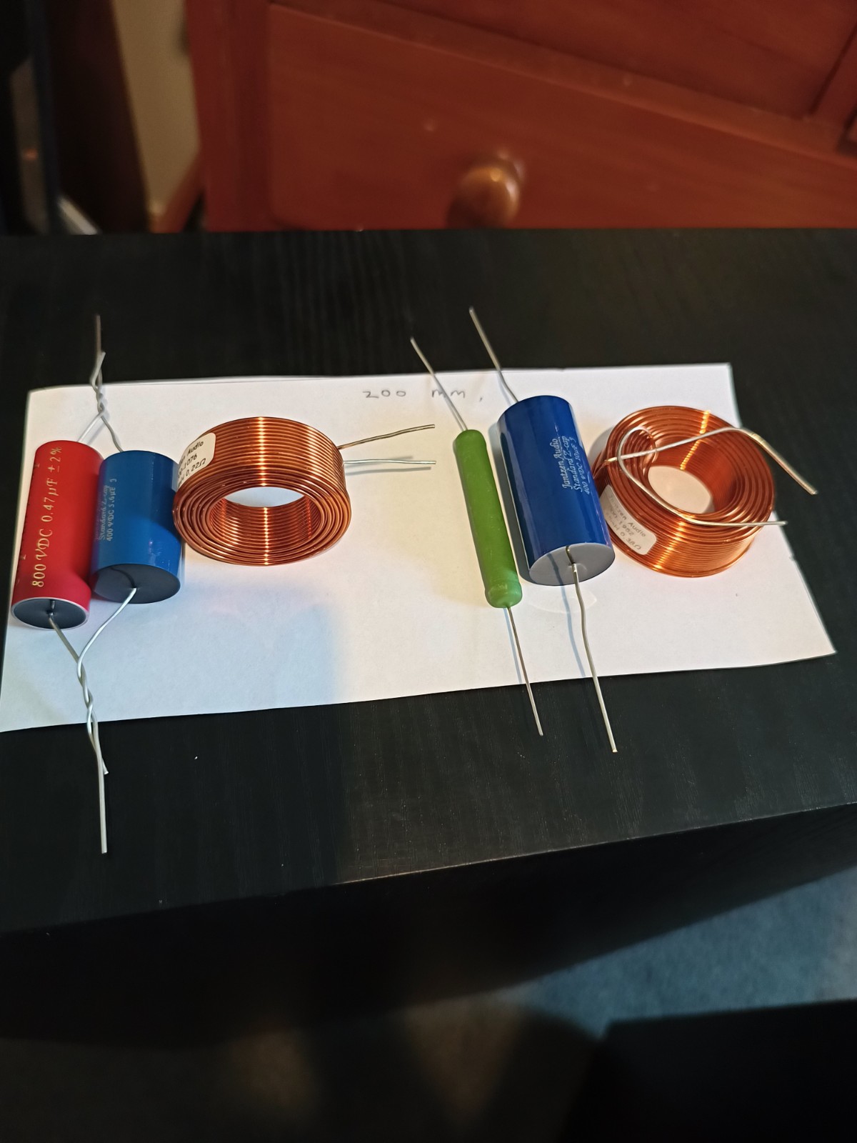

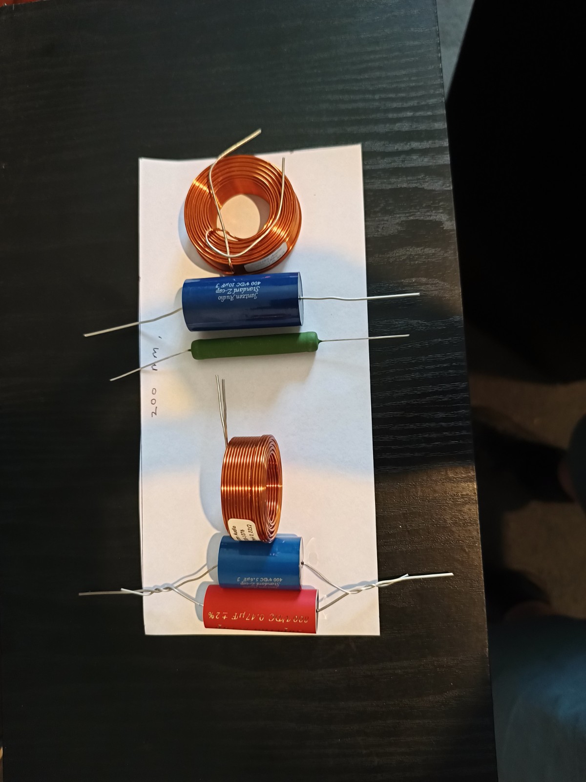

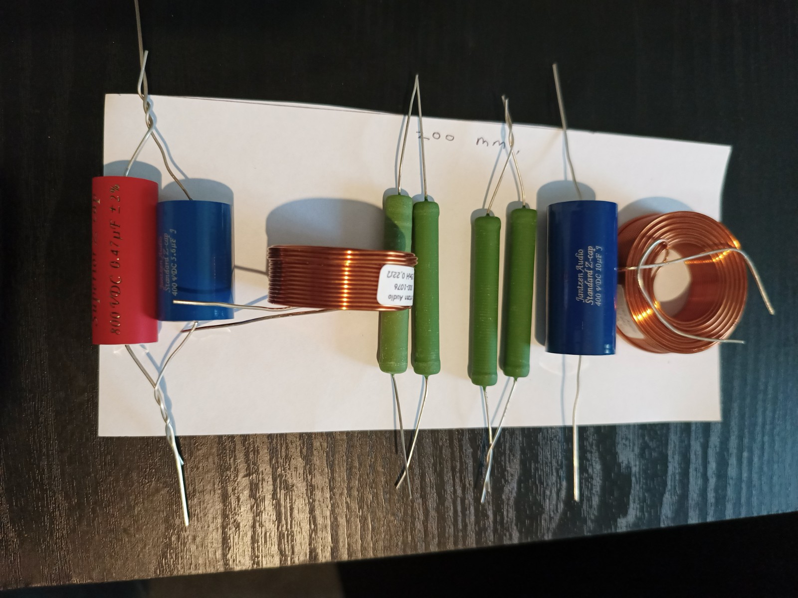

The first 2 pics are stage 1 (33Ω Resistor for the woofers)Its the best option. Will be reducing coils crosstalk. Is there a picture of the replacement parts you bought?
The last 2 pics are stage 2 (22Ω & 18Ω Resistors in parallel to replace the 33Ω, & RP1 1Ω, & RP2 10Ω for the tweeter)
The 6µF Cap requirement for Tweeter is made up of 5.6µF Standard Z & 0.47µF Superior Z (bypass style).
The paper they're sitting on is 95mm x 200mm.
