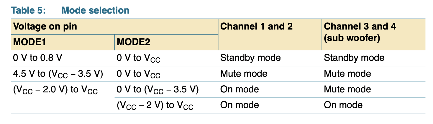

tda8947j without microcontroller
Have a look at the truth table on Page 7 of the data sheet. If you connect MODE1 and MODE2 to VCC all channels will be active. Connect both MODE pins to ground and all channels will be in standby. You can do this with a switch if you want, though you'll probably want to debounce the switch.
