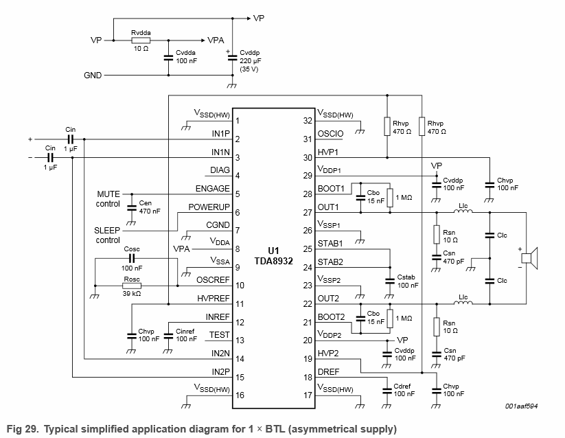

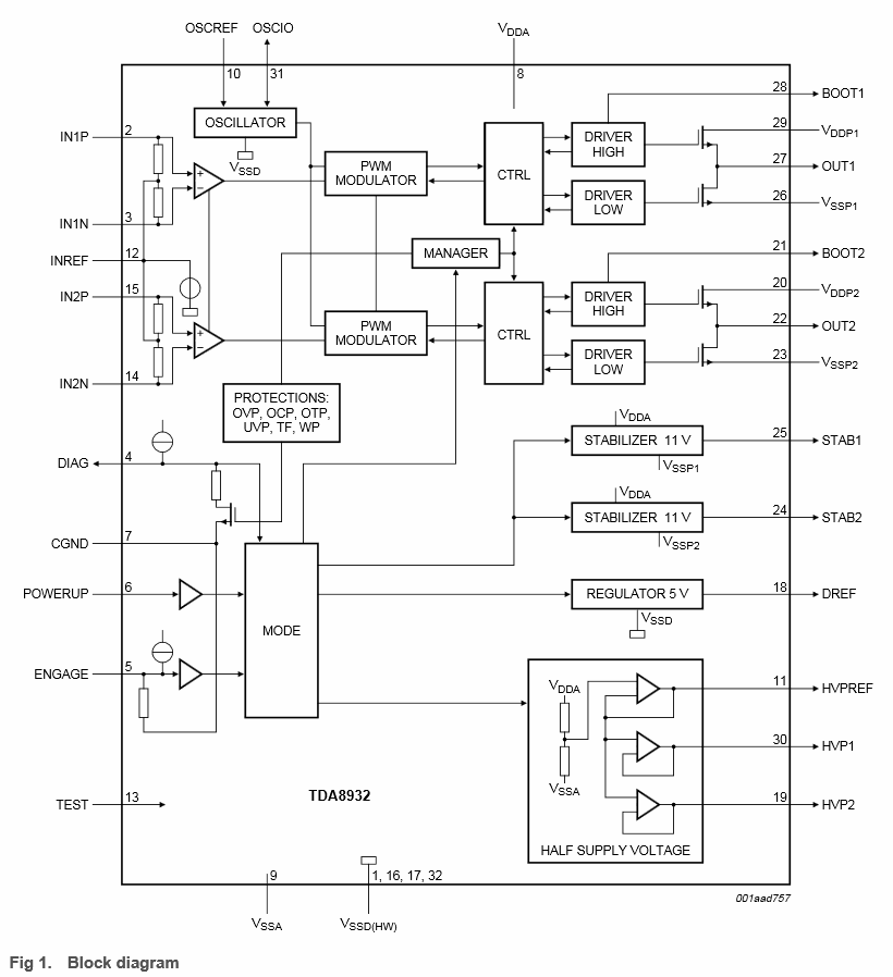

TDA8932 How to set the gain lower?
From the datasheet, NXP/Philips:
