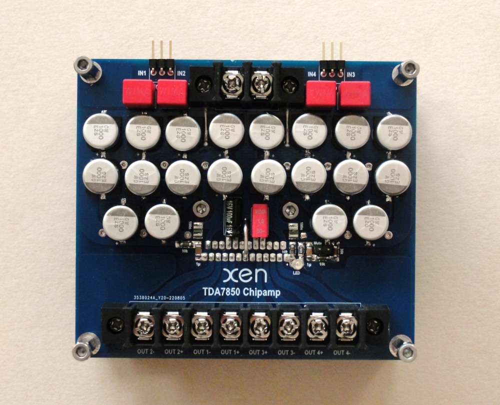

I was curious what was said about the TDA7850, but I didn't like the layout of those cheap kits around.
So I designed my own PCB, fully symmetrical.
PCB size matches the Fischer SK08-100 extrusion heatsink (100x88mm).
And I am using the H version of the chip.
Works first time. No lack of power or bass slamp.
Decent sound for the simplicity. Just for fun.
Patrick

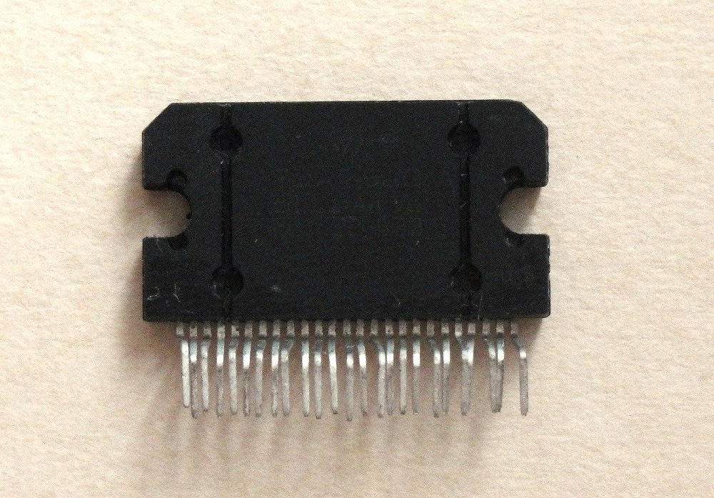

The next level of faking ?
Just to find out, I ordered a TDA7560 from a EU ebay dealer with 99.9% feedback.
He had sold 34 pieces of them and was asking for 5€ a piece.
On arrival everything looked fine, the chip has proper ST laser marking and everything.
The legs were unsoldered and all intact.
But the top surface was quite dusty and a bit sticky.
So I tried clean that up with PCB cleaner.
Surprise, surprise, a thick layer of black paint / ink came off.
All the laser marking disappeared with this black paint.
And the epoxy encapsulation underneath has no marking whatsoever.
For 5€, I am not going to risk and put it on a PCB to try out.
