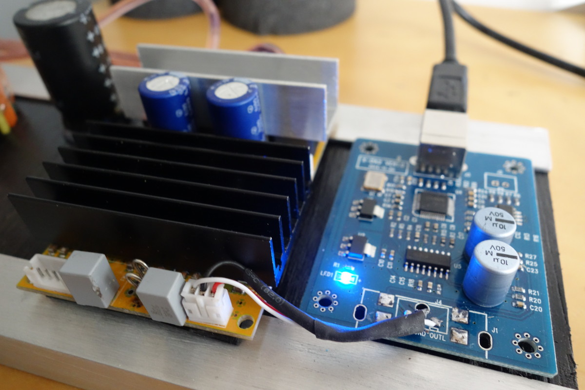

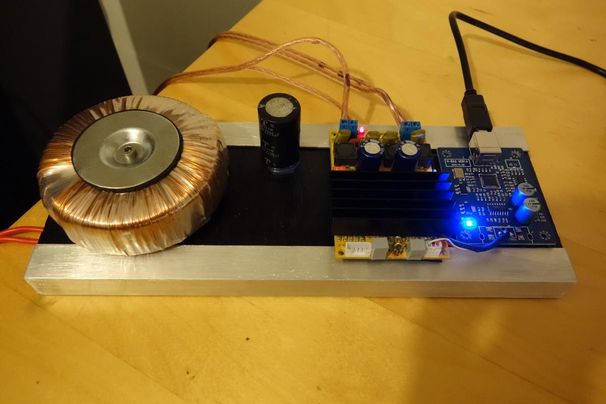

I've built a 100W amplifier which is working very well. The sound is sublime!
But, I've noticed the inductor heat is HOT. I mean, I can't keep my finger on the top of it. This is with the amp on (standby not engaged) but with no input signal, thus it seems to be the high switching frequency of the Tdk causing the heat?
Input is 25V AC so about 35V DC. Perhaps a bit too high, but within spec.

This is a known thing with switching designs, especially if the inductor is speced to a price or size requirement.
The biggest physical size for the desired inductor with minimum DC resistance is a general rule, all helps keep the temperature down. Generally these designs are best with 4 2oz copper layers, thermal vias and heat sinking for the hot passives as you have. The problem is the inductors need to be near the switching circuitry (often the controller its self) creating localised hot spots. Thermal management is a big part of the design cycle.
The inductors might not be sized properly for that voltage swing (switching, not audio)
They look like the size used for TPA3116/8 type amps (24V supply)
What happens if you reduce the supply? Do the inductors run cooler?
You could also attach a heat sink to them or replace them with larger inductors.(might be ugly but reduce thermal losses)
I've not tried it with a 24V supply, highest I can go to is 20V if I use DC with the equipment I have. I'm pretty sure it's less heat. The board requires 36V for full 100W output.
I've now heatsinked them as they are burning hot! I mean, there's more heat from the inductors than the main IC at lower volume!
The heatsink is now at 80c!
Next I'm wondering if the input cap's on the 7498 are necessary. The input source is a USB dac which doesn't need them (I've bypassed the two silver electrolyics on the blue board).

In my limited experience, ferrite cored inductors fitted to el-cheapo amp boards are extremely lossy (aka cheapo). Hence run hot even with zero signal. To get the amp to run cool, seek out a Coilcraft inductor of the same value and size. You'll probably pay close to the original price of the board for a set of 4.
Good god so many errors. I got off the plane earlier and I'm clearly a bit tired.
Chip -> 7498
Inductors -> 22uF (220 on top - doh)
20V is 0.12A quins.
I've just noticed the input cap's are 1uF, below the 2.2uF recommended, so they're out.
The inductors are 22uF 3A 12x12x7mm (common). I've just smashed one taking the heatsink off and the wire is really thin. Will go to 10A I think.
