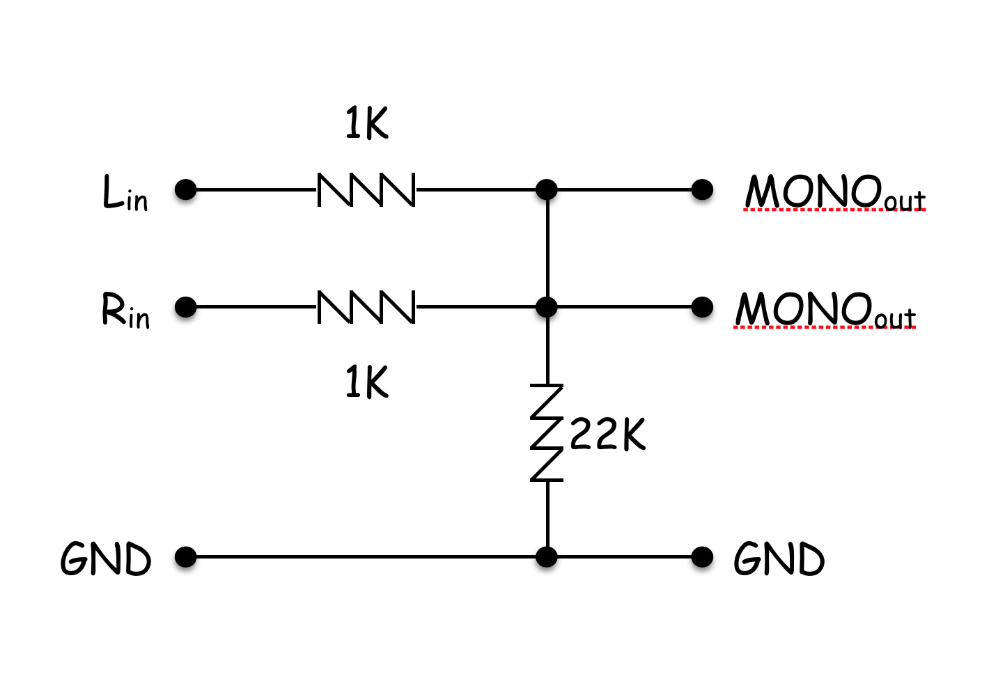

Hello, i have this amp:
TDA7492 bluetoot 4.0 2*50W
i want to connect this speaker to it:
80w 8ohm
i want to do it in mono, so i can avoid not hearing the other channel in music. How can i do it? Can i mod the amp so it plays only mono? Or join channels to get 1x100w. I think i saw similar TDA7492 amps with mono, but can i mod mine to be similar?
Other solution is to split speaker in channels. Look at the picture. A (4ohm) for right, B(8ohm)+ C(4ohm) for left (with some kind of cap on B). But i dont know how will it work, i am total beginner.
Forcing mono on phone (audio sorce) is not the option.
Unfortunately, forcing the source to be mono is the best option.
Otherwise, you really need a summing circuit with an opamp.
Or you can use a quick hack of a passive "summing circuit", which is technically not great, but may be acceptable depending on your application. This circuit goes between your source (phone) and the input of the amp.

I dont want to use 80w speaker on one 50w channel. I want to use as much power as possible, to be efficient. Thats why i want to distribute power between both channels.
Is there any other mono 100w bluetooth amp that you can recommend, but not more expensive than mine, on aliexpress (or ebay from china)?
I will use speaker for outdoor hangouts, drinking with friends, so nothing special. I dont need perfection.
I dont really understand what to do on my amp, can you explain me exactly for my situation. I can buy parts and solder, i know how to do that. But nothing more, i am even worse than a beginner in audio equipment.
Making the the play mono is the biggest task here.
My guess is that the speaker in the pic has a built in crossover.
Maybe only a cap in series to the tweeter.
But some kind of crossover will be there if it is in its original state.
I would buy another amp.
Even a seperated bluetooth module and a mono amp board will be easier to handle.

Keep in mind that this is amp is made for 8 Ohm on each channel.
You can try all of the speakers in parallel (the tweeter with a series cap) on a TPA3118 mono board.
