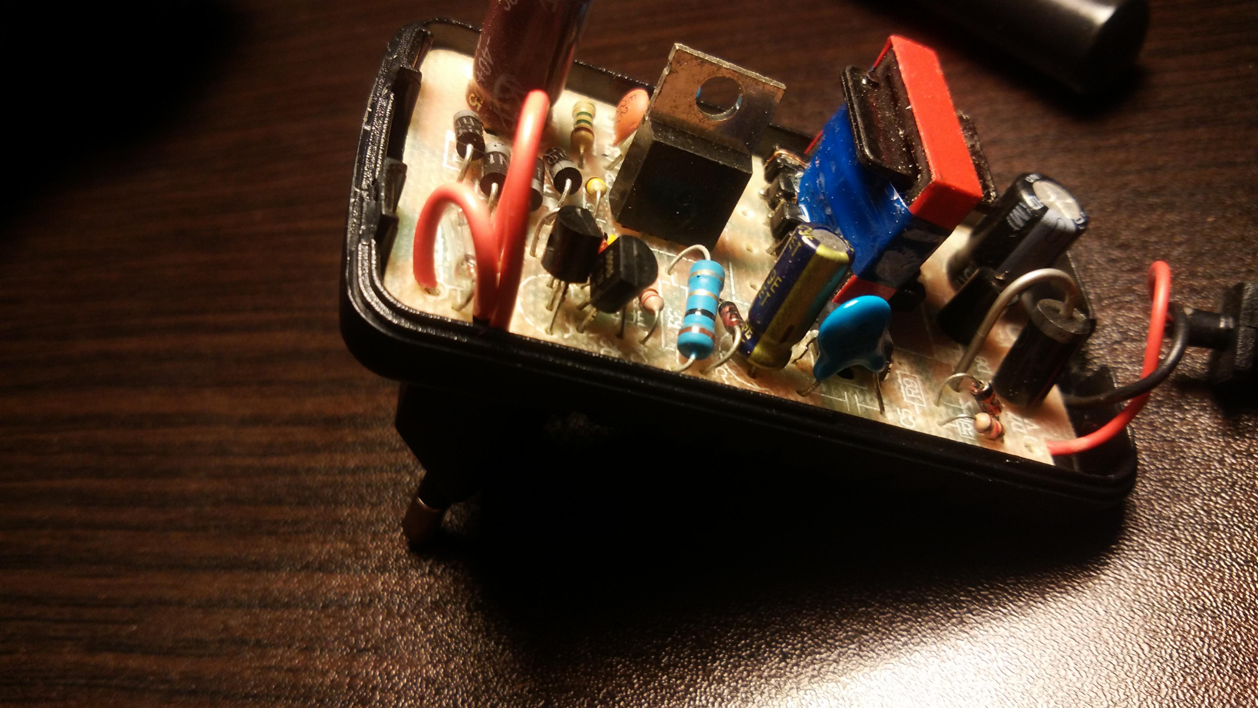

still i dont understand how am i suppose to fight the noise with voltmeter...any more detailed instructions would be welcomed...meanwhile i connected 2 9 volt batteries instead of wall brick for a test, and while the amp played with heavy distortion (probably the batteries cannot supply enough current), it was dead silent when idle and input cables connected.....so assuming the noise is some kind of power ripple , how do i eliminate it? adding more decoupling capacitors?

well, these chepo switching powersupplys can do interesting things so to say,
i would not be surprised if that was one source of your problems.
i would not trust these things ever.
maybe you could salvage a proper transformator and build a psu ?

So, it was power supply to blame..I switched to transformer based power supply and the noise is gone. ..very faint noise still can be heard very closely to speaker ( and it still goes away when I touch the heatsink), but practically I can say there is no noise anymore.
