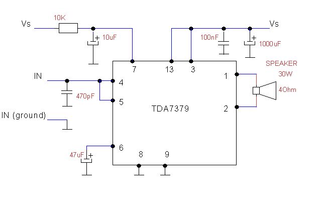

Anyway, i created a simple sample circuit, according to TDA7379 datasheet .
I connected it in Bridge mode (as in datasheet), while using only single input (left) and single output. I plan to feed the input with mixed L+R signal from line input.
I also put an audio pot between the line-in and amp input, to control the volume. The power is received from a 12v/2A wall-brick
In general this thing works and is pretty loud, however i got some strange noise which i cant seem to eliminate. Noise coming out of the speaker even if nothing connected. However if i touch chip heatsink, or metal part of the pot, much of noise goes away (still stays a little at a very acceptable level). So it seems like grounding issue, however I checked all grounds and they seem ok - i mean connected together.
Please help me to troubleshoot this.

here is a link to sample schematics from the datasheet
again, i am using only left input and left output

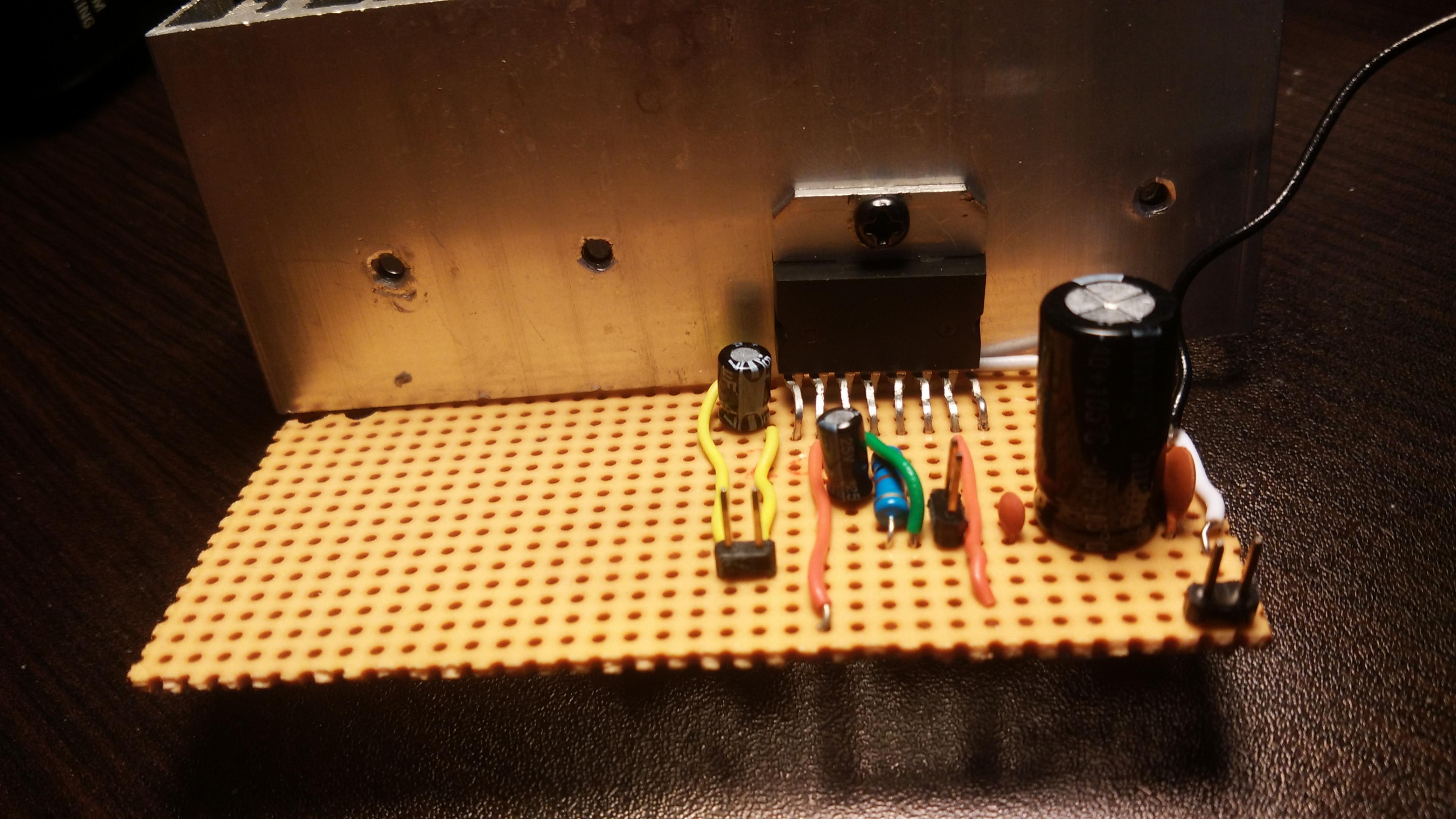

here is the picture...its not the state of the art work...just a poc 🙂
from right to left:
1) on a right side there is a connector for power, with filtering capacitors. the black wire is ground from audio pot (currently disconnected)
2) next in the middle is the input connector. there is also a 470 pf decoupling capacitor there, that is I believe is supposed to filter out inaudible high-frequencies? i am not sure if needed or not...have seen it in some schematics.
3) to the left of the input connector is chip stand-by components, according to schematics
4) next on the left side is a speaker connector, and further, closer to heatsink is capacitor connected to pin 6 of the chip

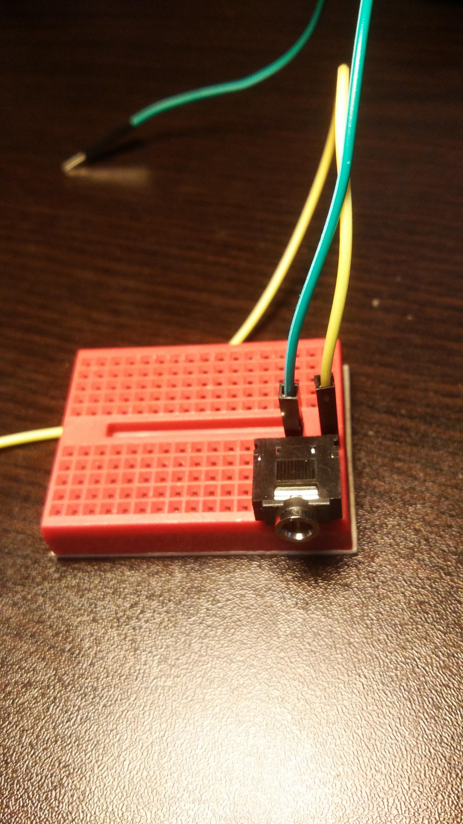

if i connect this as is (with speaker connected off course) - the amp is dead silent. but as long as i connect any jumper wire to amp input (i need it for now since the audio input is located on a separate breadboard for experimenting), it starts to produce noise, which is greatly reduced if i touch heatsink or basically any ground point...

you can try to connect the metal tab/heatsink to power ground , i don't remember the internals of this chip and how is the metal tab connected.
if the noise goes away then its a good hint. probably you would have to wire the metal housing of the pot to gnd too.

Arty, i tried doing what you propose, it does not make any difference. the noise only goes away (almost) if i touch it - i.e. ground it to earth...however the original product had only 2 wires connection, without earth..so i believe it worked without noise and without requiring earth connection...
The description has much vagueness. Is the ground wire between the input connector and the amp connected? Does it make noise that way? Does the noise come out of one or all channels?

wwenze, ok i will try to draw a schematics, its pretty the same as in my second post here, just single channel - since it is mono.... the ground wire of the audio input is connected to the ground (power supply ground)
when the audio input is disconnected from the amp input (the middle connector in the picture), the amp is dead silent. however with short jumper wire connected it already produce that noise

do show the powersupply circuit too. allso not sure about that 470pf cap at the input.
it should ne something like 470 nf to 1uf or so, and in series with the input.

It is good. Add a series resistor of 2.2 Kiloohms for a defined lowpass.2) next in the middle is the input connector. there is also a 470 pf decoupling capacitor there, that is I believe is supposed to filter out inaudible high-frequencies? i am not sure if needed or not...have seen it in some schematics.
Use shielded cable. For you know, if source (the device we connect to line-in, and the volume potentiometer) impedance is hi, an open cable following the source works as a capacitor to other devices such as the power supply, picking up noise.if i connect this as is (with speaker connected off course) - the amp is dead silent. but as long as i connect any jumper wire to amp input (i need it for now since the audio input is located on a separate breadboard for experimenting), it starts to produce noise, which is greatly reduced if i touch heatsink or basically any ground point...
great, so my understanding is correct...so, why 2.2 K? why not putting a resistor of 15K? we want to cut frequencies above 20Kh...
not sure i understand this...simply connecting cable to the input will create noise? it is a pretty short cable...so i either must use shielded cables or solder everything directly to pcb?
its not a problem to have a capacitor from input to ground to filter radio signal pickup and stuff like that, but you need a series capacitor too to make sure you don't have DC going in the amplifier.
supposedly you should ground all unused inputs for a brief test.
i'm not sure about the internals of this chip, but it may be picky about having floating inputs.
you should allso try to run the amplifier from a battery source for power.
2x 9v batteri in series should do the job quite well.

I just scanned through the datasheet.
I did not see what pin the backplate is connected to.
You need to measure to find out if the backplate is connected to any GND pin, or to any -V pin, or to any +V pin.
There is a note at the bottom of page 3 telling us that pin10 is pulled up to +5V. Is this a necessary condition for operation?
Andrew, the backplate is connected to ground, just validated with MM. Pin 10 (diagnostic) is not connected to anything
I grounded the unused input pins as Arty suggested....it did not make any difference for the test - connecting input cable to used input pin still produces noise, which is made louder when i touch the cable....however i proceeded and connected my source (a smartphone with headphones output jack). the input is coupled with in series capacitor (which is on breadboard). and i noticed now something interesting - as long as there is incoming signal (phone playing some music) - there is no noise in the output signal. i mean i can't hear it even when i low the volume almost to silent. however when i stop the playback - the noise returns after couple of seconds. maybe these hints can help....
remove the common link between 4 & 5.
Connect to only one input and connect the temporary load to that corresponding output.
Monitor via headphone and Voltmeter, not your expensive speaker.
what do you mean monitor via headphone? where to connect it? actually its more expensive than that crappy speaker...how measuring with voltmeter helps me to eliminate the noise?...you suggest to disable bridge configuration, but than i loose the power...
