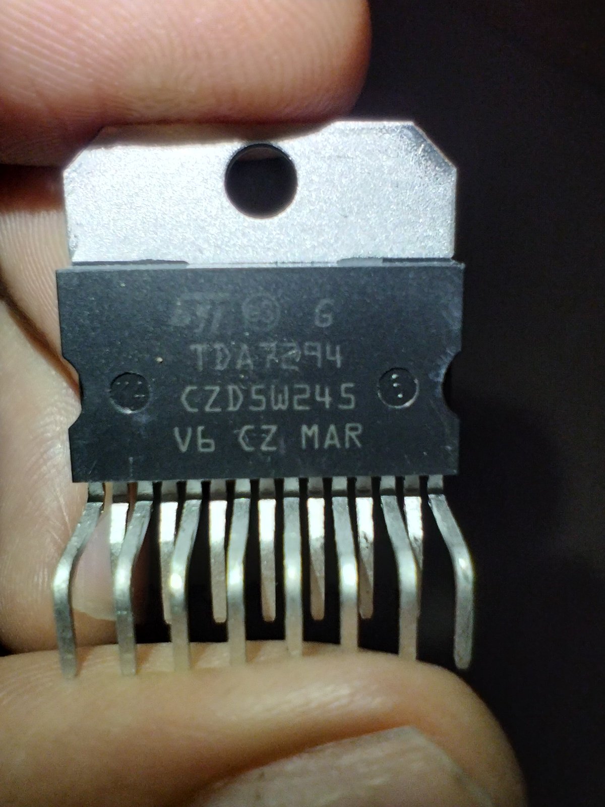

Xtreme FAKE :rofl:

It is not laser etched , it is fake.

You are enjoying fake IC, basically TDA2050 die inside fake package
Some supplier might have nos IC as u pointed out

Fake chips consume too much current at IDL or too much heating at18-0-18, original chip can survive 24-0-24 easily at 8ohm load but fake chip burnt in second, fake chip has no protection at all so original chip is like hidden gem in India but fake or counterfeits you can buy everywhere, also seller selsbthat on Amazon also so conclusion stop wasting your money and make better than that by diy 🤣🤣
