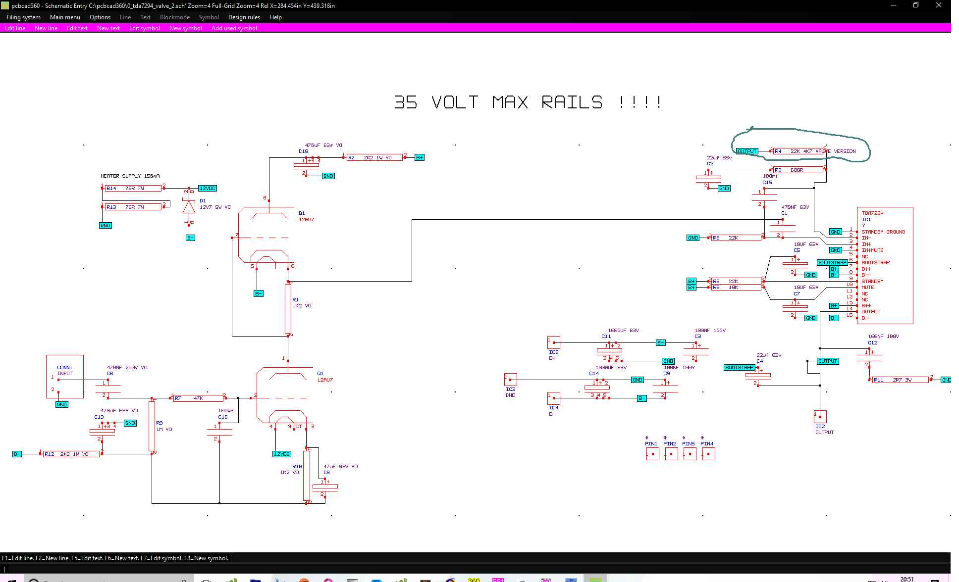

Just tested my new build valve front end with TDA7294 on output.
The valve part works fine.
I am getting about 500mV 1MHz oscillation on the output of the TDA7294.
It was worse to start with and shorting out the two copper pours with a wire link improved things.
There is pretty much zero hum so I don't think it is a ground loop.
The gain of the TDA7294 is set to about 5 to adjust for the extra gain from the valve stage. If I put in the recommended 22k the oscillation gets much bigger but lowers in frequency to about 100KHz.
If I turn my volume control down to zero the oscillation gets worse. Turning up the music reduces the oscillation. SO perhaps it is a ground issue. The circuit zero volt line is earthed.
The TDA7294 also pops on power down. I am taking the valve heater supply from negative rail so it could be because that rail is discharging first on power down.
C3 would be more useful if you could get it closer to the IC. That would lower the inductance between the capacitor and the IC.
You may also need a smallish electrolytic cap (10-22 uF) in parallel with C3 and C9. I don't know the TDA chip you're using, but the LM3886 gets rather cranky if you remove the small electrolytic cap. High-power opamps like the LM3886 and TDA... are a bit sensitive to the decoupling networks due to their large current drive capability.
It sounds like the TDA... is oscillating. It should be able to start up and power down without spurious oscillation with its input shorted to ground. If it can't I'd figure out why and fix it.

I have done quite a bit of research into the oscillation problem.
One thing I found was the feedback resistor runs miles away form the TDA7294. This is not recommended as the tracks to can be as much as 1nH per mm. This would explain the oscillation.
So I managed to bodge the circuit by putting a 1000nF across inverting and non-inverting inputs. The valve version gets away with 100pf as it has less gain. The plain TDA7294 circuit with more gain requires 1000pf.
So another project and learned a few lessons from it.
Despite the problems the results, especially the valve version, sound very good.

My main problem was the feedback resistor being too far from TDA.
This caused 1MHz oscillation.
I bodged that pcb with 1000pf across inverting and non-inverting inputs.
As oscillation waveform starts it is fed back straight away into none inverting input and cancels out.
The valve made the problem worse by picking up the 1MHz and amplifying it ! This then just went around loop. 100pf across grid to ground filtered it out.
R4 schematic
need clarification of R4 values.
Is this 22K +4K7?? ie 26K7
