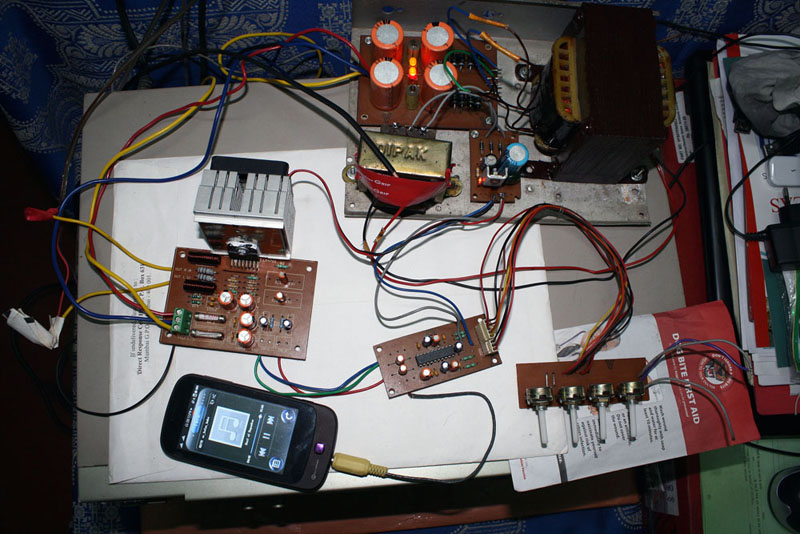

Appex, I built a ampli with LM4766, it is sounding so good. can you tell me what is the optimum voltagewhich can be safely used to operate in 30 deg. Celcius ambient temp.
Giving a piture below.
Right Appex, thats a good point, that should be kept in mind.
Use +/-24V DC rail voltage.
Regards
Regards
Thanks Appex. I am currently using +28 -28 V DC for this amp. I made the transformer my self and will reduce the voltage as per your suggession.
Another help I need. I made a tone control unit for that amplifier with LM1036N. I am not satisfied with this tone control unit. Feeling lack of low response, specially below 50Hz. Is that my problem? Do you have any better Bass Treble control schematic and PCB with IC or Transistor? If you have please upload or send to my mail(diptangshu@gmail.com).😕

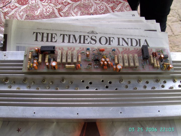

Hi Appex, how you got The Times of India news paper? I have seen this paper in your photo on Facebook.
Facebook page 'APEX audio' is only for other people builds my DIY project (noncommercial page)
