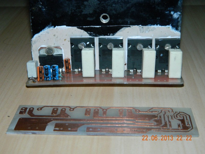

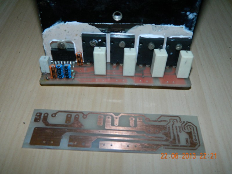

Hello dr frost
greetings just want to say THANKS for your wonderful design tested it on 2 ohms on 40 0 40 DC supply sound is clear tomorrow i will design pcb for 2 output pairs
and post some pictures THANKS

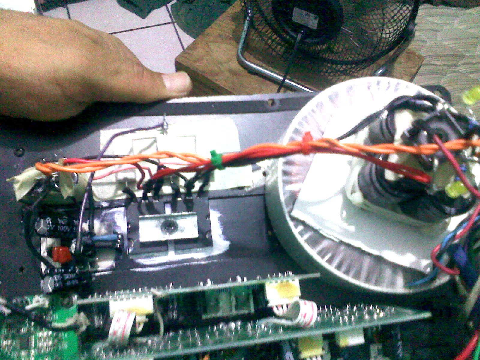

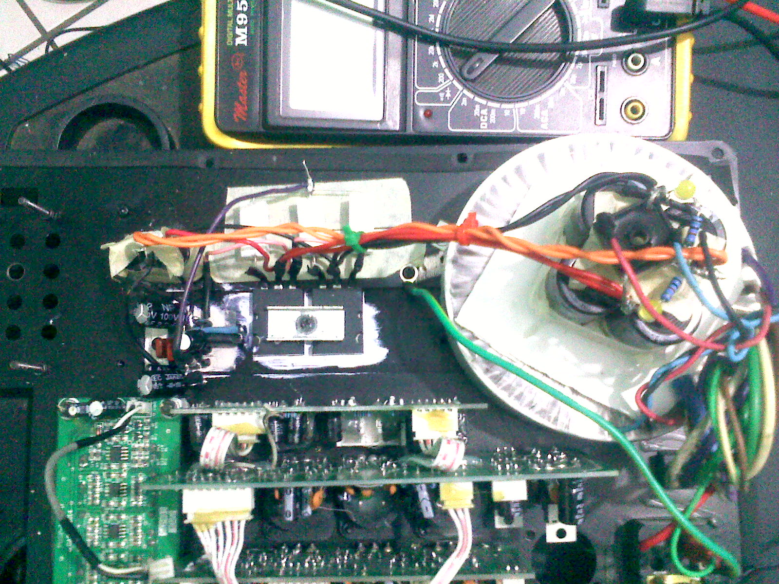

hi
this is the final assembly, had to make a time to finish the amp section, later i´ll deal with thepre section, so far last ite itried it but had a bad insulation in teh chips tab, and it was sending 30 something volts at the output. Right now i just put a new insulating mica and washer and it´s OK as far as the DVM says. I´ll try it and post afterwards. thanks.
It is different ´cause i used Mr. Daniels W schem for the chip part and from there he rest is by yours, so o´ll try and see what i get
sound is not ok and have like 1.6 V ofset at the output, loud buzz when i remove the input signal, going back to check grounds

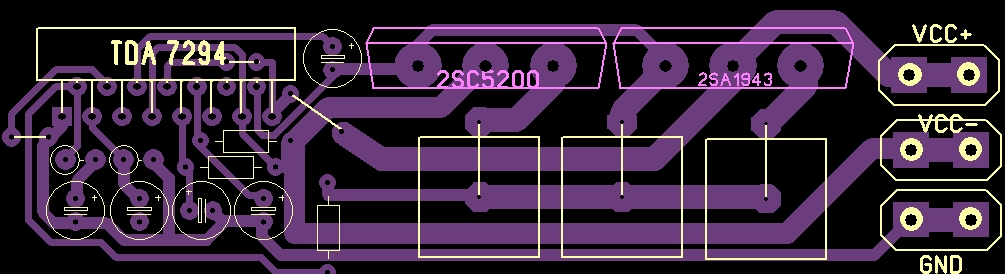

i think Mr. Andrewlebon pcb is missing input and output pads
yes just a quick pcb to check if schematic is ok i have tested amp on 2 ohms 4 15 inch speakers in parallel FULLY SATISFIED with performance of amp so i am designing stereo
pcb with 2 output pairs per channel so they can be bridged or used as stereo
warm regards
andrew lebon

well thats good! and by the way did not mention that your pcb looks very good to me, just noticed about those missing,and ; what power supply are you using?
mine is what is inthe pics, 25-0-25 ac xfrmer, single diode bridge, and 4x 4700uF, plus
2x 220uF at the chip as recomended by Mr Daniel W.Any plans for a final single transistor pair mono pcb?

Hello Dr frost
greetings just want to ask you if TDA7293 or TDA7294 which is better for bridging 2 channel with 2 output pairs each channel
warm regards
andrew lebon

EWorkshop1708:
Tweak away, if any improvements can be made that's good, i only got it working and spent 10 hours tweaking because im kind of a perfectionist, and would not post here if it did not work, lots of those designs out there, and this design (not mine by the way) i found some years ago, sounded awful and abandoned it, a year later i was looking again to build a new amp and decided to try this again to make a simple to build amp.
And yes no distortion no matter how much you mess up on the crossover components 🙂

andrewlebon;
Nice PCB and very glad you like the amp.
Don't know about the bridging, never had time to experiment more, have just been using this AMP non stop for 5 years or so.

Andrew,
You should consider using at least a two-sided board, with one side for ground plane.
Tom
Tom
andrewlebon now that really looks good 🙂, and can see your are opting for even more power using 2x Pairs, your amp should be stable in 2 OHM in bridge giving you one hell of alot of power
